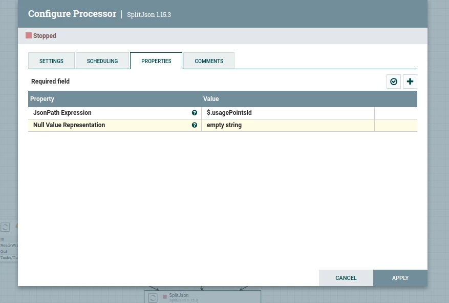

I tried to transform the usagePointsId String to an array of element using a jolt transformation :
"operation": "modify-overwrite-beta",
"spec": {
"usagePointsId": "=split(',',@(1,usagePointsId))"
output :
"usagePointsId" : [ "22516914714270", " 22516914714271", " 22516914714272" ]
Then i split this array with SplitJson on the usagePointsId path.

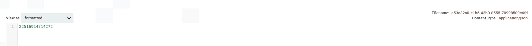

It results multiple files with a simple string in content :
How can i save that kind of data as Attributes ? I try to use EvaluateJsonPath but unfortunatly, there is no path to precise. Is there a way to handle that ?

I finally used a Jolt transformation on the last ouput content :
input :
22516914714270
jolt spec :
"operation": "shift",
"spec": {
"$": "usagePointsId"
ouput :
{"usagePointsId": "22516914714270"}
Then i used the EvaluateJsonPath to save the value as attributes
What a day 😅
