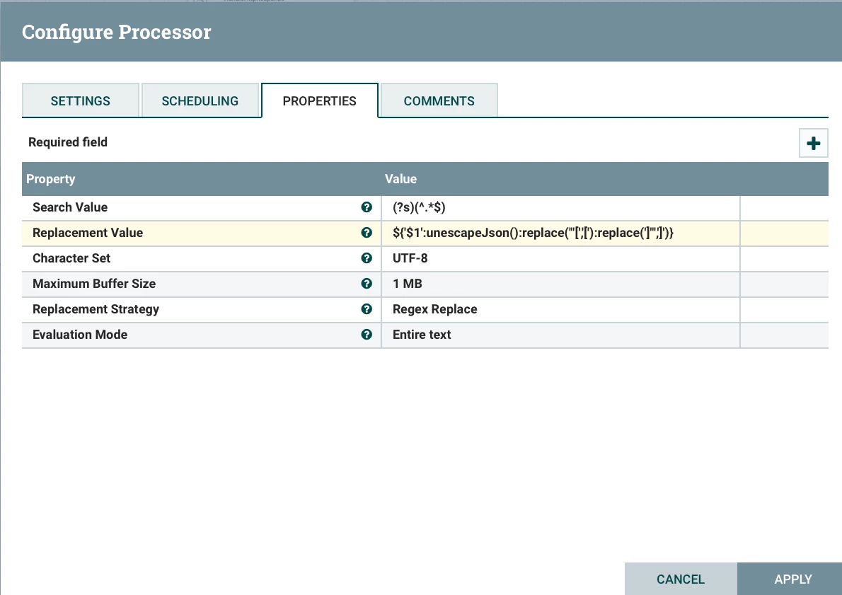

The processor translates the object as a string.  You will need to take some action on it to prepare it as you want it to be downstream.  Assuming you are working with content of FlowFile, the processor you need is ReplaceText and the syntax is:
${'$1':unescapeJson()}
To dial it even further so its not a string at all:
${'$1':unescapeJson():replace('"[','['):replace(']"',']')}
Here is same in the ReplaceText processor properties:
If you are operating on an attribute, you can do the similar action with UpdateAttribute:
${attributeName:unescapeJson()}

AV_1010
AV_1010Author
Silver ⭐️⭐️
Dec 30, 2019 1:51 PM UTC
Thank you, this worked perfectly!
