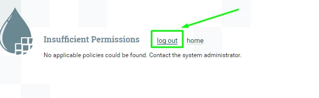

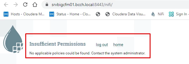

Hi Guys ,i have a problem with Nifi login   please can´t help me ?
this problem start when open the web interface of Nifi later config ldap login  .Present the next message
has been attached imagen .
for fix the problem -> select log out
is there any other solution ?
Regards!

The UI you are seeing is telling you that your ldap user credentials have successfully been authenticated; however, your user identity is not authorized within NiFi to "view the UI".
NiFi Access Policies
The ldap-provider configured in the login-identity-providers.xml handles the authentication process.
The configuration within the authorizers.xml handles the authorizing of those authenticated user identities.
You can tail the nifi-user.log  while you login to see that your user identity that is resulting from your successful authentication.  You will also then see the not authorized log output with the missing access policy.
The following section of the Apache Documentation can help setting up authorization for the first time:
multi-tenant-authorization
If you were to share the log lines from your nifi-user.log specific to your login attempt along with the contents of your authorizers.xml file, it may be easier to provide guidance on your setup.  The multi-tenant-authorization setup in the authorizers.xml has many configuration options and providers to choose from.  The very basic setup would use a managed-provider that uses the file-access-policy-provider and file-user-group-provider.

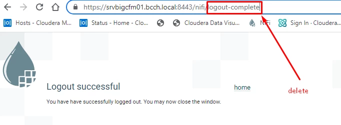

Matt , the next steps mitigate the problem , but not its solution

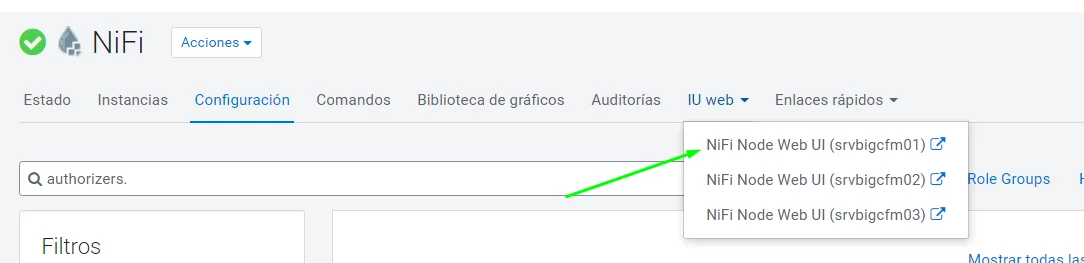

Step 1

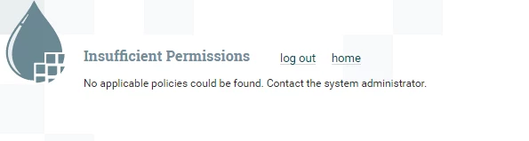

Step 2 show the problem

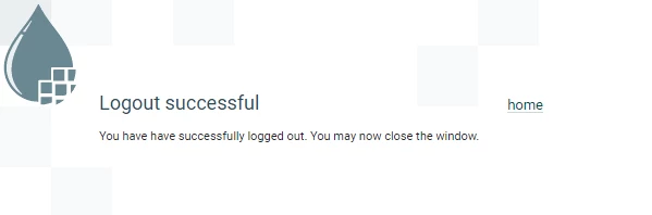

Step 3 Select" log out " option

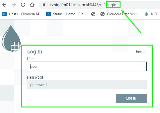

Step 4 : in the Url delete "logout-complete" and add "login"
Do you know why this behavior occurs?
Regards!

You need to create an initial admin account ,
Go to your authorizers.xml file and add your ldap username "cn=xxx,ou=xx,dc=xxx,dc=xxx" in the Initial Admin Identity property, it will create admin user and you will log on to NiFi as admin and create policies for other users

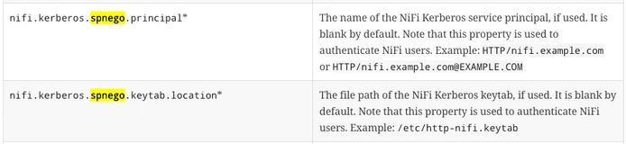

Spnego based authentication is enabled when the following properties have been configured in the nifi.properties file:
Make sure these two properties are clear to disable spnego auth challenge to your browser.
