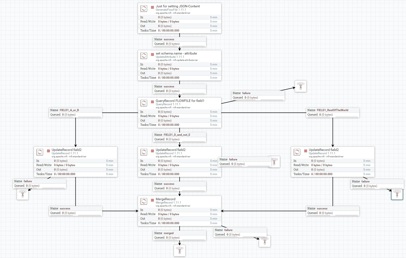

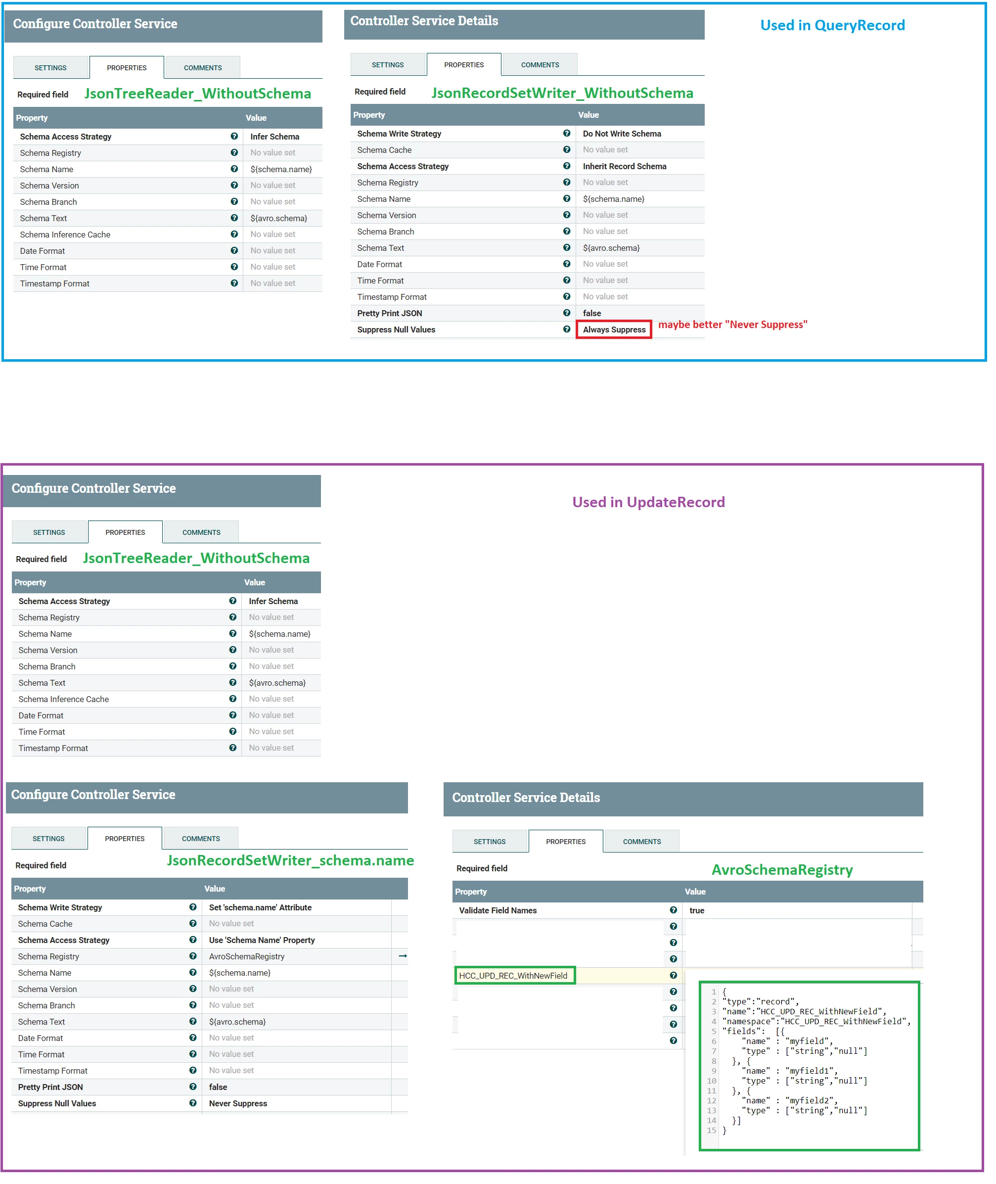

Sorry I couldn't work on this further last week. Now my solution looks like this.
  • JSON from GenerateFlowFile
"myfield": "JustForHavingJson",
"myfield1": "A"
"myfield1": "B"
"myfield1": "C"
"myfield1": "D"
"myfield1": "E"
"myfield1": "X"
"myfield1": ""

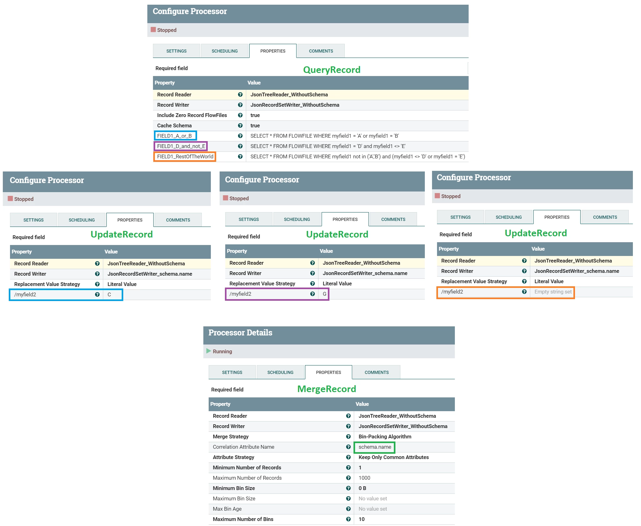

  • Definitions of ControllerServices and AvroSchemaRegistry
    ControllerServices and AvroSchemaRegistryControllerServices and AvroSchemaRegistry
  • Flow
    FlowFlow
  • Details of RecordProcessing-Processors
    Details RecordProcessing-ProcessorsDetails RecordProcessing-Processors
  • Result FF-Content after MergeRecord:
{"myfield":"JustForHavingJson","myfield1":"A","myfield2":"C"}
{"myfield":"JustForHavingJson","myfield1":"B","myfield2":"C"}
{"myfield":"JustForHavingJson","myfield1":"C","myfield2":""}
{"myfield":"JustForHavingJson","myfield1":"E","myfield2":""}
{"myfield":"JustForHavingJson","myfield1":"X","myfield2":""}
{"myfield":"JustForHavingJson","myfield1":"","myfield2":""}
{"myfield":"JustForHavingJson","myfield1":"D","myfield2":"G"}
Personally I wouldn't do a MergeRecord at the end but go on with the three single connections of the UpdateRecord processors.
Do you think this could be a possible solution or have you found a better way to do this?
9 replies

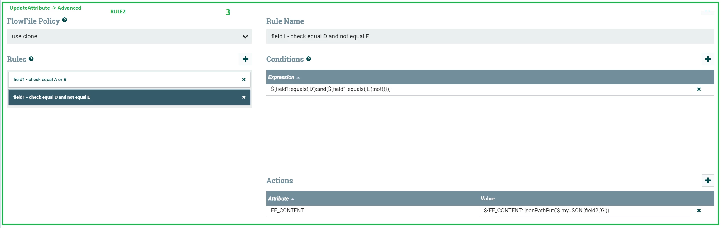

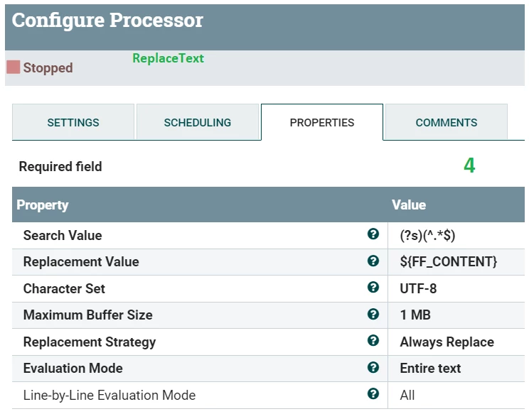

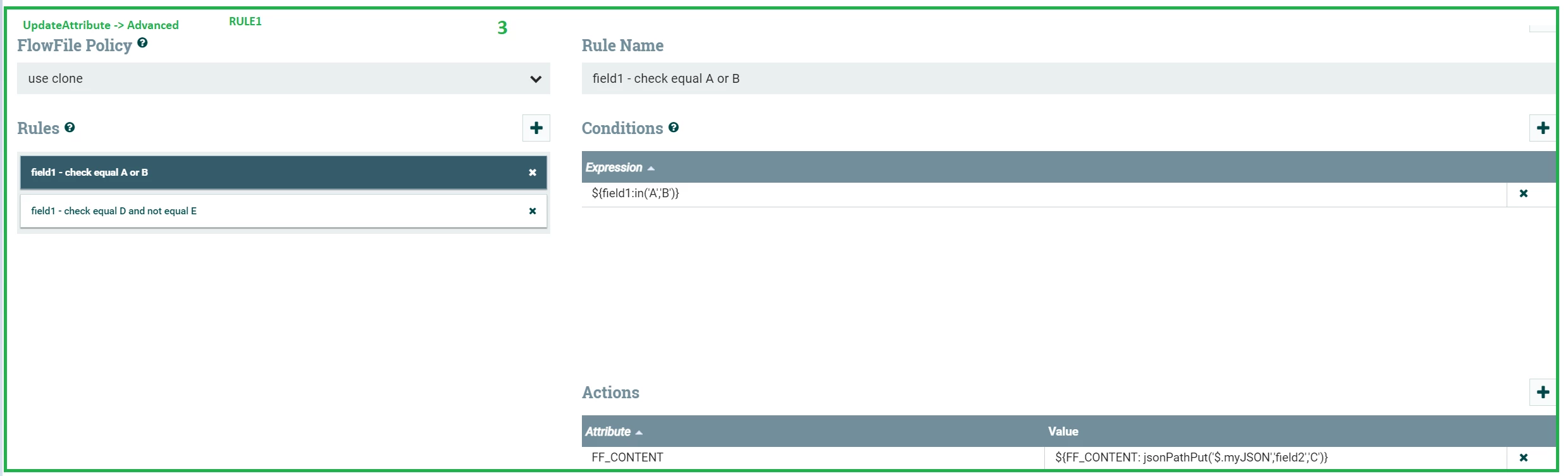

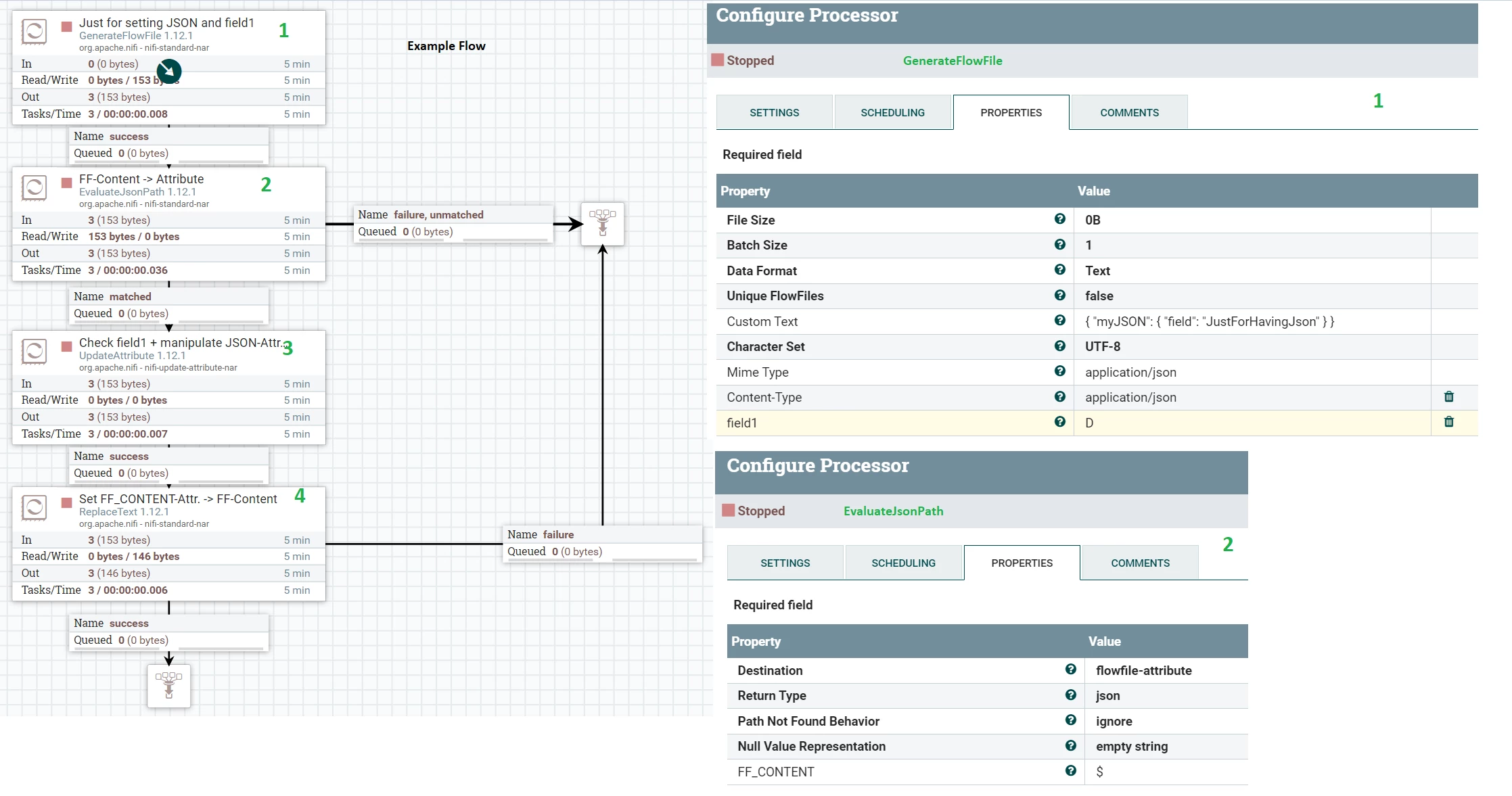

@stephane_davy Maybe you want to give this solution a try?
Hope the explanation is clear. If not feel free to ask again.

justenji
Gold ⭐️⭐️
Dec 3, 2020 11:01 AM UTC
@stephane_davy   Sorry, my above picture is a kind of vision test...
Flow and Step1 and 2Flow and Step1 and 2
Step 3 Rule 1Step 3 Rule 1Step 3 Rule 2Step 3 Rule 2Step 4Step 4
Translate
stephane_davy
Gold ⭐️
Dec 7, 2020 4:37 PM UTC
Hello @justenji
Thanks for you reply. The problem here is that you are working with attributes and expression language, which would mean to have one flowfile per json object. I'm trying to have a record-oriented flow-file, which means that everything happens with recordpath and / or Jolt transformations. My flow file have multiple JSON records and as such attributes would take multiple values. And I don't want to split my records, this is really resource consuming.
