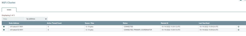

Hello Guys,
We have 3 node NiFi cluster and the NiFi version is 1.12.1
nifi-hatest-01
nifi-hatest-02
nifi-hatest-03
All the 3 nodes are in cluster, but not in UI.
In all the 3 NiFi nodes, we see this 2 nodes in cluster mode:
Now, as we see nifi-hatest-02 is the primary and cooridantor. And nifi-hatest-03 is not being shown here.
In nifi-hatest-01, we see nifi-hatest-01 is connecting to nifi-hatest-02
2022-01-19 16:02:09,840 INFO [Clustering Tasks Thread-1] o.a.n.c.c.ClusterProtocolHeartbeater Heartbeat created at 2022-01-19 16:02:09,820 and sent to nifi-hatest-02:9088 at 2022-01-19 16:02:09,840; send took 20 millis
In nifi-hatest-03, we see nifi-hatest-03 is also connecting to nifi-hatest-02
In nifi-hatest-02, we see nifi-hatest-02 is also connecting to all the 3 nodes as its coordinator:
2022-01-19 16:04:52,573 INFO [Process Cluster Protocol Request-30] o.a.n.c.p.impl.SocketProtocolListener Finished processing request 35f2ed1a-ca6f-4cc6-ab4a-6c0774fc9c6d (type=HEARTBEAT, length=2837 bytes) from nifi-hatest-03:9091 in 19 millis
2022-01-19 16:04:52,782 INFO [Process Cluster Protocol Request-31] o.a.n.c.p.impl.SocketProtocolListener Finished processing request 73d477cd-a936-4541-a854-03712cbc5fe9 (type=HEARTBEAT, length=2836 bytes) from nifi-hatest-02:9091 in 18 millis
2022-01-19 16:04:52,782 INFO [Clustering Tasks Thread-3] o.a.n.c.c.ClusterProtocolHeartbeater Heartbeat created at 2022-01-19 16:04:52,762 and sent to nifi-hatest-02:9088 at 2022-01-19 16:04:52,782; send took 19 millis
2022-01-19 16:04:53,916 INFO [Process Cluster Protocol Request-32] o.a.n.c.p.impl.SocketProtocolListener Finished processing request 4fbc39d9-5154-4841-b3be-ddde58b22cd2 (type=HEARTBEAT, length=2836 bytes) from nifi-hatest-01:9091 in 19 millis
No errors regarding cluster in either of nodes. But still see 2 nodes only in UI.
Also Cluster is using zk as cluster state provider.
Another thing is that when we create a processor in any of the NiFi UI, it gets propagated to other nodes too! So functionality its kind of working.
