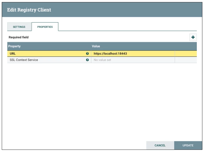

Within NiFi you have setup your "Registry Client" that looks like this:
For secure (HTTPS) NiFi-Registry URL, when an SSL Context Service is not defined, the default keystore and truststore configured in the NiFi.properties file is used to authenticate with NiFi-Registry through a mutual TLS exchange.
1. Did you setup an SSL Context Service?
2. If so, what keystore and truststore did you configure in the service?
3. Does the truststore used in the nifi-registry.properties file contain the necessary public certificates to include the complete trustchain for your NiFi keystore ClientAuth certificates?
From the log snippet shared, it looks like the mutual TLS exchange is not resulting in a trusted clientAuth certificate being passed in the exchange (commonly a trust chain issue). So NiFi-Registry then checks for token in connection which would not exist in a NiFi to NiFi-Registry connection.  So what ends up happening is the connection is established as anonymous (just like you as a user sees when accessing NiFi before clicking login button).
