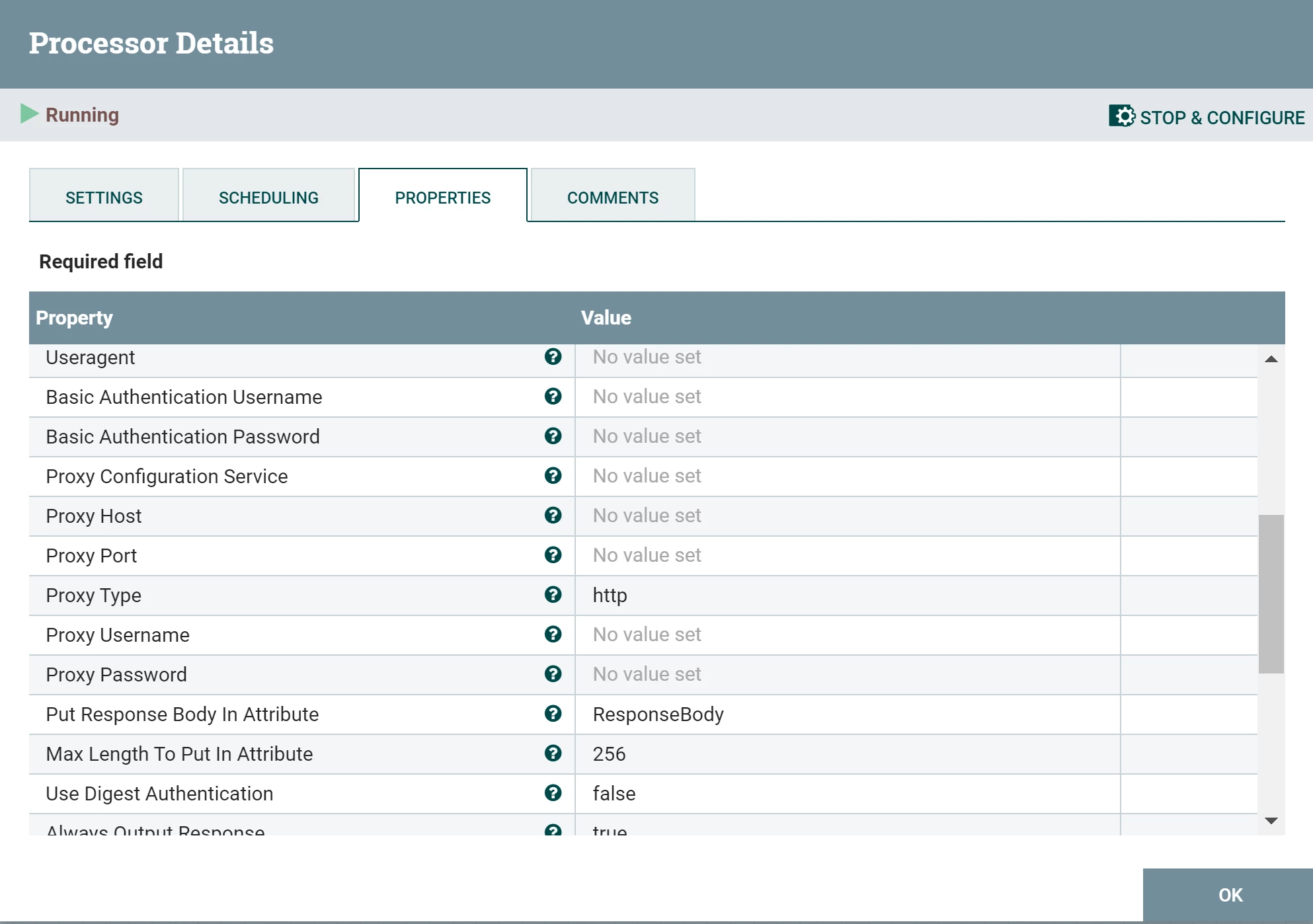

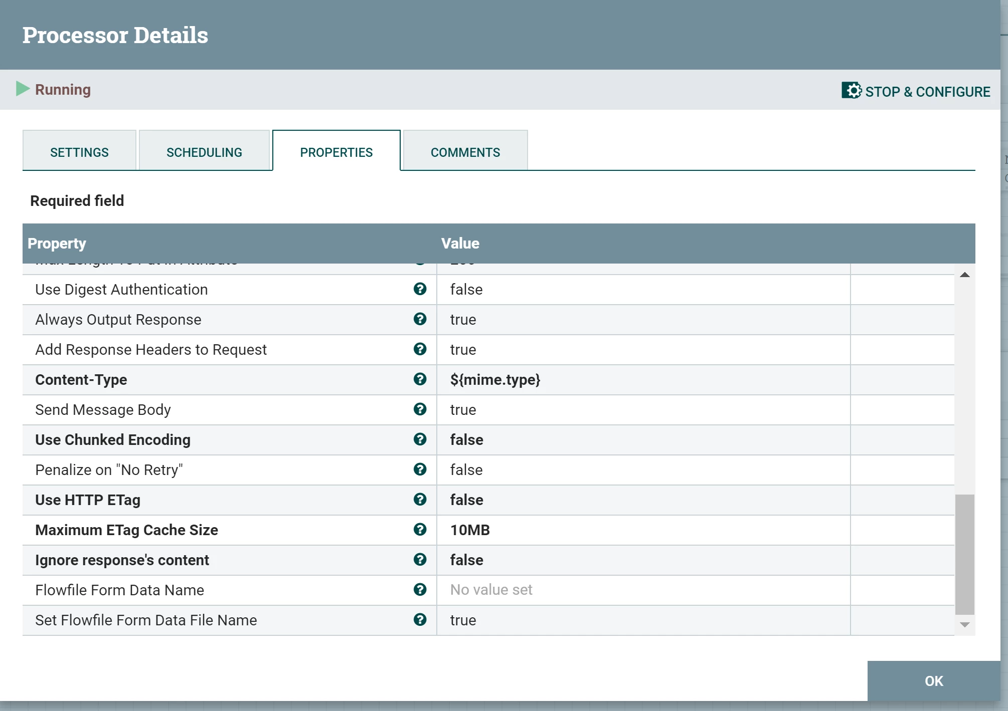

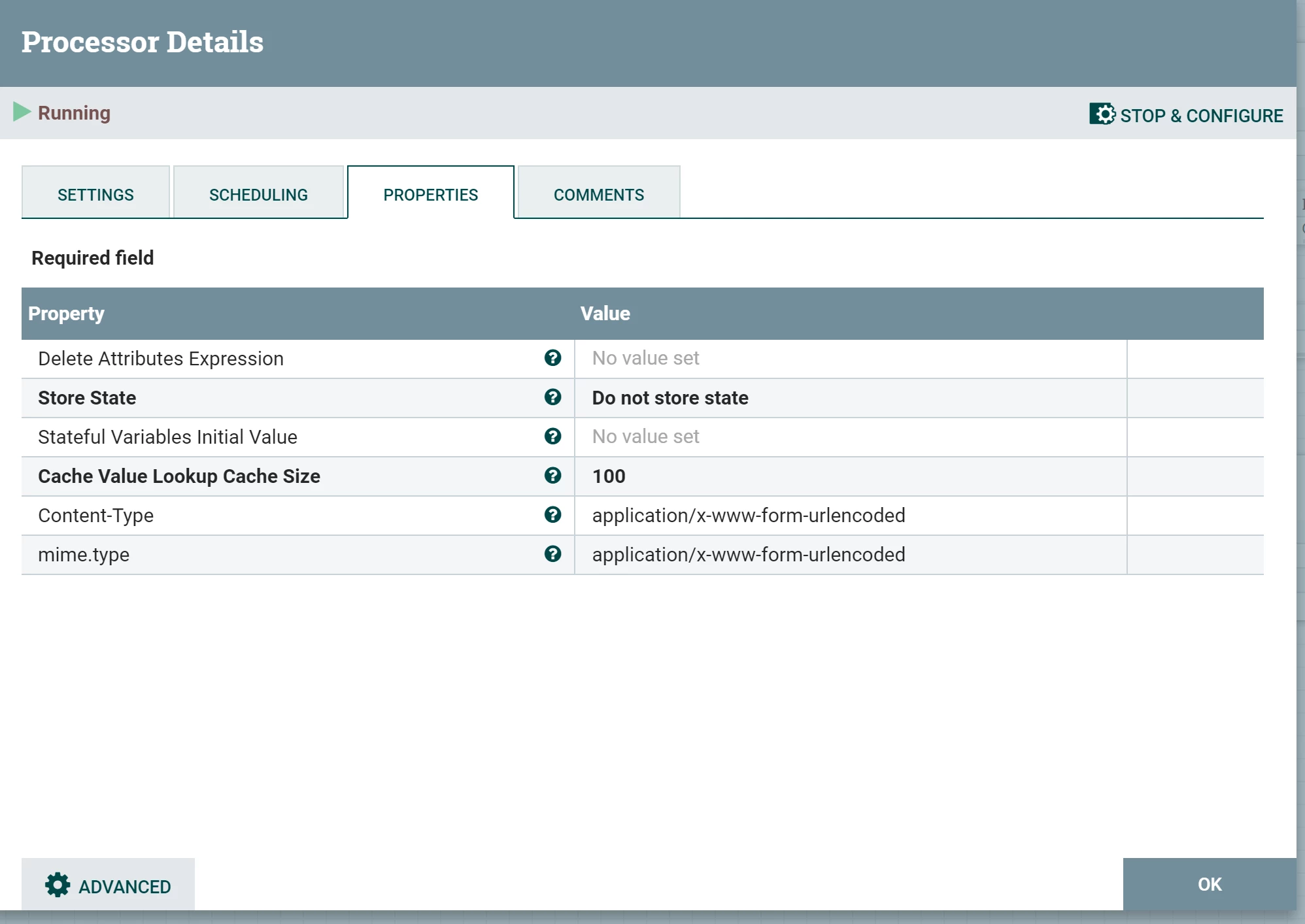

Hi ,

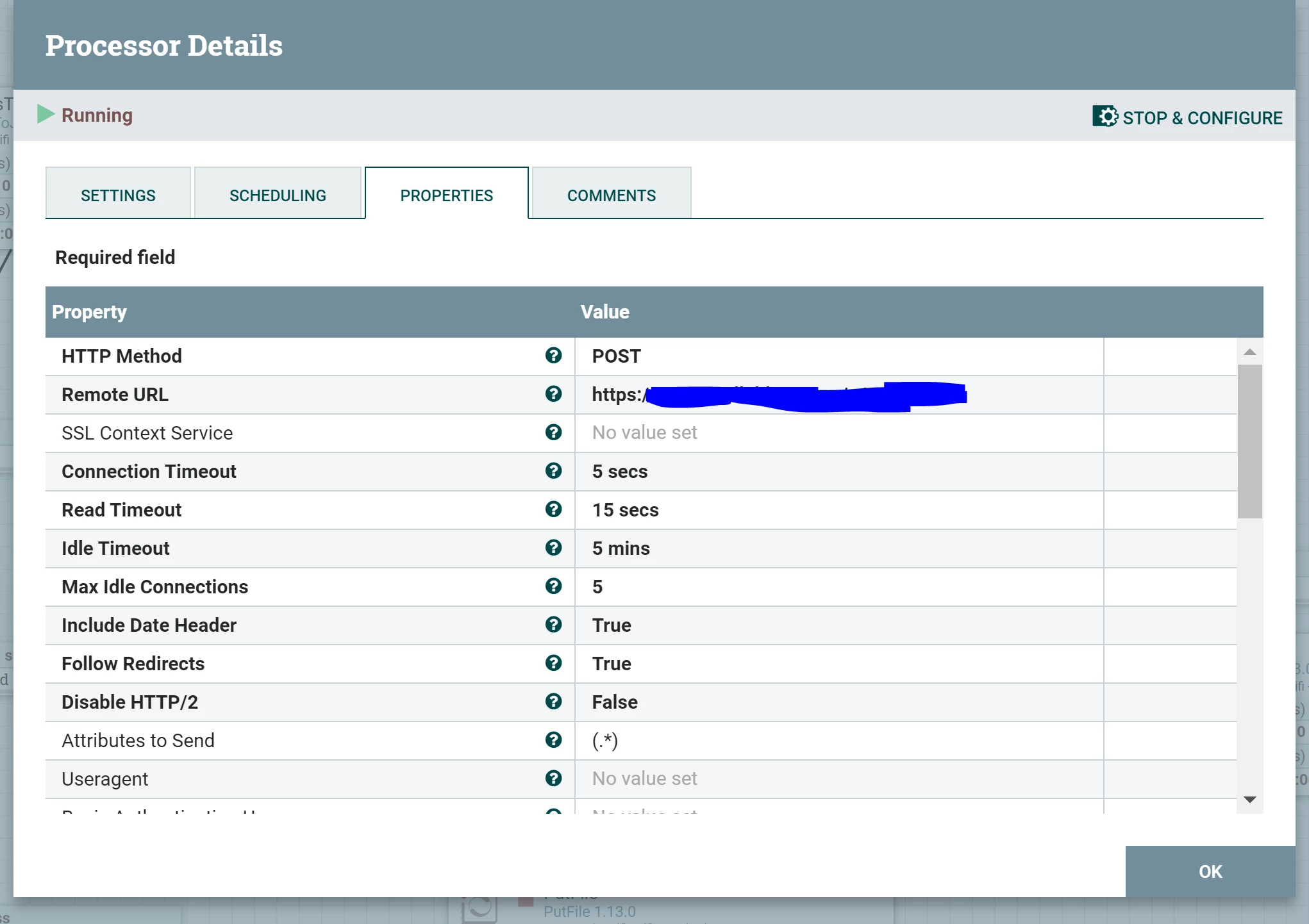

I have created 2 flows -
1] in this flow i have used GenerateFlowFile->UpdateAttribute->InvokeHttp
GenerateFlowFile config-
Dataformat = text
CustomText = Science is magic$$@@ i love Data ##
UpdateAttribute config -
mime.type = application/x-www-form-urlencoded

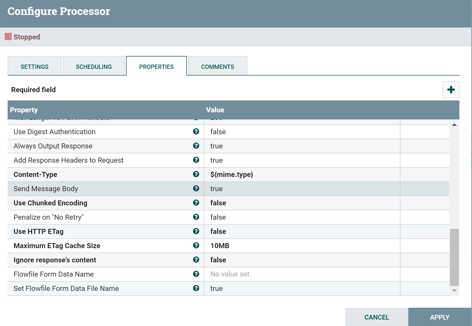

InvokeHttp config -
HTTP method = POST

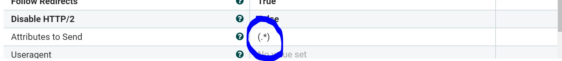

SourabhStreamin_1-1617292918055.pngSourabhStreamin_2-1617294318773.pngSourabhStreamin_3-1617294579634.png
and this works super fine .

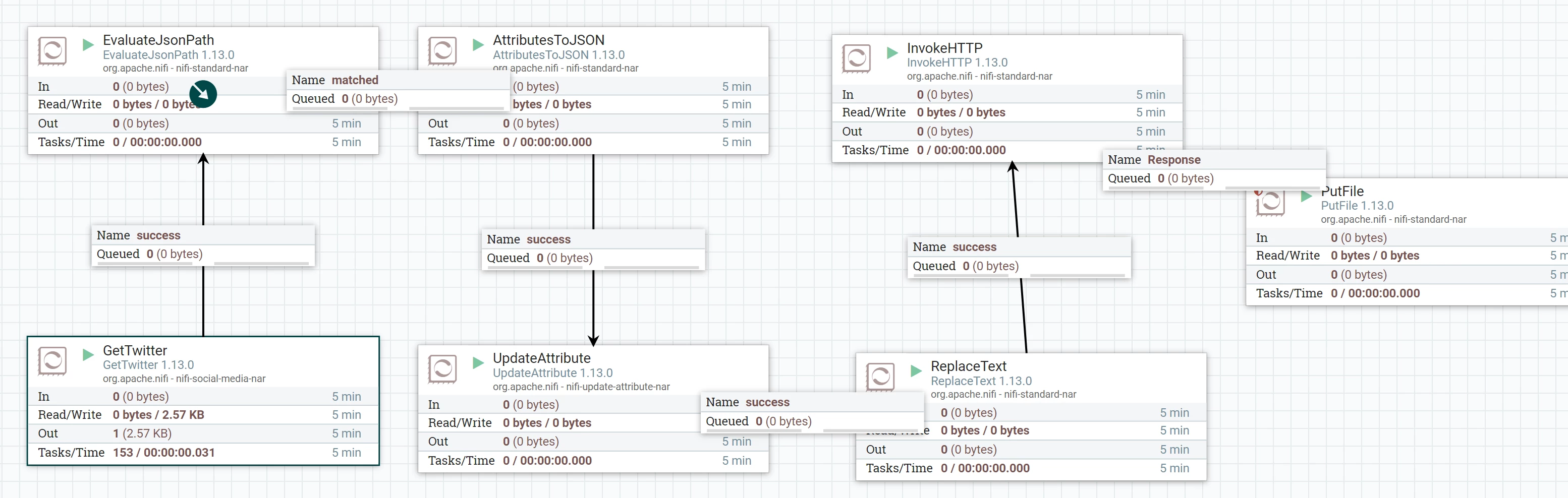

But when i use this with gettwitter it fails as shown in below -

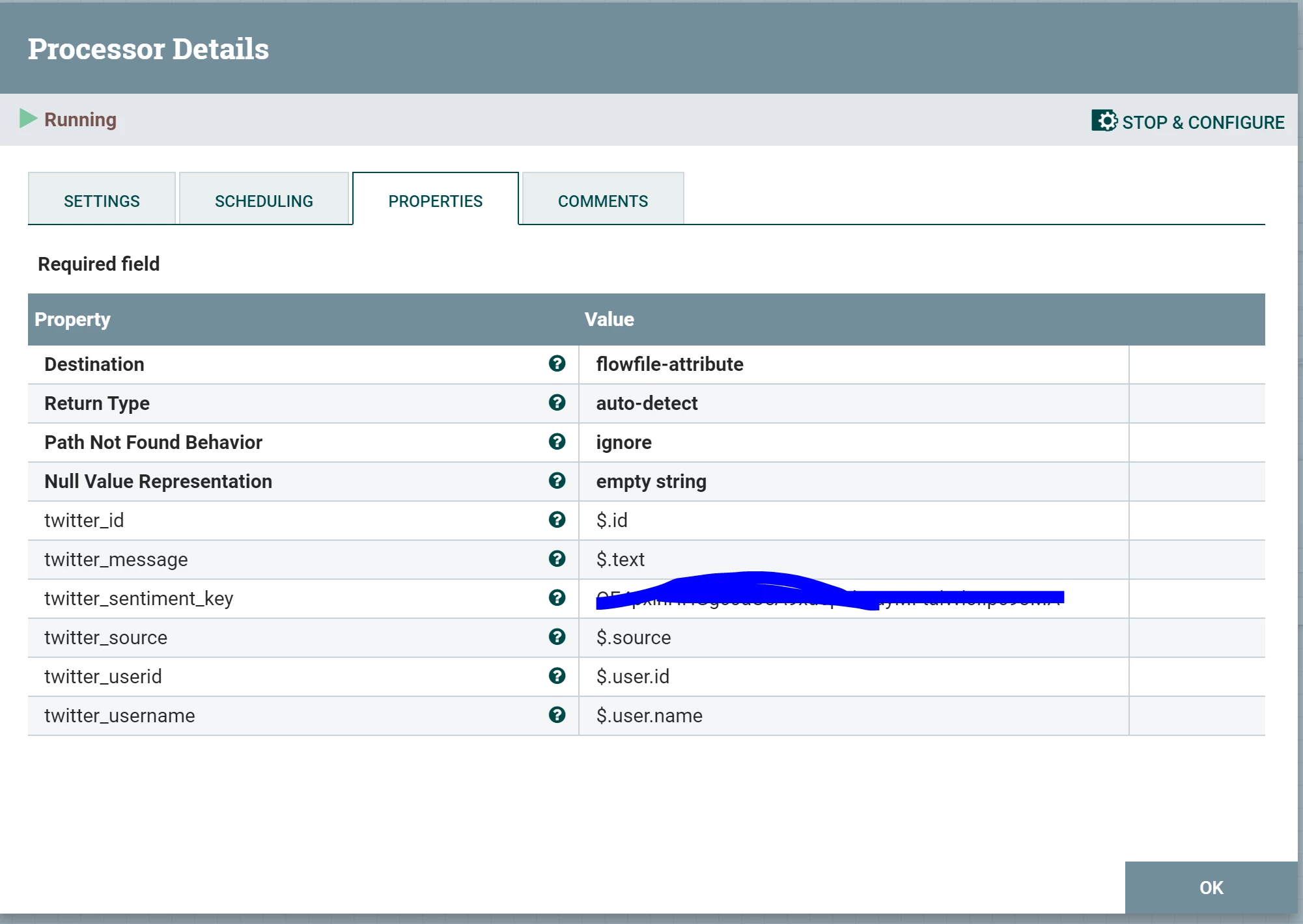

1] GetTwitter is working fine -
2] EvaluateJsonPath -

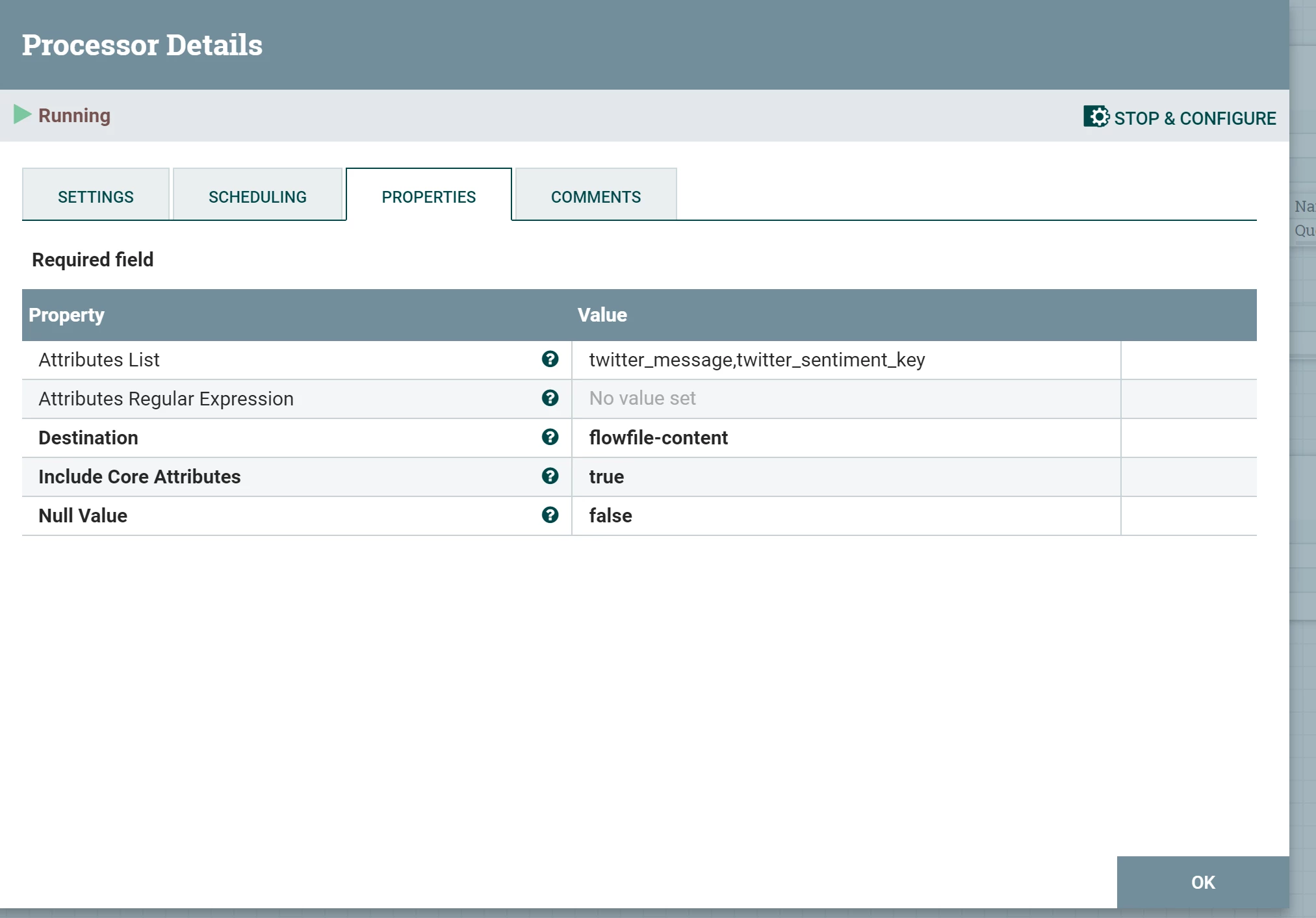

3] AttributeTOJson-
4] UpdateAttribute-

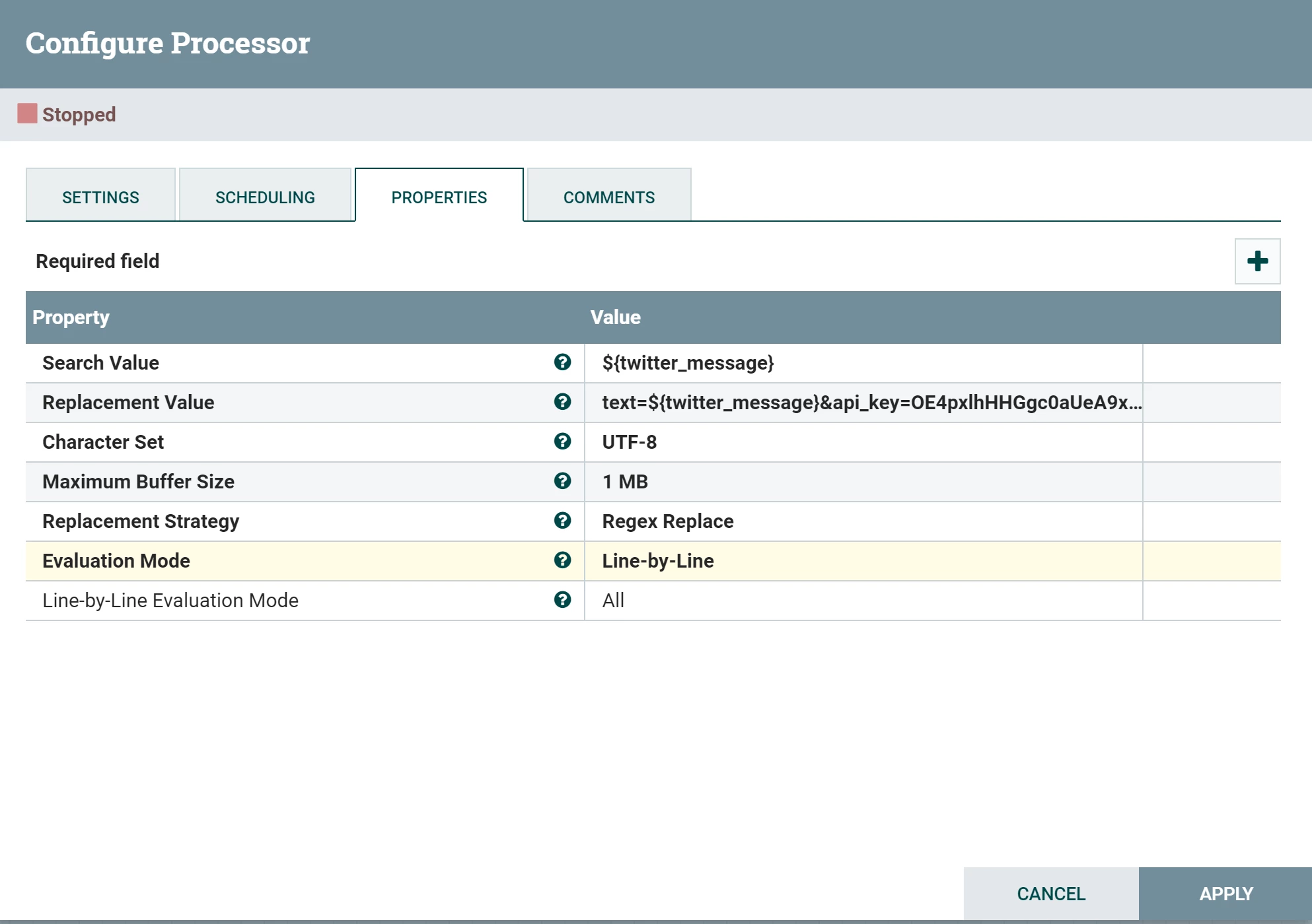

5] ReplaceText -

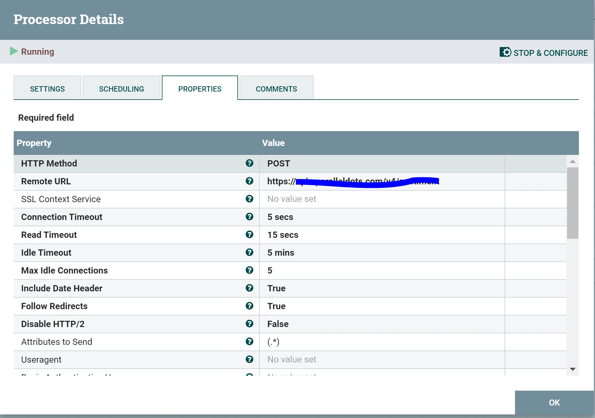

6] InvokeHTTP -

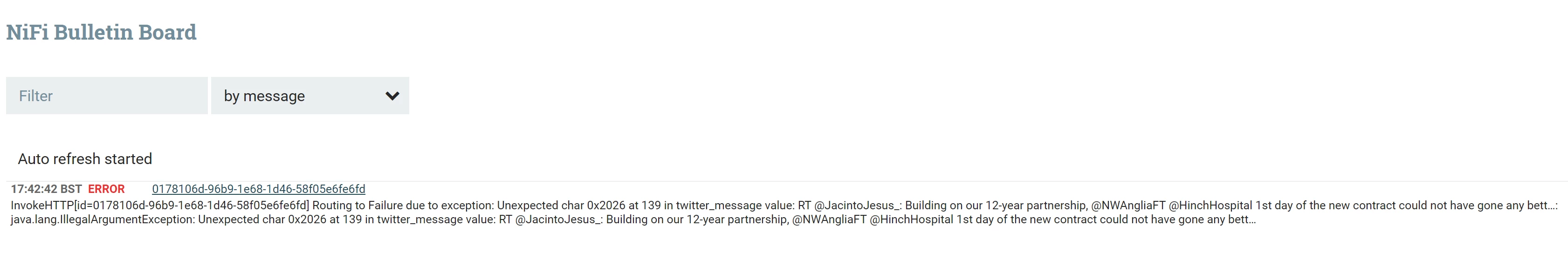

this is the error i am getting -

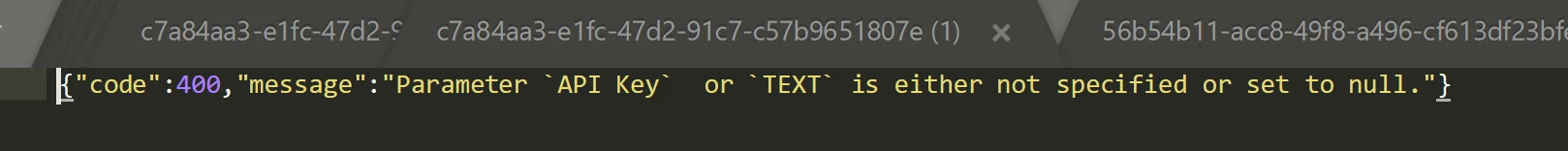

but if i set empty text at this from invokehttp processor -
then this error goes away but the api responds with missing api_key and text -

Hello,

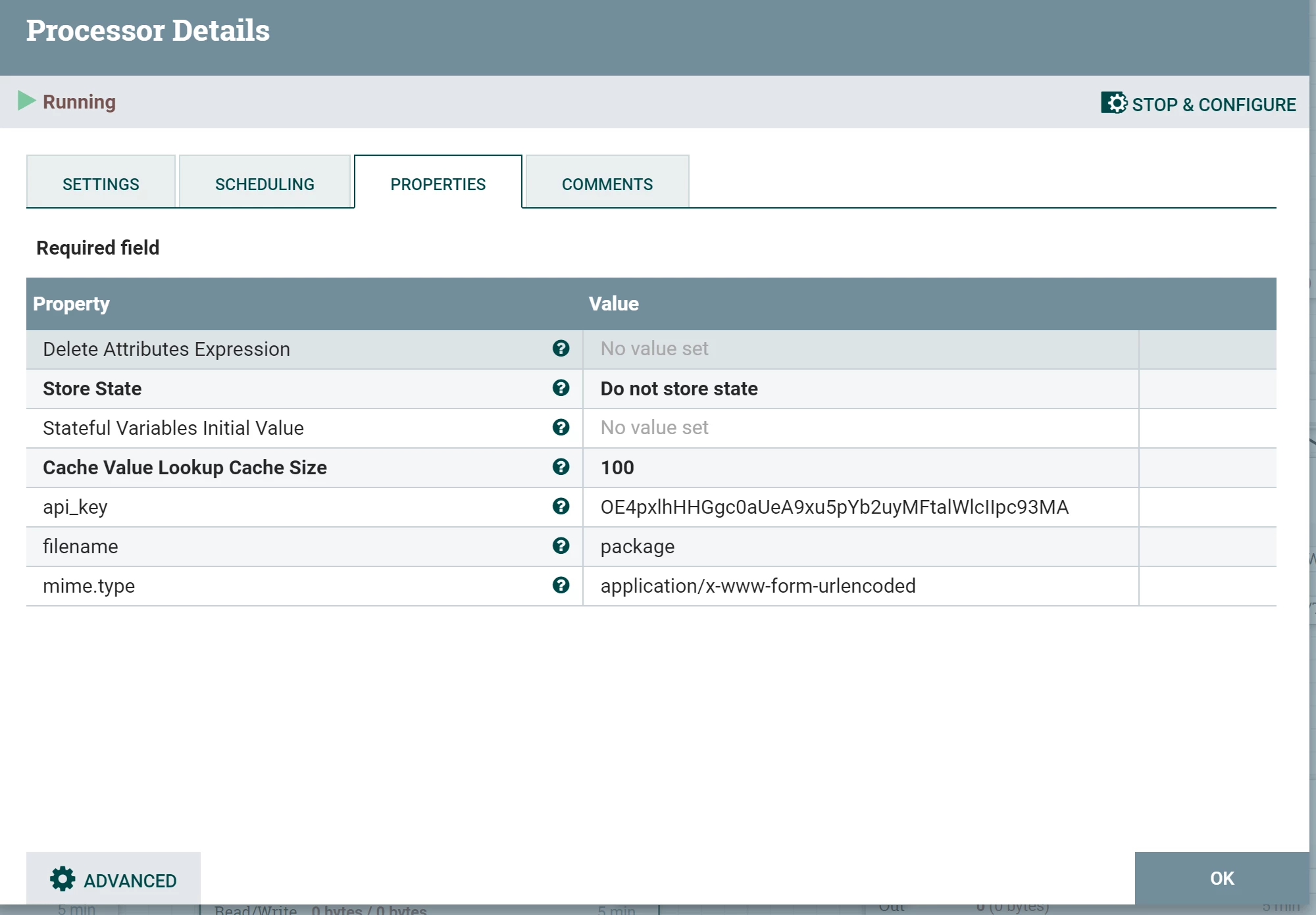

I got this resolved, the issue was with respect to the format of flowfile being forwarded to the invokehttp proessor. in order to send post body in form type it is necessary that you convert the format of the flowfile as just file, eg , if the flowfile is "package.json" we need to convert that into just "package". from above issue i kept everything same except i just added on attribute in updateattribute processor as shown in below pic -
