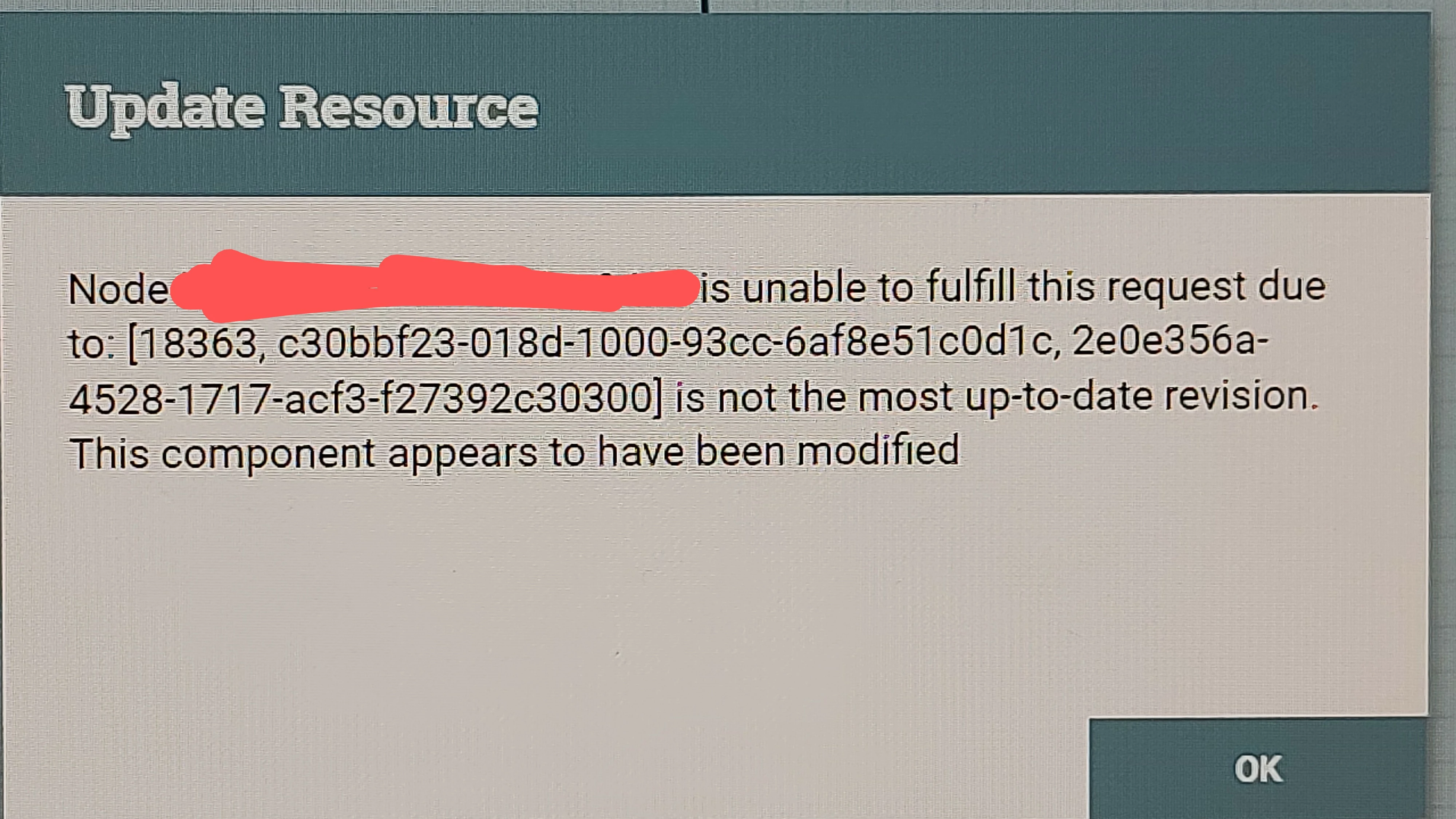

I'm having a 6 node on prem nifi cluster which has certain process groups. It had a node disconnect once and got auto connected back. Post this I tried to stop/disable a process group which was in started state in the UI, but it threw me an error stating -
Node xxx is unable to fulfill this request due to : [xxxx, xxxxxxxxxxx, xxxxxxxxxxxxx] is not the most up-to-date revision. This component appears to have been modified.
Although I didn't modified any component in the past, only a node disconnect and auto connect was the event which happened in between.
As per my previous experiences, I had to restart whole nifi from Cloudera Manager UI and then restart the flows which would resolve the problem which I stated above. But I was looking for an alternate solution other than restarting whole NiFi from CM UI as this is my production cluster and I can't get downtime so easily.
Any help would be highly appreciated.
--Adding the snapshot of the error below which i got while stopping/disabling the process group from NiFi UI post a node disconnect and auto connect happened.

You could rename the flow.xml.gz and flow.json.gz (present only if new enough version of CFM) and restart the node.  The node will inherit the flow from the cluster nodes when it tries to join the cluster.
Depending on how old your CFM version is, you could be hitting one of these bugs:
https://issues.apache.org/jira/browse/NIFI-7920
https://issues.apache.org/jira/browse/NIFI-8204
