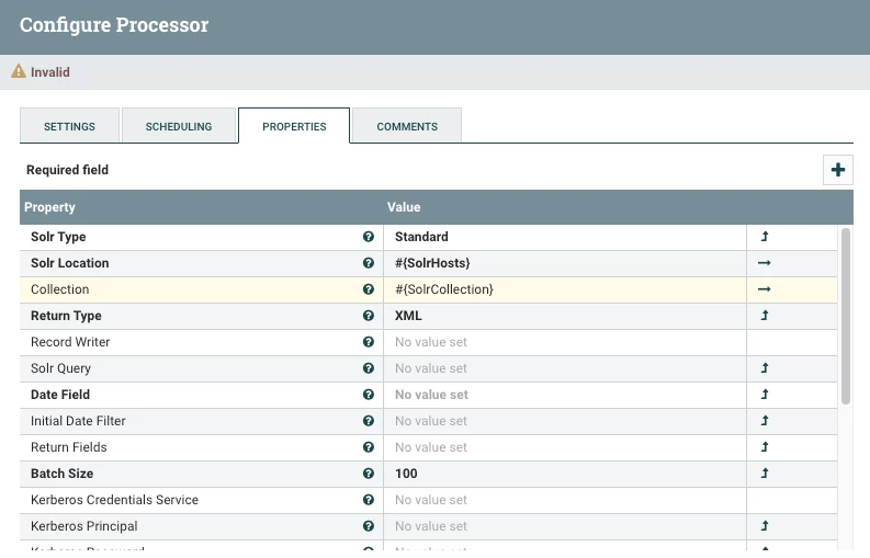

  • What is the best way to provide site-specific configuration for the controllers/Processors?  <--- The recommended approach is to use Parameter contexts [1].  NiFi Parameters can be used in component properties that do not support NiFi Expression Language (EL).
    • Should we have a unique properties file for each site and we select which one to deploy per site?  <--- You would typically create a unique parameter context per each site (same parameter strings with unique values per site)
    • Is there a way in the controllers/Processors to provide conditional values based on deployed site?  <-- I am not clear on the ask in this question.
      • Of particular concern is our Solr "Zookeeper Host List"
        • This is a property value on our Query and Ingest processors, and they currently aren't enabled to support the Variable Registry, so the value is explicitly provided (no variable lookup/replacement).  <--- All properties support NiFi Parameters, so you convert these property's values into parameters.

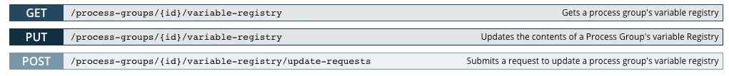

        • Is there a way to import a set of variables or do we have to define the variables via the UI?  <-- Anything you can do via the UI, you can do via NiFi's rest-api [2] as well.

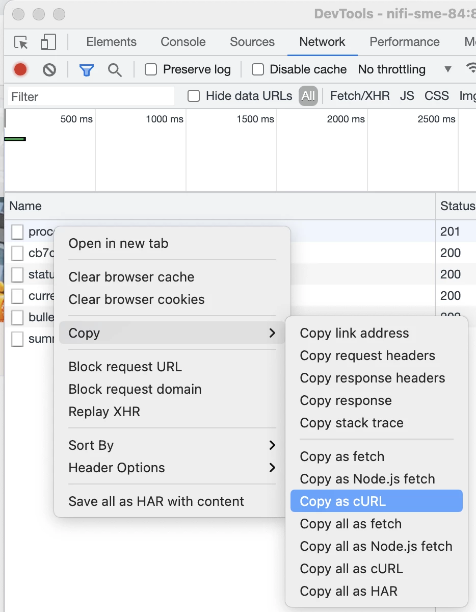

One of the easiest ways when getting started with the NiFi rest-api is to make use of the developer tools in your browser.  With developer tools open you can perform the actions via the UI and observe the rest-api requests that are used.  Most developer tools even allow you to copy that request as a curl command which you could simply execute from a terminal window to produce same outcome:
Automation would utilize a combination of NiFi CLI toolkit and NiFi Rest-api commands.   Keep in mind that when you import a new flow version to another registry, NiFi will not know about it right away.  NiFi checks NiFi-Registry for changes via a background thread.

1. Any property can utilize parameters (even those that do not support NiFi Expression Language
2. Once you create a parameter context and it is associated with a Process Group, you can easily convert existing component property values into parameters using the "convert to parameter" to the right of the property,
3. On the other NiFi site, you would not need to modify the processor properties.  Simply associate a site specific parameter context to the PG that contains all the same parameters just with site specific values.
4. Even component password property values (sensitive encrypted properties) can be converted in to parameters.
