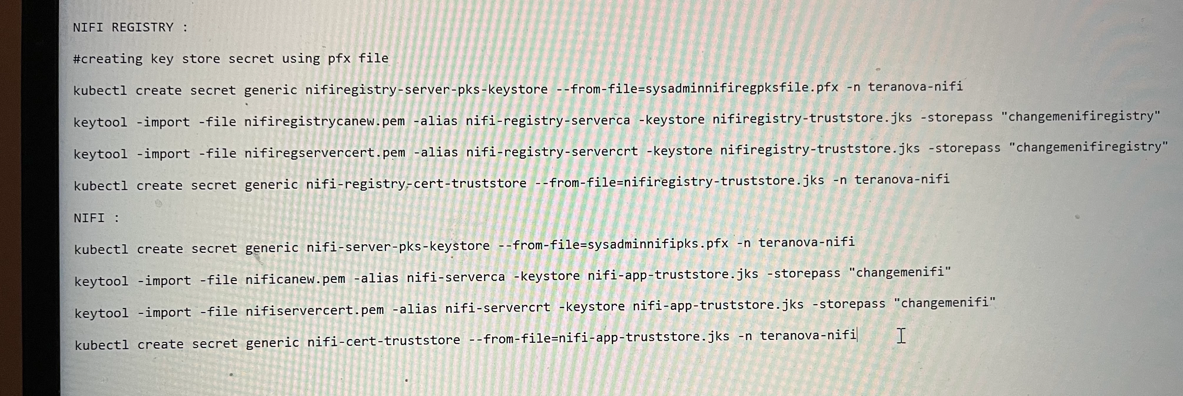

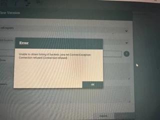

now I have apache secured nifi and secured nifi registry running on local host. When I try to integrate with nifi with nifi registry it’s giving me connection refused.  I added the images how I created certificates and the error.  I added trust and key store files in nifi registry and nifi properties. I want to make 2 way ssl connection.

@Knowledgeknow
I would think that certs created by tiny cert should be fine.
Troubleshooting mutual TLS handshake this is difficult without the verbose keytool output for the NiFi keystore and truststore and the NiFi-Registry keystore and truststore.
Your first screenshot with connection refused, you'll probably want to look at the nifi-registry-app.log at time you opened that UI to see what may have been logged.
Can the NiFi host resolve and reach the configured Apache NiFi-Registry host?  Can this be done via the NiFi service user via command line on the NiFi host?
Once you get past any potential MutualTLS issue, we would need to inspect the configurations you have in place within:
