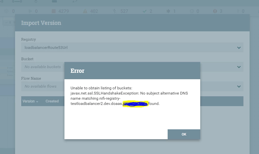

I have configured the nifi registry with an aws load balancer
I have configured both type of load balancer (application(https)/ tcp) but none of them accessible from nifi nodes and not listing the buckets list.
Below are the errors I am getting:
with AWS network type load balancer:

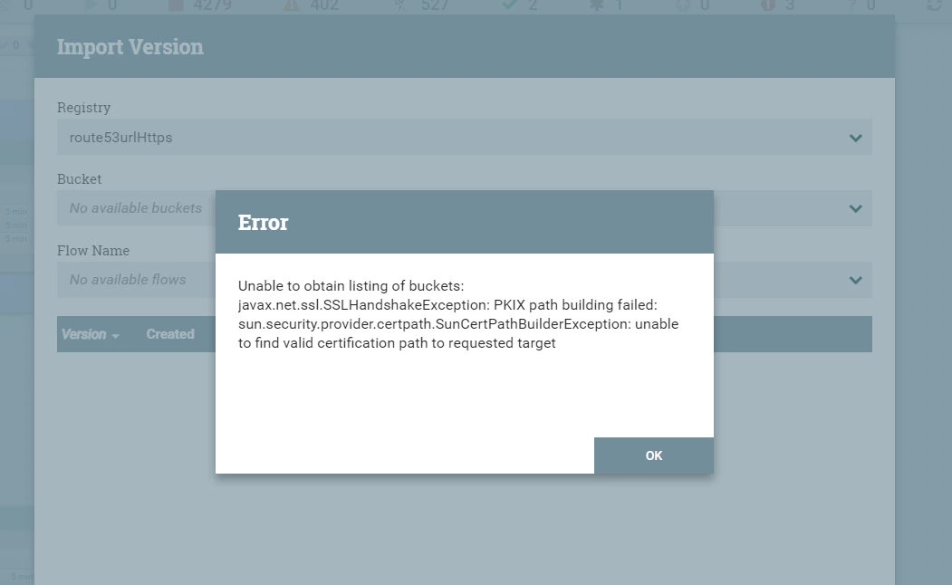

with application (https) load balancer:

Your issue in both exceptions is with the mutual TLS handshake and not really a configuration issue in NiFi or NiFi-Registry. And may not even be an issue with your LBs.
Your first exception shared is telling you that the Registry-Client hostname configured in your NiFi was not found as a SAN in the serverAuth certificate returned by the target server.  In order for the mutual TLS handshake to succeed there would need to be a matching hostname SAN entry in the certificate.
The Second exception you shared is telling you that the truststore.jks does not contain the required complete trust chain needed to trust the private certificates DN. The privateKey used by the Server and Client will have an owner DN and Issuer DN.  The Issuer DN is the authority that signed that certificate and must be found in the truststore.  Some issuers are intermediate authorities meaning that also have an owner DN signed by another issuer authority.  This is a trust chain.  So your truststore would also need to to contain the trustedCertEntry for that intermediate's issuer as well. Once you reach the issuers certificate where both the owner an issuer DN match, you have reached the root authority of that trust chain.
This is all part of the TLS spec and not specific to anything NiFi is enforcing itself.
you can use openssl in most but not all to get the public certs for the authorities:
openssl s_client -connect <hostname>:<port> -showcerts

The HTTPS LB exception could be resolved by making sure the TrustedCertEntry(s) for the complete trust chain for the HTTPS LB's privateKey are present in the NiFi-Registry's truststore.jks.  You should also add the trustedcertEntry for the NiFi CA you appeared to be using to the truststore used by your HTTPS LB.
