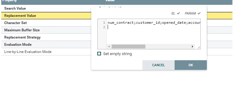

Hi,

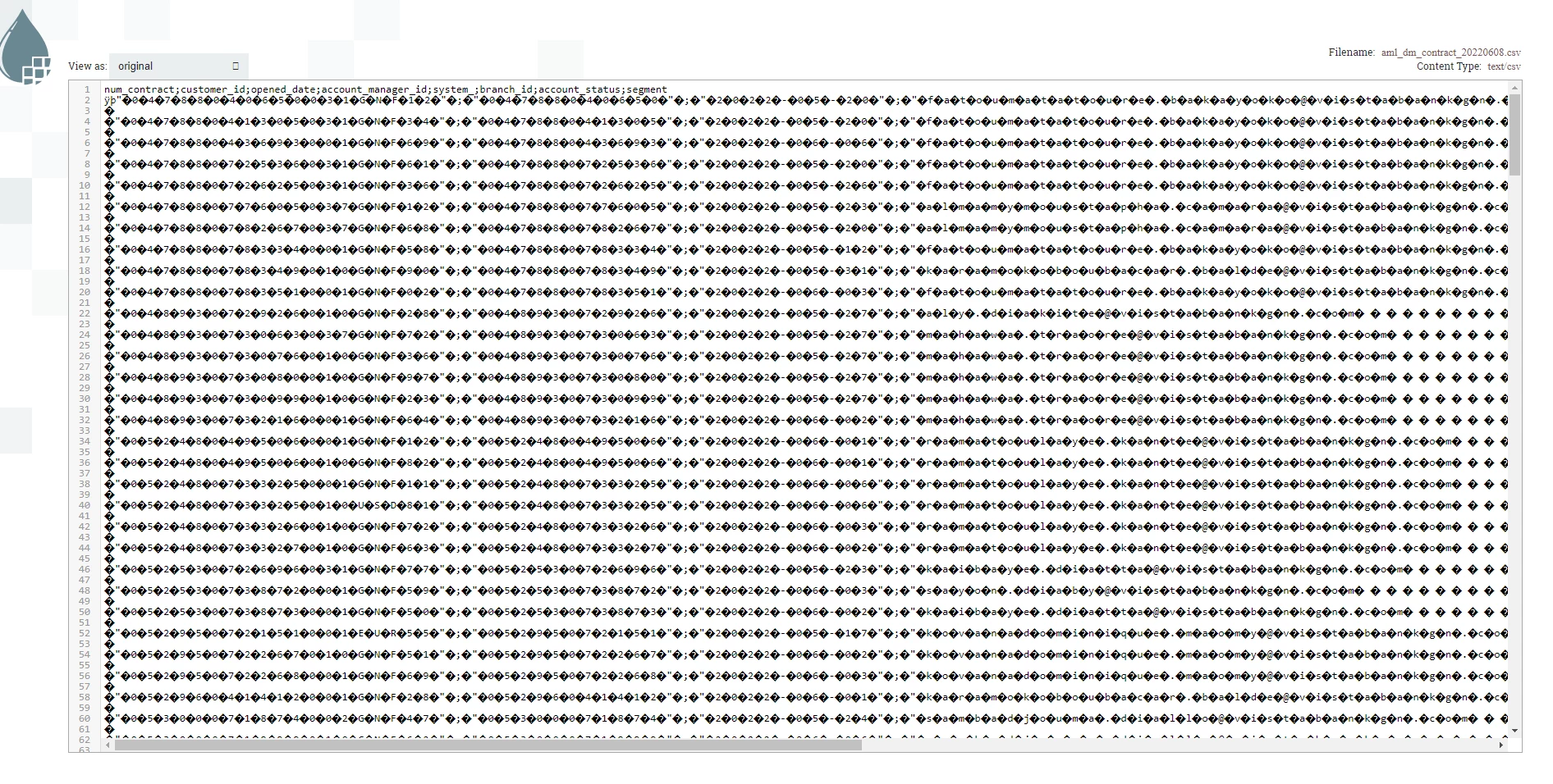

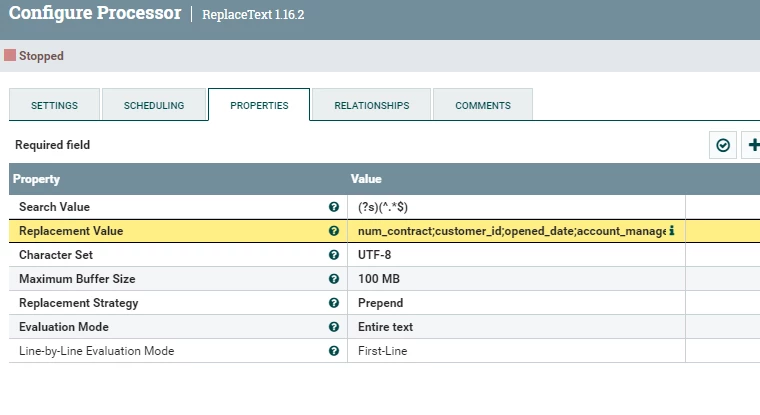

I am getting a csv without a header then adding a header with ReplaceText to it after the ReplaceText the header is added but the rest is crashed.
PS: This problem happen with this file only I tried the flow with other csv files and worked fine, can this be a csvReader problem or configuration on the encoding ?

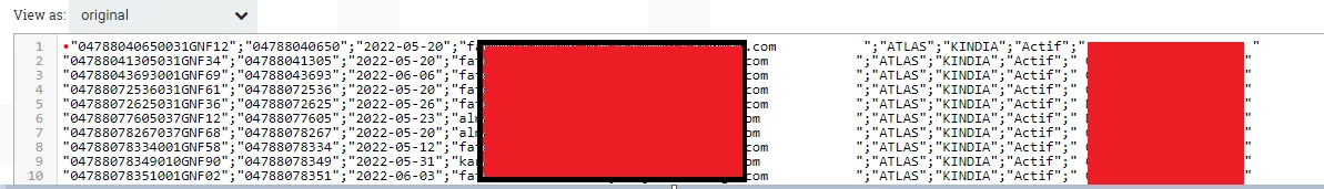

Before :
The replace :

Hi,
It could be an encoding issue that I faced a while back. please check out this post:
https://community.cloudera.com/t5/Support-Questions/Illegal-Arg-Exception-when-parsing-CSV-file-though-the-split/td-p/300565
Try to change the character set to UTF-16 to see if that will work. Hope that helps.

FediMannoubi
Gold ⭐️
Jun 15, 2022 3:07 PM UTC
I used ConvertCharacterSet and changed the oncoding from UTF-16 to UTF-8 and that fixed for me Thanks
