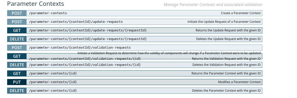

Hi,
I noticed that in NiFi rest api documentation for version 1.9.0 the parameter context endpoints have been removed, even though they existed in version 1.15.2

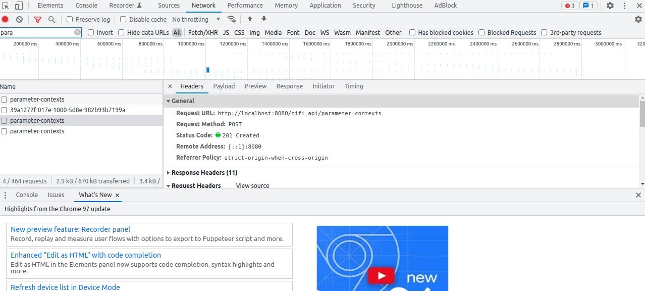

Furthermore, I am using NiFi version 1.13.2 and I can see that in my browser's debugging tools, in the network tab, whenever I create a parameter context, a post request is sent to
and the following payload is being sent :
"component": {
"name": "aaaaaaaaaaa",
"description": "aaaaaaaaaaaaaaaa",
"parameters": []
"revision": {
"clientId": "3d3697c2-017e-1000-0610-31b28073cf9b",
"version": 0
The parameter context is successfully created. However when I attempt to send a post request from an external API or even hit the previously mentioned endpoint through the browser using the same payload, I get:
HTTP 405 Method Not Allowed

I figured it out. It had to do with me not serialising the data to json properly before passing it as json and also I should have used the following for the header:
headers={"Content-type": "application/json", "Accept": "application/json"}
Also, this means, that even though the parameter context endpoints are not listed in version 1.9.0., they are still available.
