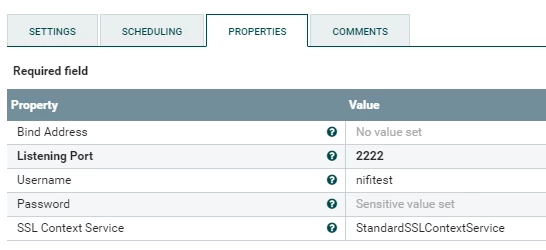

For now, just to test, I have this (nifi 1.15.3):

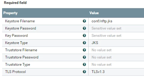

And the SSL Context:
Where my jks was generated using (with testing values)
keytool -genkey -alias nifi-ftps -keyalg RSA -keypass MyKeyPass312 -storepass MyStorePass312 -keystore nftp.jks

Have you tested ListenFTP without setting SSLContextService? just to make sure supplied username and password is correct?

@ckumar yes I have - the username and passwords are correct.

@Tokolosk I would recommend that you provide java's cacerts as the keystore/truststore with the default password (changeit).  This will work for most public certs.    If you have a custom cert at the SFTP end you will need to import that cert and create your own keystore/truststore.  I always try cacerts first.
