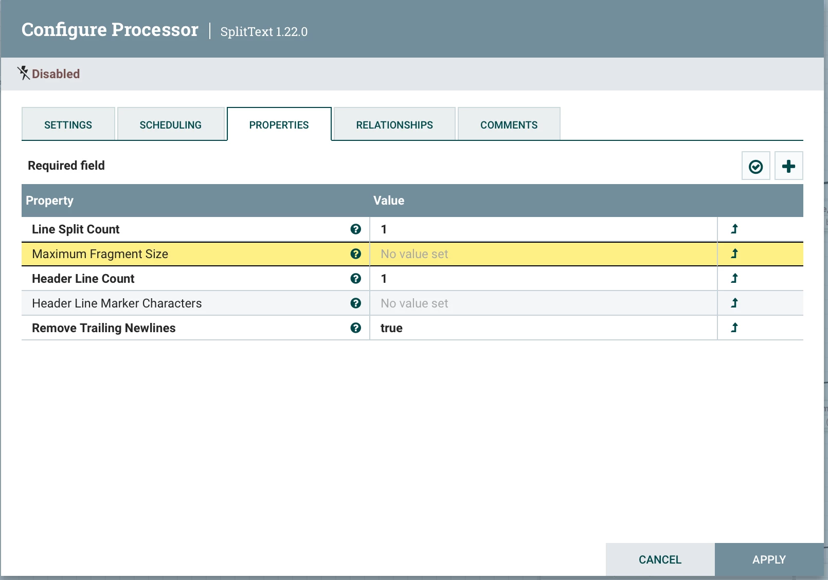

   Hello!
  The configuration of my SplitText is:
The task is to split one csv file:
  id;description
"1234";"The latitude is 12324.24"
"2345";"12324.24 this value"
on 2 files:
id;description
and
id;description
"2345";12324.24 this value"
But it returns 10000 and more duplicated files!
What am I doing wrong?

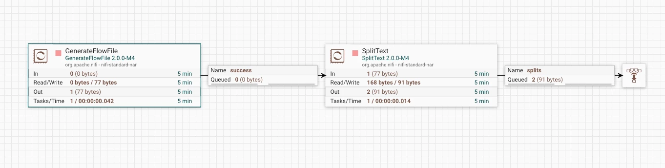

Hi @AndreyDE ,
What's your input into the SplitFile processor?
I used your example and getting a valid output -
Make sure the file going into the SplitText is not re-reading the same file over and over again and also if you are using generateFlowFile make sure the scheduling isn't set to 0 sec because it will keep outputting a bunch of flowfiles.
Please accept this solution if it's correct, thanks!

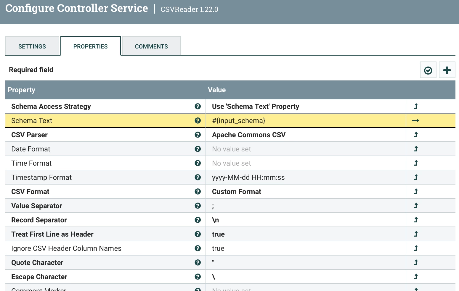

My SplitFile processor connected (follows by) ValidateRecords processor.
ValidateRecords use CSVReader with following configuration:
Input_schema is avro:
"type": "record",
"name": "geo_data",
"fields": [
"name": "id",
"type": [
"int",
"null"
"name": "description",
"type": [
"string",
"null"
And the source of this pipeline in ListS3 and FetchS3 processors.
