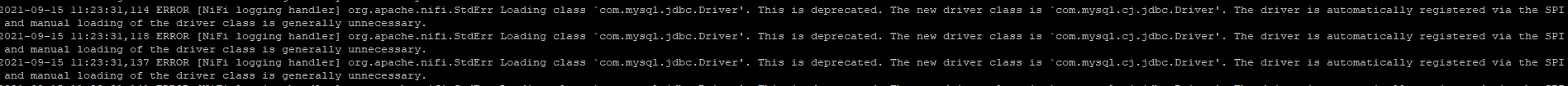

Yesterday, NiFi was running smoothly and for some reason it stopped working. Every time I tried to start : ./nifi.sh start or any other command it showed me "killed". Later on, I found that java was killed by OOM. Fixed this by restarting server, but it won't start. In the "nifi-bootstrap.log" I found that it's getting shut down due to this error:
I haven't installed any packages, so don't know why it's giving me this error.

Hello,
Have you checked the nifi app logs?  What errors you see in nif-app.log.

ERROR [main] o.a.n.c.serialization.FlowFromDOMFactory There was a problem decrypting a sensitive flow configuration value. Check that the nifi.sensitive.props.key value in nifi.properties matches the value used to encrypt the flow.xml.gz file
Was following this guide : https://community.cloudera.com/t5/Support-Questions/Failed-to-connect-node-to-cluster-because-local-flow/m-p/280186#M208717
But stuck witht finding config.zip file
