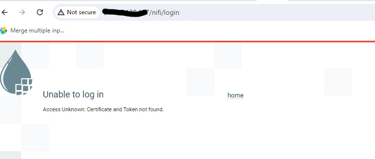

All Nifi UI has same credential. and loadBalancer is using HTTP connection. Now, Nifi UI is coming up, but while passing the credentials it is throwing error:
there is no such error in nifi logs:
3X.XX.XX.XX - - [28/Dec/2023:11:03:12 +0000] "GET /nifi/ HTTP/1.1" 200 21126 "http://3X.XX.XX.XX/nifi/login" "Mozilla/5.0 (X11; Linux x86_64) AppleWebKit/537.36 (KHTML, like Gecko) Chrome/81.0.4044.138 Safari/537.36"
Please guide me with the root cause if this problem and how to solve this?

Thanks, The Error message tells me that "access unknown certificate of token not found"
This means NiFi as a service expects client cert to be present if there are No client certs then a token must be present which would be obtained after entering the user name password.
But in LB connection it is possible that the token has been obtained from one nifi node but LB is redirecting the next request to a different NiFi node and it will not work
Have you configured the stick session at the Load Balancing Proxy?

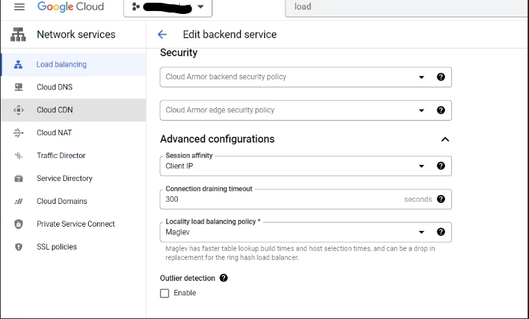

Thanks for your reply @ckumar ! I am using GCP services to create LB. for the backend services of LB we used session affinity as "client IP" ( As shown below in the Screen Shot).
Adding to this I used curl command to generate the token using LB URL, which is responding correctly. But Nifi UI still have the error.
URL used : curl --location --request POST 'http://<LoadBalancer>/nifi-api/access/token' --header 'Content-Type: application/x-www-form-urlencoded'  --data-urlencode 'username=<MyUser>'  --data-urlencode 'password=<MyPassword>'
Further, for debugging the root cause, I added only one Nifi server on the LB Backend, still getting the same error.
