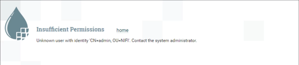

Mar 17, 2023 6:05 AM UTC
Thank you @ckumar @MattWho for your valuable inputs. through various methods, we were able to get it working. But facing a different problem now.
Do you have any idea on what could be wrong this time?
