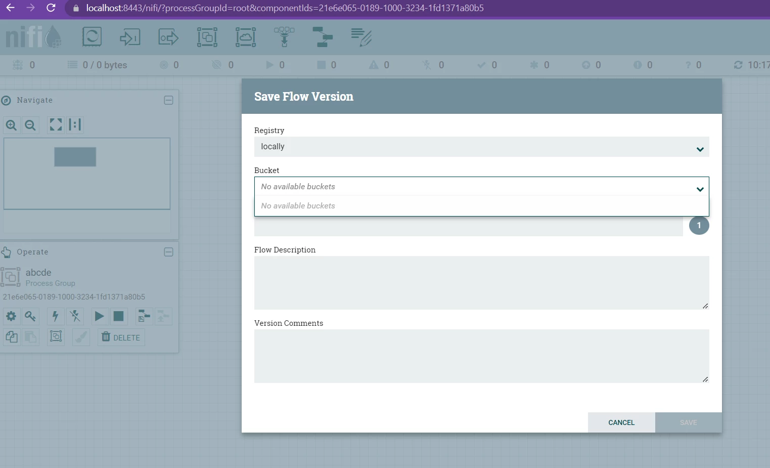

Hello All,
I had secure Nifi and Secured Nifi-registry running on Docker.
Both share same certificates
Able to access both UI's individually.
Given static IP to Registry in Docker and subjectalternativenames with this IP while generating certificates.

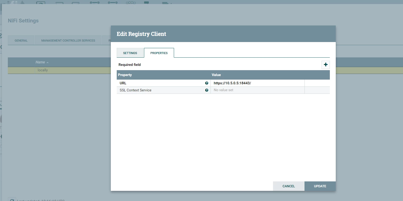

Given this static_IP:<port> in registry client.

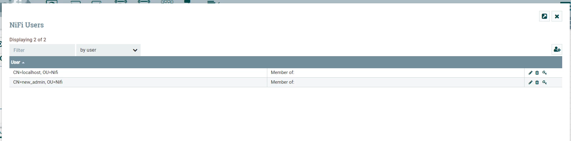

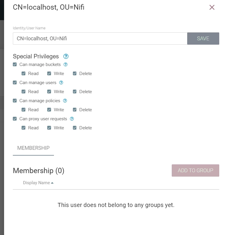

created localhost user : CN=localhost, OU=Nifi in both systems and given necessary permissions.

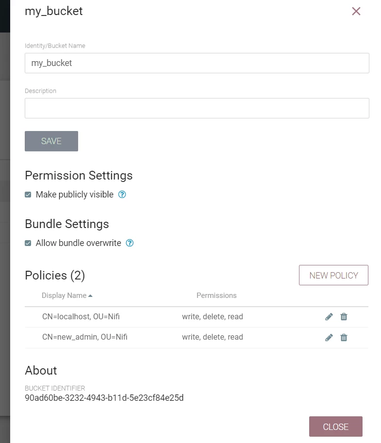

Created few buckets and given all necessary permissions..
But when I try to do version control, it says no available buckets.
As i troubleshoot, I can see the logs that shows successful authorization to registry..

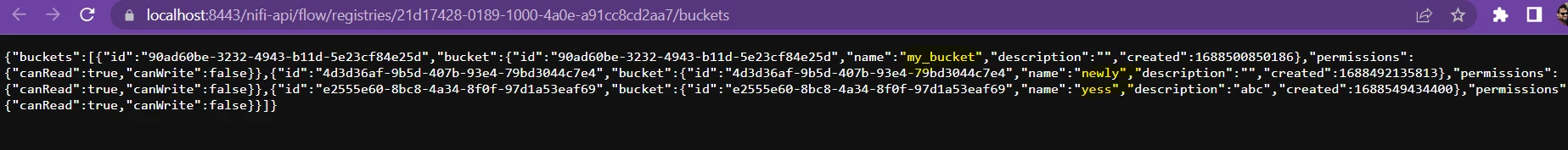

when i tried to open the buckets API URL (from above log) in my browser, i could get the buckets list aslo..
highlighted my buckets in Nifi-registry
I wonder why UI is not able to show the list, when Nifi's internal API call is able to fetch them correctly.

What i am saying is that rest-api call response you got via command line is probably not the exact same request made by NiFi.   What that response json tells you is that the user that made the request only has READ to all three buckets. You did not share the complete rest-api call you made, so I am guessing you did not pass any user authentication token or clientAuth certificate in yoru rest-api request and this that request was treated as bing made by an anonymous user.  Since your bucket(s) have the "make publicly visible" checked, anonymous user will have only READ access to the buckets.

The screenshots you shared showing the authorizations configured in NiFi-Registry are sufficient.  I was simply pointing out that you gave too much authorization to your NiFi node in the global policy section.   This is why i am leaning more to a TLS handshake issue resulting in an anonymous user authentication rather then an authorization issue.  You'll also want to inspect your nifi-registry-app.log for the authorization request coming from NiFi to see if is authorizing "anonymous" or some other string.  Perhaps you have some identity mapping pattern configured on NiFi-Registry side that is trimming out the CN  from your certificate DNs?  In that case you could also see this behavior because your NiFi-Registry would be looking up authorization on different identity string (instead of "CN=new_admin, OU=Nifi, i maybe looking for just "new_admin").  NiFi and NiFi-Registry authorizations are exact string matches (case sensitive); otherwise, treated as different users.

The rest-api output does nit match with your other image's authorizations.  I am going to guess that the rest-api call you made did not include a certificate?  Your bucket image shared shows that the bucket "my_bucket" was created as a "public" bucket meaning that anyone can view that bucket and the flows stored within that bucket (Rest-Api call returned "canRead: true" and canWrite: false", i'd expect both of these to return true if you passed a certificate for localhost or new_admin as your other image shows read, write, and deleted authorized for those users on "my_bucket".
In order to see a bucket in NiFi when starting version control on a process group, The authenticated user in NiFi must be authorized "write" on the bucket.
The permission required are:
1. NiFi node certificate must have "clientAuth and serverAuth extendedKeyUsage" and that clientAuth certificate needs to be authorized for Read,Write, Delete on "Can Manage Bucket" and "Can Proxy User Requests".  NO other authorizations are needed for the NiFi node certificate.
2.  The Authenticated User in NiFi which is being proxied via the NiFi node certificate needs to be authorized for the following on any bucket that users wants to use:
   2a:  READ - ability to import a version controlled flow from the NiFi-Registry bucket.
   2b:  WRITE - ability to start version control or commit new version of a flow to NiFi-Registry
   2c:  DELETE - ability to delete a flow from a bucket via the NiFi-Registry UI.
So I would start by getting a verbose listing of the keystore used in nifi.properties file to make sure that the PrivateKeyEntry has clientAuth as an ExtendedKeyUsage (EKU).
Then I would uncheck the "make publicly visible" box for your "my_bucket" and make your rest-api call again to see what permissions your NiFi node certificate (localhost) and new_admin have.  Remember that what is returned by that call dictates what will show in the various UIs within NiFi.
