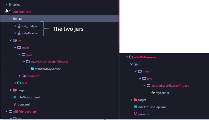

Here is my folder structure:

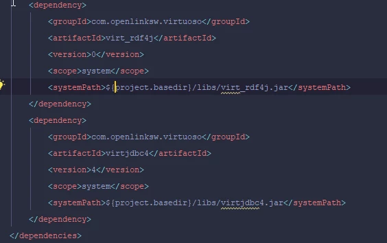

Here is the pom where/how I declare the jar dependencies (This is where I am assuming the error might be)

An update since I managed to solve the issue. I followed the advice given in this StackOverflow post https://stackoverflow.com/questions/364114/can-i-add-jars-to-maven-2-build-classpath-without-installing-them by creating a static in-project repository so that maven can have better access to the jars. It seemed to do the trick.
