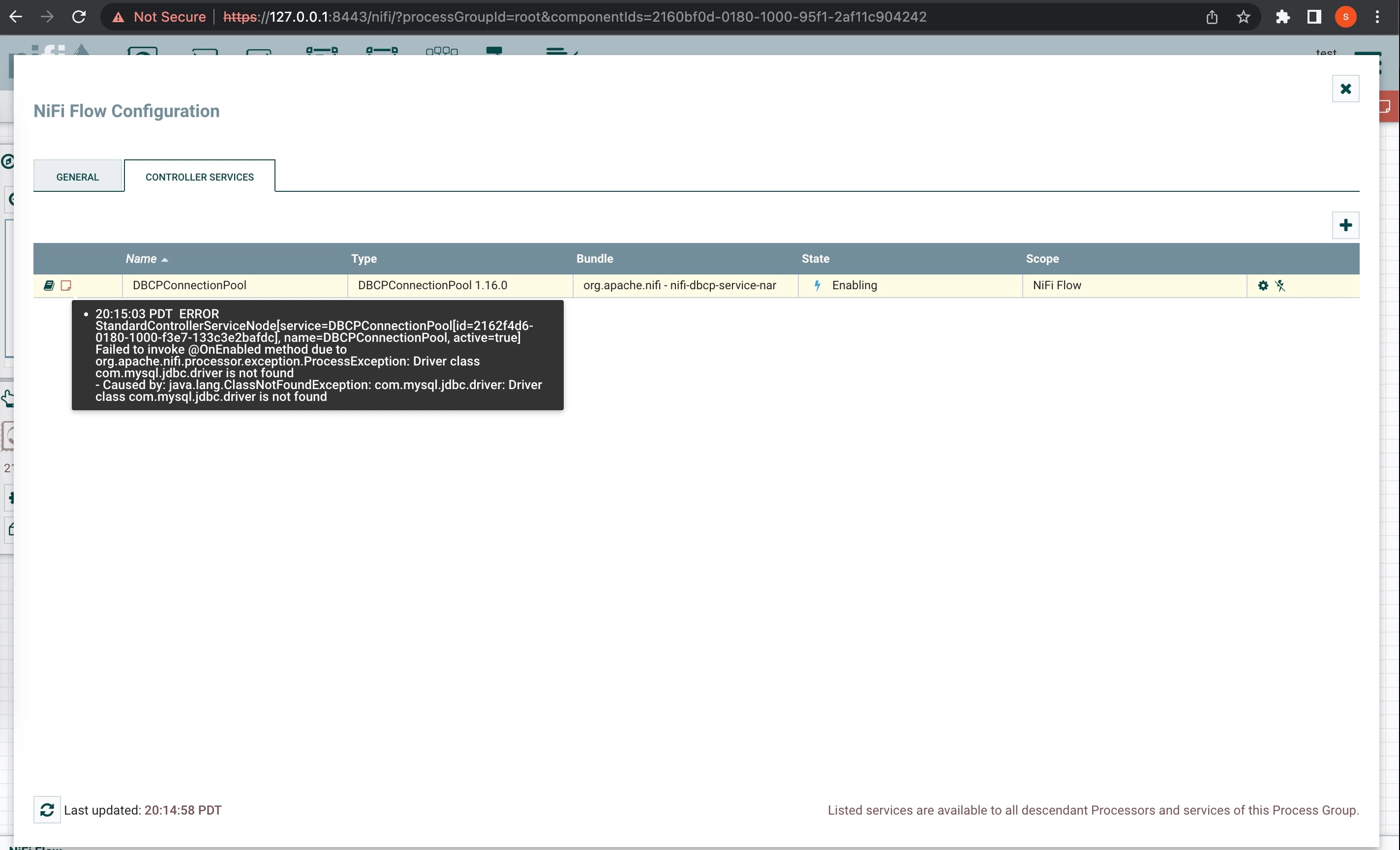

And also i have tried to Connect local NIFI in mac with local Mysql, i am facing an error while i enable the DBCP connection pool the error is mentioned in the image.

This error message:
Driver class com.mysql.jdbc.driver is not found - Caused by: java.lang.ClassNotFoundException: com.mysql.jdbc.driver: Driver class com.mysql.jdbc.driver is not found
Typically means that the JDBC driver is not being found on the relevant CLASSPATH, which is in this case is NiFi. After you ensure you haven't mistyped the name of the java Driver class, you need to make sure you installed the appropriate .jar file in the location where NiFi is expecting to find it, and that the file is not corrupted, etc.

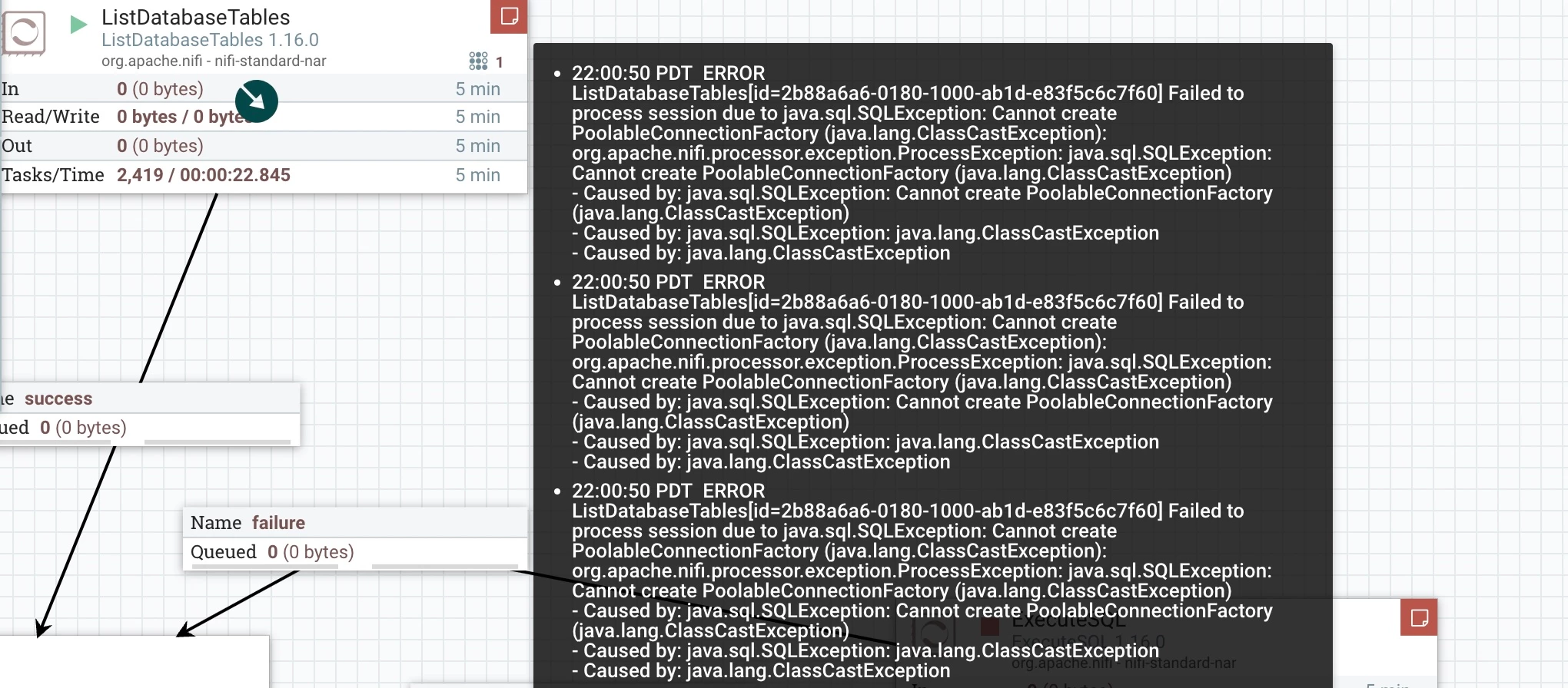

In Mac i have tried few methods and I am facing a new issue now similar to the windows error cannot create poolable connection, attached image for your referenceScreen Shot 2022-04-14 at 10.01.03 PM.JPG
