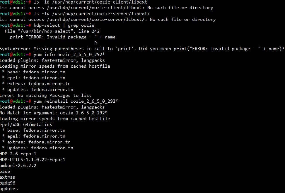

Hi Jay,
Please find attached the screenshot where I tryied to find "oozie.war" file using root user.
Regards,
Translate

@Wael Horchani
Ideally the path should exist in HDP 2.6.5 as well.
Example:
[root@newhwx3 ~]# ls -ld /usr/hdp/current/oozie-client/libext
drwxr-xr-x. 2 root root 6 May 11 2018 /usr/hdp/current/oozie-client/libext
[root@newhwx3 ~]# ls -ld /usr/hdp/current/oozie-server/libext/
drwxr-xr-x. 2 root root 6 May 11 2018 /usr/hdp/current/oozie-server/libext/
[root@newhwx3 ~]# hdp-select | grep oozie
oozie-client - 2.6.5.0-292
oozie-server - 2.6.5.0-292
Can you please check if you have the Oozie package installed properly?
# yum info oozie_2_6_5_0_292*
If not installed properly then you can try reinstalling it as following
# yum reinstall oozie_2_6_5_0_292*
Path to Oozie WAR:
[root@newhwx3 ~]# locate oozie.war
/usr/hdp/2.6.5.0-292/oozie/oozie.war
/usr/hdp/2.6.5.0-292/oozie/webapps/oozie.war
[root@newhwx3 ~]# ls -l /usr/hdp/2.6.5.0-292/oozie/webapps/oozie.war
-rw-r--r--. 1 root root 0 May 11 2018 /usr/hdp/2.6.5.0-292/oozie/webapps/oozie.war
Translate

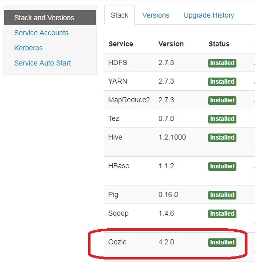

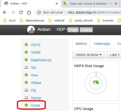

wael_horchani2
Silver ⭐️⭐️
February 3, 2019
Dear @Jay Kumar SenSharma ,
I am very surprised, and I have the impression that I have miss something.
By the first hand, there is no trace of OOZIE in the cluster.
By the second hand, i'm very sure that i select it during the installation and it's displayed by Ambari as UP.
I don't know what i should do !!
Regards,
Translate
jsensharma
Platinum ⭐️⭐️
Platinum ⭐️⭐️
February 4, 2019
@Wael Horchani
There seems to be some issue with the "hdp-select" command as well.
Like i see an error when you are running the simple "hdp-select" command.
Also in your case the Oozie version might be slightly different (due to a slight different HDP version) so please check which repo is providing you oozie packages which are installed to your host:
# yum info oozie*
Also please make sure that the host where you are checking the Oozie is correct host. I means please verify by logging in to the Oozie server host using SSH using IP Address instead of using Hostname for SSH (as sometimes it might be possible that we use incorrect IP-Host mapping inside "/etc/hosts" entry on our local machine so that while doing SSH wee go to a different host)
Translate
