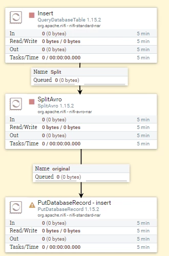

Than you I will try this. I'm new in nifi, so I make flow like this
So, I need GenerateTableFetch processor before QueryDatabaseTable? Am I right?

Thanks for additional details , You can use QueryDatabaseTable or GenerateTableFetch with ExecuteSQL both will be fine, as said you need to limit number of records per flow file .
When you say "When I try to move table with more then 1 GB data, my nifi GUI crashes"does that mean 1 flow file size is 1GB ? in NiFi generate by QueryDatabaseTable ? Is this happening when loading into NiFi by QueryDatabaseTable or after SplitAvro ? or At PutDabaseRecord ?
Ideal way is to have small flow file size at the loading from DB by limiting setting in QueryDatabaseTable or GenerateTableFetch which ever you use so memory footprint will be less and records will be streamed into multiple flow files.
