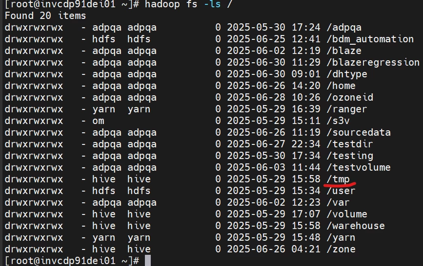

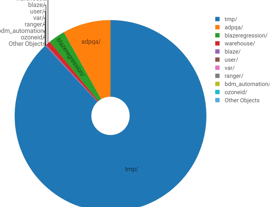

/tmp is occupied more space, please share command to cleanup /tmp
[root@invcdp91dei01 ~]# ozone admin namespace du ofs://ozoneid/tmp
Connecting to Recon: http://invcdp91dei04.informatica.com:9888/api/v1/namespace/du?path=/tmp ...
Path : /tmp
Total Size : 562 GB
DU
Size Path Name
405 GB /tmp/24c9e15e52afc47c225b757e7bee1f9d/
134 GB /tmp/5af6b2617513b81608501adea4166625/
459 MB /tmp/8a4ac216fb230da3834de641b3e5d0f7/
0 bytes /tmp/adpqa/
0 bytes /tmp/bb3462b62cd8db3f9ba007d86f8d1c6d/
21 GB /tmp/bc3dcd485adfa1c339eab38f1516c6c5/
0 bytes /tmp/d58da82289939d8c4ec4f40689c2847e/
0 bytes /tmp/tmp/

COuld you please confirm what is below in tmp dir looks like container to me, you can confirm the same form recon ui and find out the path it belongs to
