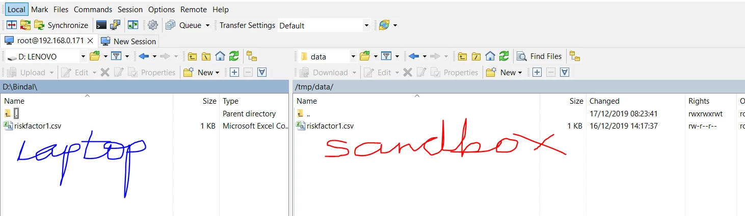

copy your riskfactor1.csv to this directory using some tool win Winscp or Mobaxterm see my screenshot using winscp

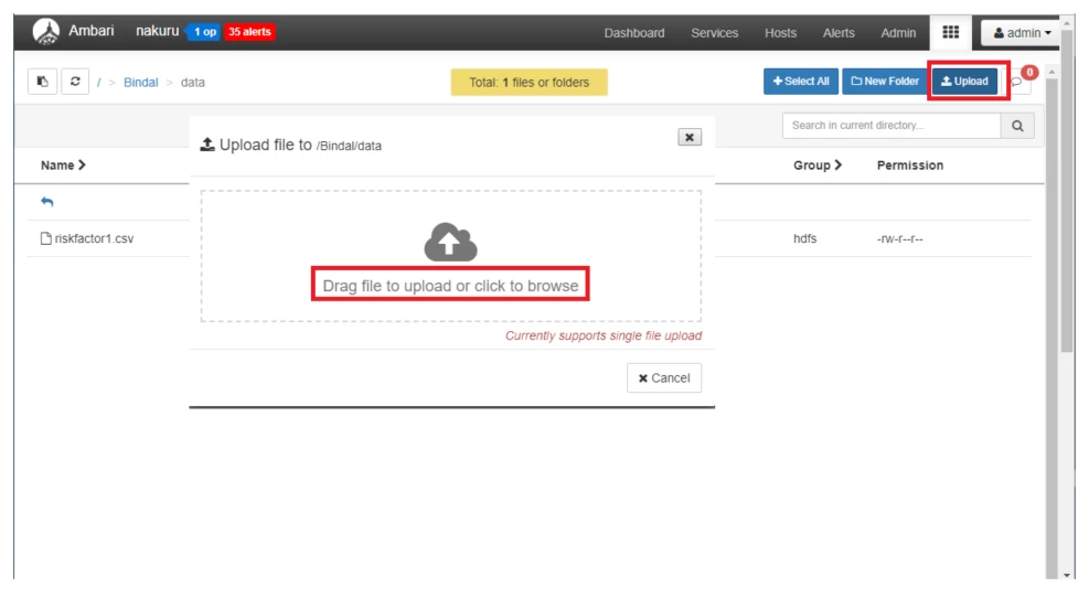

My question is where is riskfactor1.csv file located? If that's not clear you can upload using the ambari view first navigate to /bindal/data and then select the upload please  see attached screenshot to upload the file from your laptop.

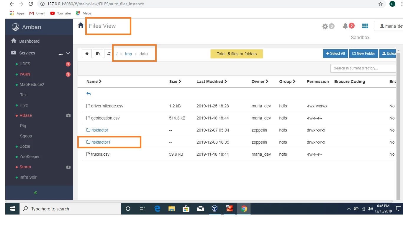

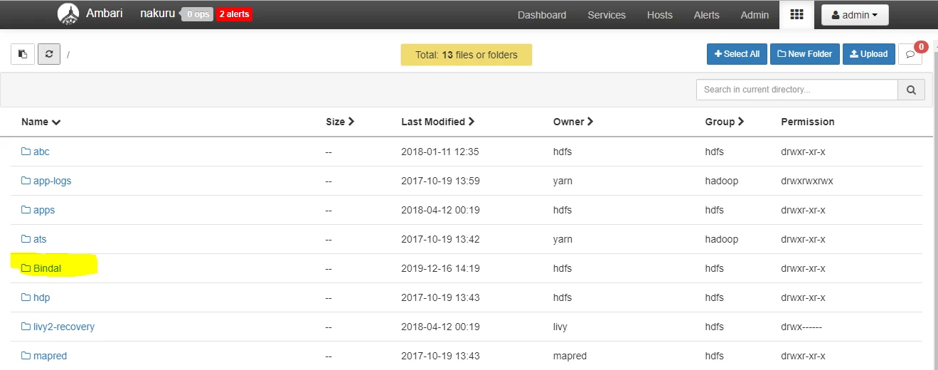

Great thanks for your detailed response. I have added a print screen of Ambari 'File Views'. I want to know whether it is local file system or hdfs file system. However I run commands suggested by you. But when when I tried to run following command "hdfs dfs -copyFromLocal /tmp/data/riskfactor1.csv /tmp/data" . I got the message "copyFromLocal: `/tmp/data/riskfactor1.csv': No such file or directory". I am not sure where I am doing something wrong. Thanks again for your help. Eagerly waiting for your response.

Thanks for sharing the screenshot. I can see from the screenshot your riskfactor and riskfactor1 are directories !!  not files
Can you double click on either of them and see the contents.

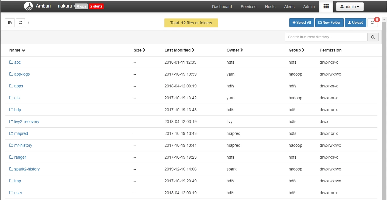

I have mounted an old HDP 2.6.x for illustration whatever filesystem you see under Ambari view is in HDFS.
Here is the local filesystem
My Ambari view before the creation of the  /Bindal/data  the equivalent to /tmp/data

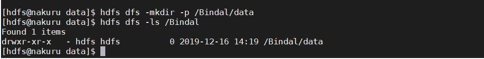

I created a directory  in hdfs

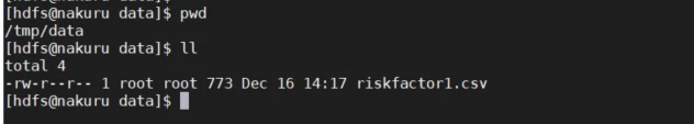

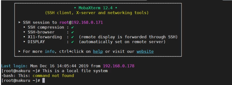

Make  the  directory  this is the local fine system
Copy the riskfactor1.csv from local file system  /tmp/data

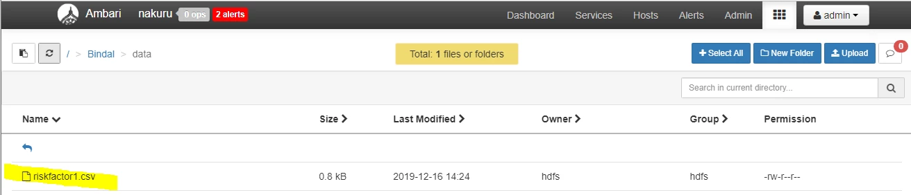

Check the copied file in hdfs
So a walk through from the Linux CLI as root user I  created a directory in /tmp/data and placed the riskfactor1.csv in there then create a directory in HDFS  /Bindal/data/.
I then copied the file from the local  Linux boy to HDFS , I hope that explains the difference between local filesystem and hdfs.

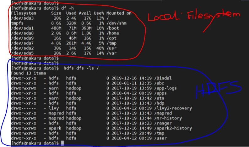

Below is again a screenshot to show the difference
Once the file is in HDFS your zeppelin should run successfully, as reiterated in your screenshot you share you need to double click on riskfactor and riskfactor1  which are directory to see if the difference with my screenshots
