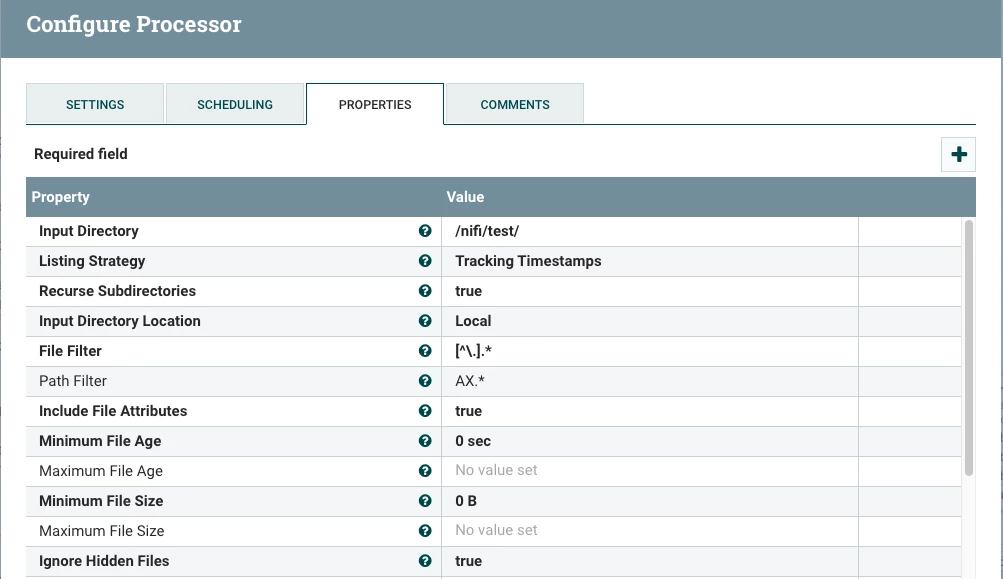

Hello All,
I would need to use Path filter for searching subfolders starting by AX.
AX1/
AX2/
XY1/
XY2/
I tried this in path filter:
AX.*/
Is that correct?
Thanks everybody

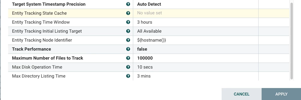

@JSJ
Let's assume you have following directory structure:
/nifi/test/AX1/
/nifi/test/AX2/
/nifi/test/XY1/
/nifi/test/XY2/
You would configure your listFile processor as follows:
Screen Shot 2019-12-16 at 2.46.36 PM.pngScreen Shot 2019-12-16 at 2.47.08 PM.png
Hope this helps,
Matt
