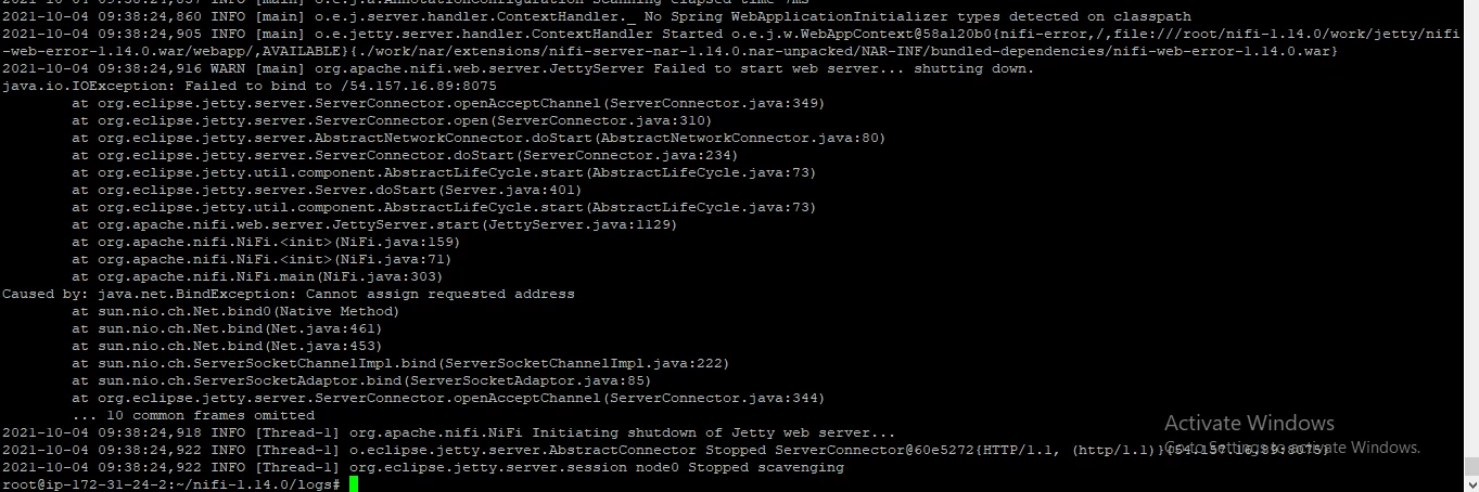

MattWho
Titanium ⭐️⭐️
Titanium ⭐️⭐️
Oct 4, 2021 6:18 PM UTC
@Phanikondeti
Thanks for sharing the log output.  Your NiFi is not up, It failed to start because it was unable to bind to the IP and port shown in the logs.  That IP address would correlate to what you have set in either of the following properties in the nifi.properties file:
(if unsecured) nifi.web.http.host=
(if secured) nifi.web.https.host=
You could use ifconfig command to see if your server has a network interface with that IP assigned to it.
If it was a port issue, I'd expect you to see a log message about port already being in use or that you're trying to launch NiFi as a privileged user and tried to use a port number below 1024.

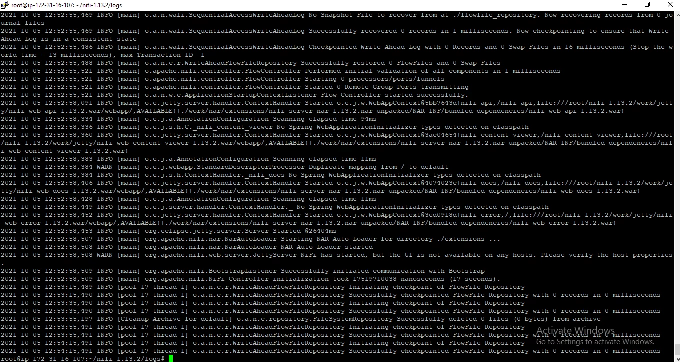

Phanikondeti
Silver ⭐️⭐️⭐️
Oct 5, 2021 1:00 PM UTC
error :
org.apache.nifi.web.server.JettyServer NiFi has started, but the UI is not available on any hosts. Please verify the host properties.

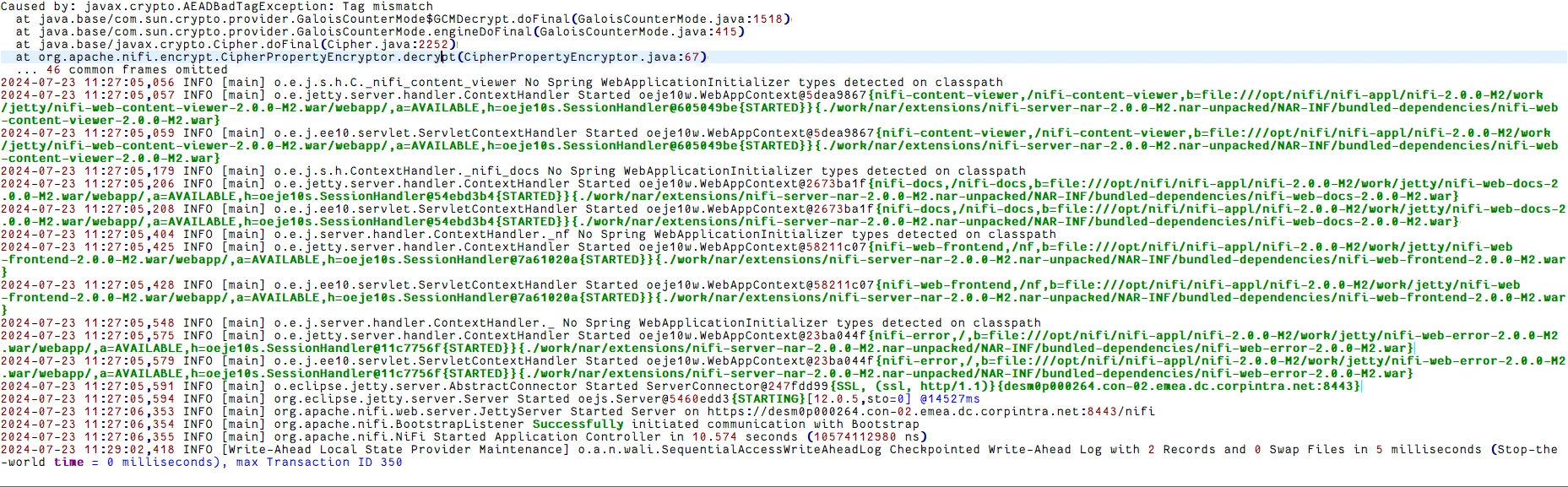

_Salva_
Silver ⭐️
Jul 23, 2024 9:43 AM UTC
Hello,
I got a similar error when trying to start nifi the first time. Currently I´m getting the error
As follows a little screenshot from the app-log:
