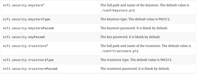

Hi @MattWho
My nifi.properties file looks fine I think:
# security properties #
nifi.sensitive.props.key=nN9mVm0kCmsmO1CwC+ODWFNr9kFjHyZX
nifi.sensitive.props.key.protected=
nifi.sensitive.props.algorithm=NIFI_PBKDF2_AES_GCM_256
nifi.sensitive.props.additional.keys=
nifi.security.autoreload.enabled=false
nifi.security.autoreload.interval=10 secs
nifi.security.keystore=./conf/keystore.p12
nifi.security.keystoreType=PKCS12
nifi.security.keystorePasswd=
nifi.security.keyPasswd=
nifi.security.truststore=./conf/truststore.p12
nifi.security.truststoreType=PKCS12
nifi.security.truststorePasswd=
nifi.security.user.authorizer=single-user-authorizer
nifi.security.allow.anonymous.authentication=false
nifi.security.user.login.identity.provider=single-user-provider
nifi.security.user.jws.key.rotation.period=PT1H
nifi.security.ocsp.responder.url=
nifi.security.ocsp.responder.certificate=
So I don't know where is problem unfortunately...

@MWM
For good security reasons, NiFi does not support passwordless keystore and truststore files.
The password fields can not be blank.
Also keep in mind that the default "nifi.web.https.host=127.0.0.1" is localhost on the machine were you installed NiFi. So you will not be able to access this IP from any other machine. You'll need to use a browser installed on the same machine.
