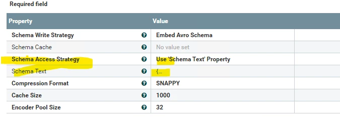

cotopaul
Platinum ⭐️
Oct 17, 2023 1:23 PM UTC
Open the Controller Service for AvroRecordSetWriter, and in the field Schema Access Strategy, switch from Inherit Record Schema to Use 'Schema Text' Property. Once you select this option, a new property will be added, named Schema text. In the Value field for this property add the AVRO Schema.

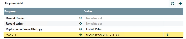

Oct 17, 2023 1:36 PM UTC
@cotopaul are you sure this property should look like this :
because it didn't work, UUID_1 now look like this : "UUID_1" : ":toString(/UUID_1,\"UTF-8\")"

cotopaul
Platinum ⭐️
Oct 17, 2023 2:07 PM UTC
The value for the property certainly should be like toString(/YOUR_COLUMN,"UTF-8"), without those backslashes. Have a look in the documentation for the expression language and you shall see.
As for how the data will look like, that is nothing you could change. Give it a try with the correct syntax, not the one that you wrote.

Oct 17, 2023 2:22 PM UTC
@cotopaul I write correct syntax but it didn't work 😕 But in UpdateRecord processor Replacement Value strategy should be on Literal Valu or Record Path Value?
Translate
cotopaul
Platinum ⭐️
Oct 17, 2023 2:23 PM UTC
@MWM, when using toString(), it should stay on Record Path Value.
