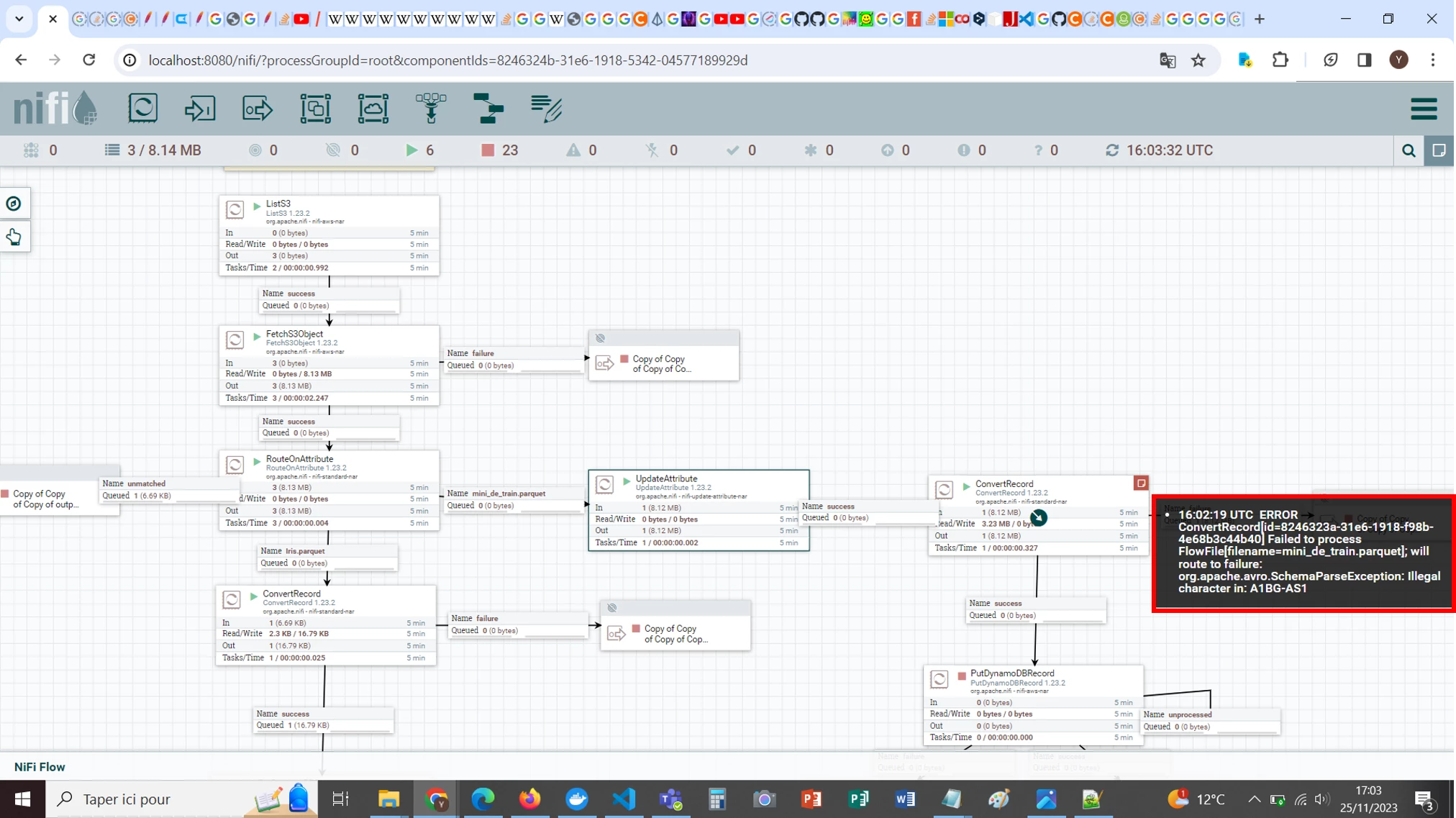

But I still have a problem with another file. Here's the error:
UTC ERROR
ConvertRecord[id=92018f18-018b-1000-fd6f-0a3466abe069] Failed to process
FlowFile[filename=mini_de_train.parquet]; will route to failure:
org.apache.avro.SchemaParseException: Illegal character in: A1BG-AS1

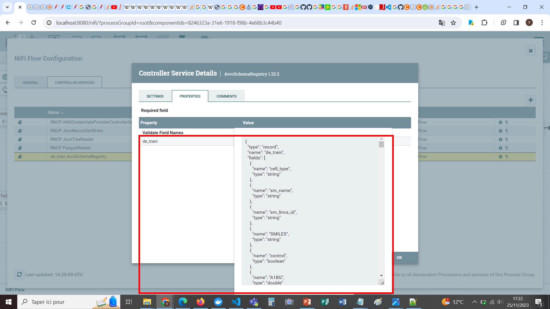

There are some characters that are not accepted (like "-" in "A1BG-AS1") so I've changed them all in the schema, the beginning of which is shown below (there are more than 18,000 columns):

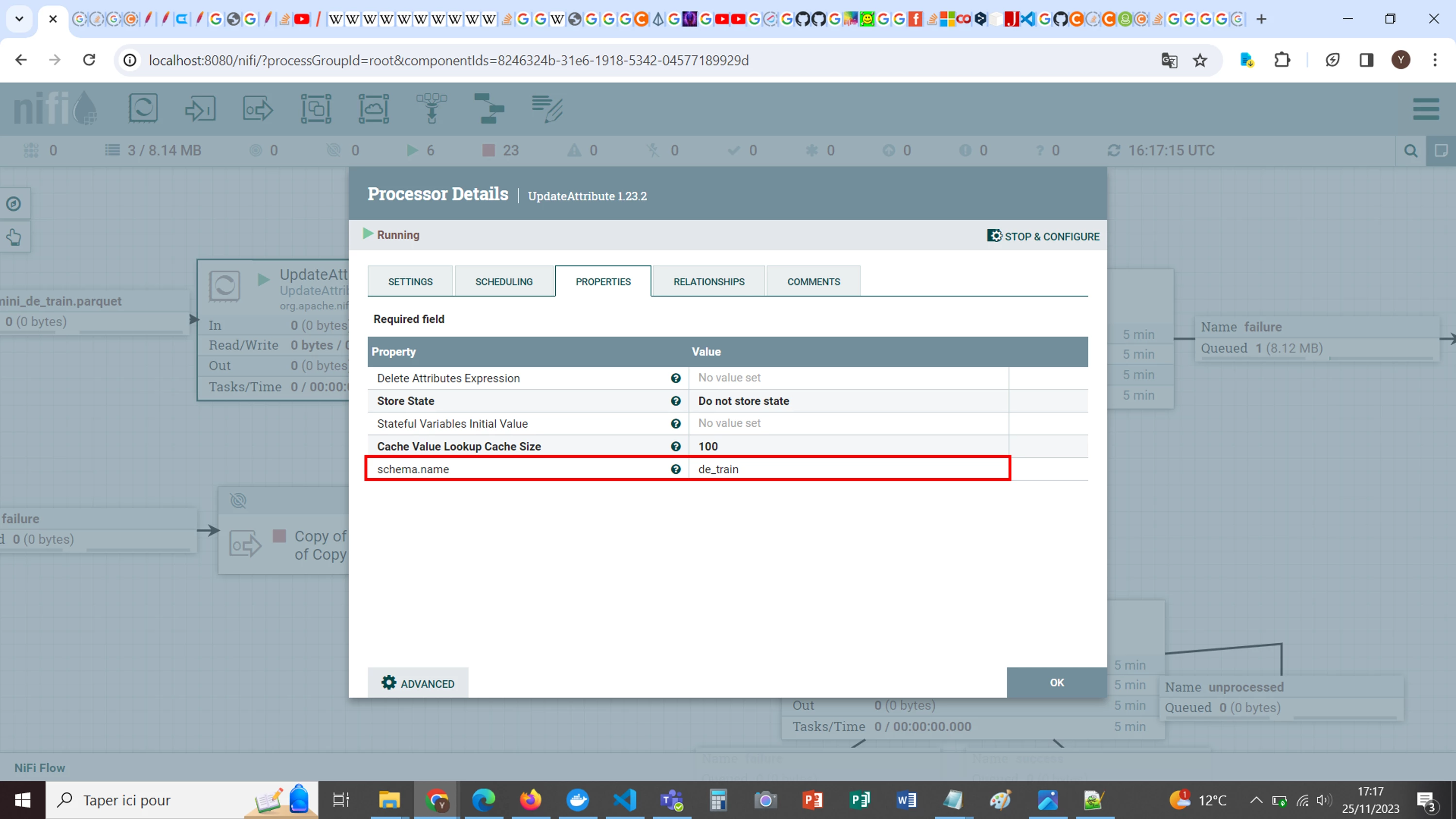

So I tried to add it via an UpdateAttribute processor before the ConvertRecord where I put the name of the schema (de_train), and an AvroSchemaRegistry used by my JsonRecordSetWriter which calls this schema :
But after these modifications I still get the same error:
What am I doing wrong?

As well as changing the names of several columns, I also need to change the type of some of them, as some are of type "large_string" and one is of type "bool". I had this error for example when I tried to add the schema (retrieved with Python code from my Parquet file) to the ConvertRecord processor:
'schema-text' validated against '{
"type": "record",
"name": "de_train",
"fields": [
"name": "cell_type",
"type": "string"
"name": "sm_name",
"type": "string"
"name": "sm_lincs_id",
"type": "string"
"name": "SMILES",
"type": "string"
"name": "control",
"type": "bool"
"name": "A1BG",
"type": "double"
"name": "A1BG_AS1",
"type": "double"
"name": "A2M",
"type": "double"
"name": "A2M_AS1",
"type": "double"
"name": "A2MP1",
"type": "double"
}' is invalid because Not a valid Avro Schema: "bool" is not a defined name. The type of the "control" field must be a defined name or a {"type": ...} expression.
I had to change "large_string" to "string" and "bool" to "boolean" to get no more errors in the AvroSchemaRegistry.
