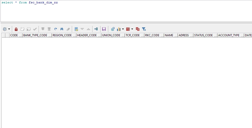

I am trying to copy table rows from one oracle database to another oracle table. PutDatabaseRecord cannot find the second table. I checked many times that table  exists. But it is still giving error. Does anybody know how to solve it?
PutDatabaseRecord[id=cb461cc1-018d-1000-21fe-ec8db1afeca1] Failed to put Records to database for FlowFile[filename=040d505a-1d6c-4f36-8a2b-38bcf577a059]. Routing to failure.: org.apache.nifi.processors.standard.db.TableNotFoundException: Table fsc_bank_dim_zz not found, ensure the Catalog, Schema, and/or Table Names match those in the database exactly

Thanks for the reply. I have found the answer myself. The table name must be all in capital letters. No need to add schema or catalog name.
