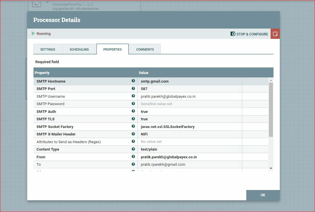

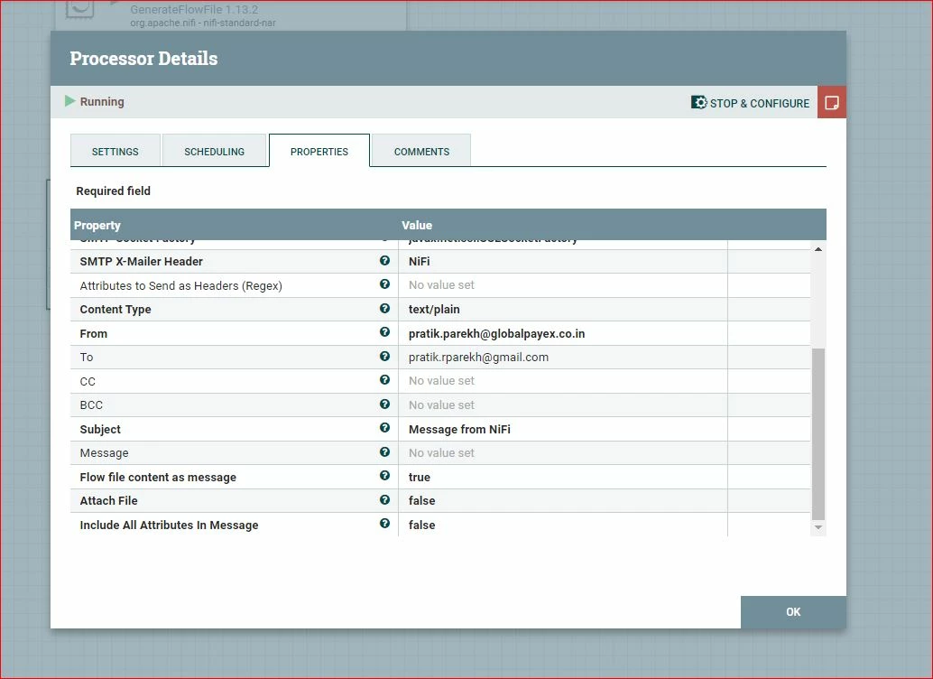

I have been trying to send an email via NiFi using PutEmail processor with Gmail/Outlook both and getting same exception in both of the configuration as

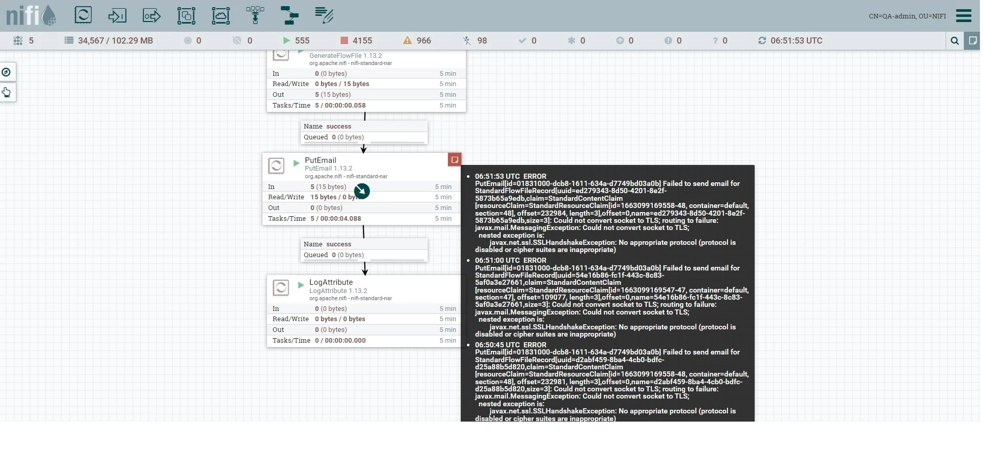

PutEmail[id=3611dcb8-0183-1000-8a1d-df8f12f92438] Failed to send email for StandardFlowFileRecord[uuid=017c80a8-fad0-493b-a427-fa72b9a530c7,claim=StandardContentClaim [resourceClaim=StandardResourceClaim[id=1663081396353-45, container=default, section=45], offset=521106, length=538],offset=0,name=f37f23a1-e328-4eff-bb30-6f125369ebf7,size=538]: Could not convert socket to TLS; routing to failure: javax.mail.MessagingException: Could not convert socket to TLS;
nested exception is:
javax.net.ssl.SSLHandshakeException: No appropriate protocol (protocol is disabled or cipher suites are inappropriate)
The configuration is set as below :

The putEmail processor supports the adding of dynamic configuration properties as outlined in the linked documentation.
https://javaee.github.io/javamail/docs/api/com/sun/mail/smtp/package-summary.html
It would be helpful to collect the full stack trace written to the nifi-app.log rather then sharing the partial shown via the processor bulletin produced on the NiFi UI. From that stack trace output you may be able to determine what dynamic properties need to be added.

This has been resolved by upgrading NiFi to version 1.15 and above. Below this version not supporting TLS configuration.
