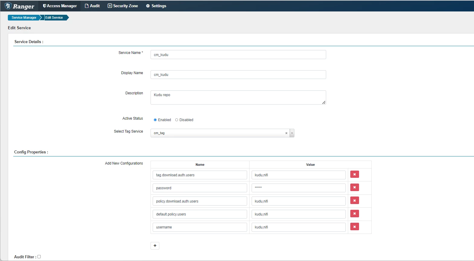

We are using default settings, so Kerberos is disabled, we are using Ranger with default service name and policies created by Cloudera manager installation.
As described in this post (https://community.cloudera.com/t5/Community-Articles/Using-the-PutKudu-processor-to-ingest-MySQL-data-into-Kudu/ta-p/247205) we thinks that isn't necessary to enable Kerberos to scout this feature. If kudu requires an authentication to work properly we accept to use Ranger, but for the moment we don't want to enable kerberos.

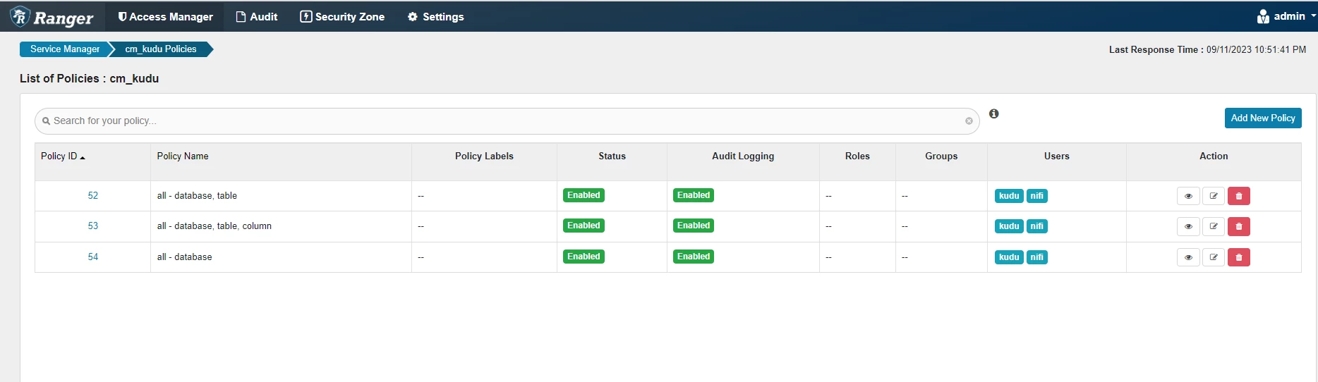

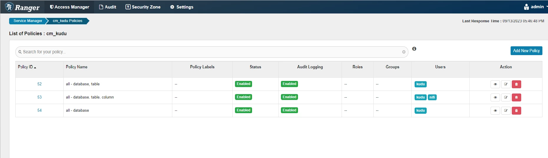

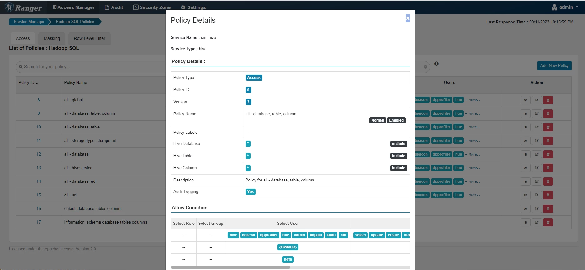

By using Impala on HUE we created a KUDU table. Then by Ranger webUI, in the Hadoop SQL service name created by cloudera manager during installation, I modified the "all - database, table, column" policy which allows access to all databases, tables, and columns, extending permission also to users "nifi" and "kudu".
And this is the cm_kudu policy in Ranger:

Hello to all again. I think tath my issue is related to a missing authentication by ranger.
So, i follow the the Clouder guide instruction (https://docs.cloudera.com/cdp-private-cloud-base/7.1.8/kudu-security/topics/kudu-ranger-policies.html) about
Ranger policies for Kudu
I modified the service name cm_kudu as follow
and kudu policy as follow
i restart both kudu and ranger services.
But when i run the command, it give me an error
sudo -u nifi kudu table describe machine-bigdata-h02 default.gianni
End of file: Failed to execute Ranger client subprocess request: unable to send message: Other end of pipe was closed
while if i run the same command by a tusted user such as kudu, hive or impala it works

Now i don't understand why ranger policy added in cm_kudu service name doesn't work. Could someone explain me what i'm missing in my ranger policy for kudu?
