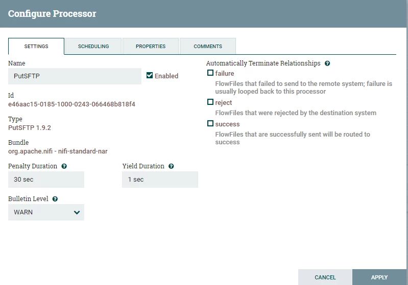

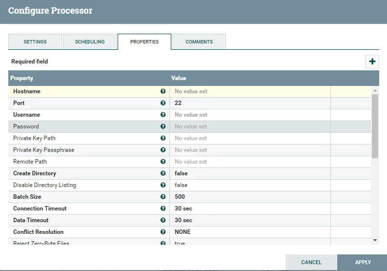

 I am having a simple flow where I am fetching the creds for SFTP from DB and then uploading a file using the putSFTP but I am getting UnknownHostException error on PutSFTP processor.
I see the creds are being fetched - I see them in logs and also tried connecting to the Server using FileZilla (creds are correct ..no space etc all good with that)..
Also I tried hardcoding the creds in PutSFTP and still it did not work.
can someone please guide me..

Hi Matt,
Also have added the host to the known_host file as suggested in previous comment
have shared the details on error and configuration

For security reasons I have changes the hostname and also shared screenshot without disclosing any sensitive details.
