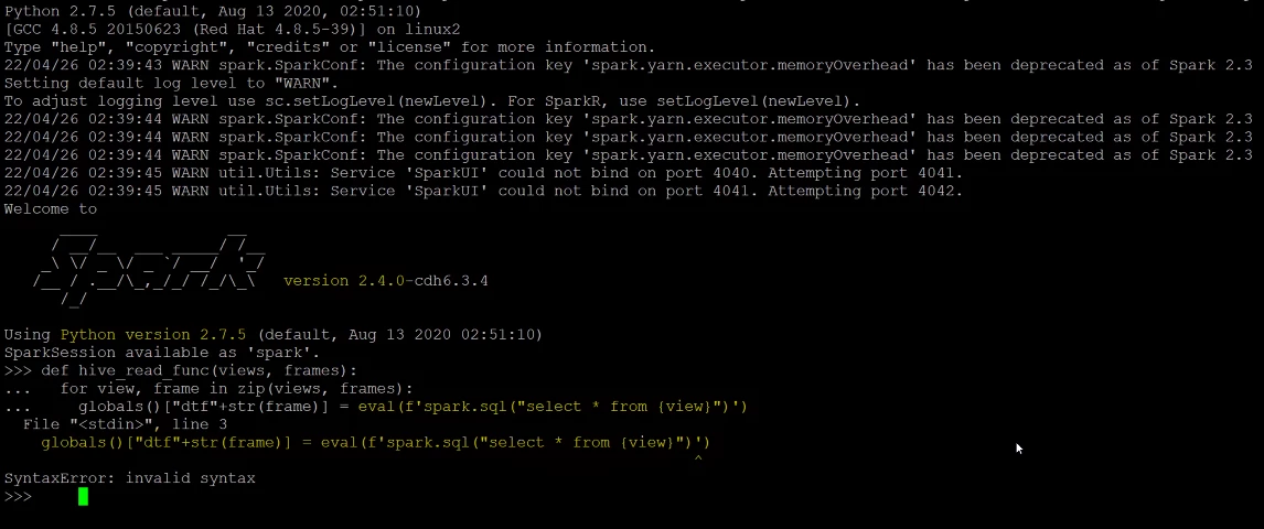

when I run the function hive_read_func in cloudera getting below error:

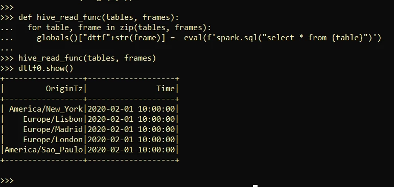

function in clouderafunction in cloudera but when I run in my local system its running perfectly fine:
same function in local systemsame function in local system

I got the answer myself: this is because of version f-string is available after python 3.1 but I run it in python version 2.6. so got error, now I rewrite the function with out f-string:
def hive_read_func(tables, frames):
for table, frame in zip(tables, frames):
inner_code = "select * from"+" "+ str(table)
globals()["dttf"+str(frame)] = spark.sql(inner_code)
