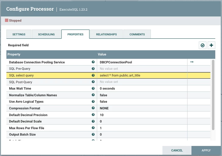

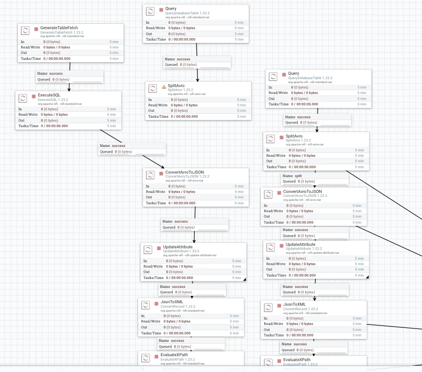

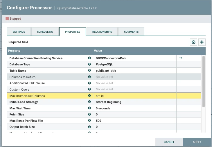

Hi, Guys. I am new to use NiFi flow. I am kind of confused about Query database table processor. So now, I am try to get all data from Postgres database and convert them into json and then convert them into xml.
But sometimes, the Query database table processor will have a lot of Flow file and then the queue just mess up. I try to set the art_id to be maximum-value column but it doesn't work well because art_id is string.(not sure)

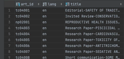

This is a screenshot from a sample table called title and it has about 500 rows. How to query them just one time and split them into 500 flowfile and each of flowfile has only one row from table title without any duplicates. Can someone help me?
Thank you so much. Following screenshots are my progress so far.

The QueryDatabaseTable processor is used mainly when you are having a dynamic data table where the data is continuously being added\updated. The provided Maximum Value Column will always help tack the delta by saving the last max value retrieved from the last generated query and so on. This Max value column works better for columns where values increase over time for example numerical , datetime values. For string values it can work if that added\changed is always guaranteed to be greater than previous max value otherwise you might get unpredictable results.
In your case, when you say that the "queue will have a lot of flowfile and it will mess up" can you explain that more? for example are you getting more flowfiles than whats in the table, getting duplicates  or getting error? what exactly happen?
If you have fixed number of records that is not going to change in the future as you are indicating there is 500 records and you want to process the data onetime , then you dont need to use QueryDatabaseTable  with max value column, you can use ExecuteSQL or ExecuteSQLRecord and specify the select statement in the "SQL Select Query" property , In the ExecuteSQL you will get the result in Avro format but if you use the ExecuteSQLRecord you can decide the output format  in the RecordWriter , for example if you are looking to convert data into Json or XML right away without having to go through Avro.

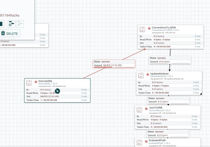

Yes, "queue will have a lot of flowfile and it will mess up"  means that there are a lot of data that I don't really want. I just want the 500 row in my table.

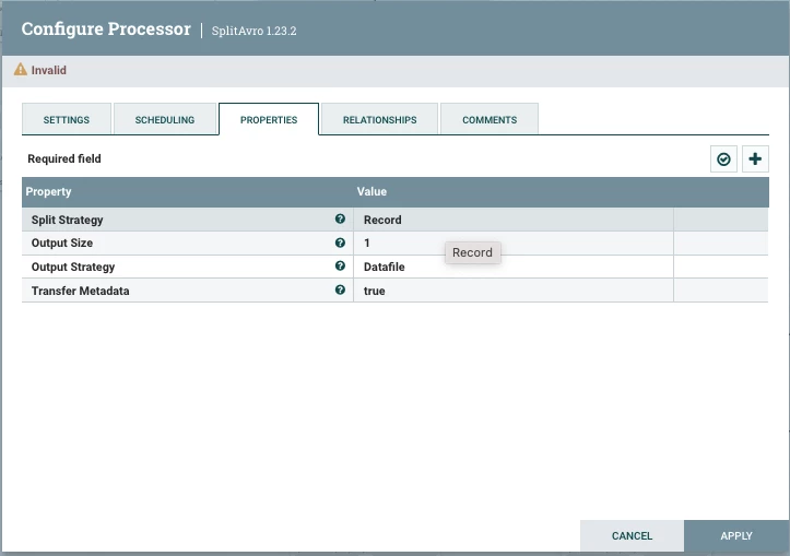

My flow so far is ExecuteSQL and then split avro and then convert to json and then convert to xml. I want each flow file have one row in my table.
For the executeSQL, do I need to set up schedule time? If I run executeSQL, will I get exactly 500 flowfile?

Is there only 500 records in your table and that is all the records you want to processes? If so then you dont need to create schedule , you can run it once using the query  in the "SQL Select Query" property:
select * from public.art_title
If you use the ExecuteSQLRecord then you can set the RecordWriter to Json using JsonRecordSetWriter, or XML using XMLRecordSetWriter to get the needed format, this way you save yourself having to convert from Avro to Json then Json to XML. You can get the result in XML right way.
Also if you set the property "Max Rows Per FlowFile" to 1 , then it will create only one record per flowfile so there is no need to split.

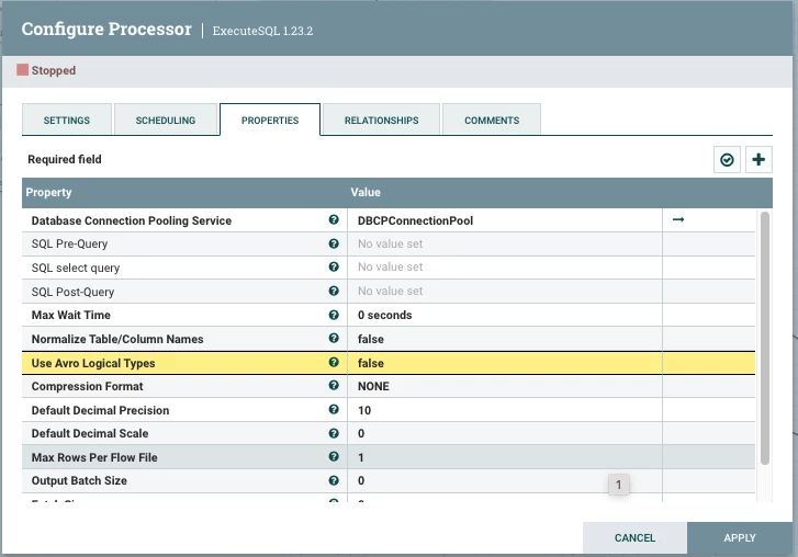

Dec 14, 2023 2:17 PM UTC
but it looks like still a lot of information, not only 500 flowfiles in the queue. Above pic is my configuration.Screenshot 2023-12-14 at 9.17.29 AM.png

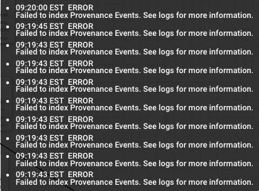

By the way , on the upper right corner of NiFi page, there are some errors that I can't understand. Can you explain it to me? Thank you so much!!!

I need to understand the following:
1- Does the table have total of 500 records and if so are those records static or are they going to be modified over time and you need to keep processing them ?
2- Do you need to run the ExecuteSQL multiple times to process the same\updated 500 records or do you just need to process them once ? each run of ExecuteSQL with the provided select query will fetch the total records, so if you start the processor to start running indefinitly where the Run Schedule under the Scheduling tab is set to 0 then it will keep fetching the same total records again and again and it will fill up the queue .

SAMSAL
SAMSALAnswer
Platinum ⭐️⭐️⭐️
Dec 14, 2023 3:03 PM UTC
It seems that you need to process the 500 records once. In this case you dont need to start the ExecuteSQL processor nor worry about scheduling it unless you want to run it again in the future. Keep the processor stopped then  right click on it and select Run Once. This should load the total number of records one time.
