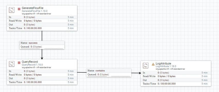

Flow:

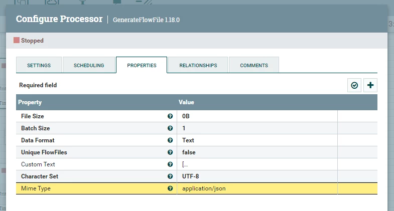

GenerateFlowFile:
Custom Text:
"fields": [
"field": "field1"
"field": "field1"
"fields": []
"fields": [
"field": "field2"
"field": "field2"
"fields": [
"field": "field3"
"field": "field3"

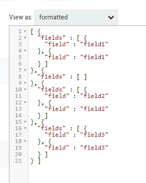

Expected output: To filter out the 2nd object whose field is an empty array

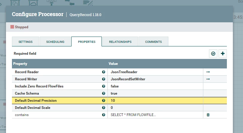

QueryRecord:
Record Reader and Writer services are set to infer the schema

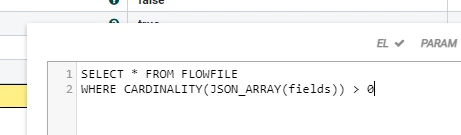

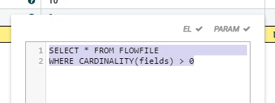

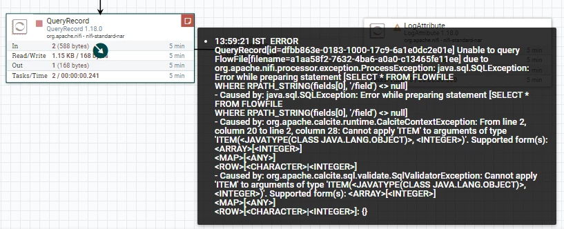

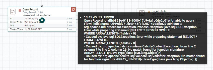

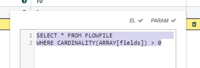

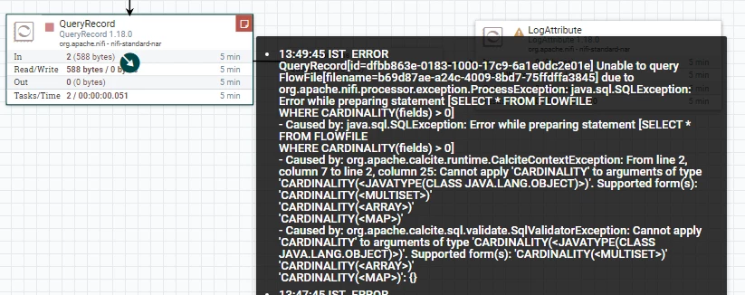

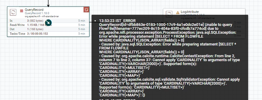

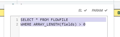

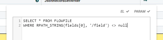

Solutions Tried:
1.
2.
3.
No Error but didn't filter out

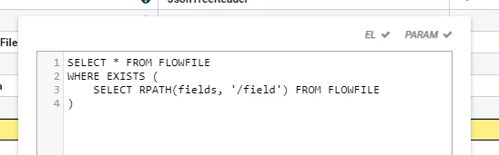

4.
5.
Using RPATH I was not able to pick specifically the first element to check if it exists or not
Got stuck because of this particular processor. Please help me out with the problem and let me know if any better way to do this with other processors. I'm avoiding working with single-flow files as am aware of the EvaluateJsonPath -> RouteOnAttribute solution and want to work specifically on Record based.

Hi,
I think you were close with the last option but did not use the correct syntax with null values where instead of '<> null',  use 'is not null' as follows:
select * from FLOWFILE where RPATH(fields, '/field') is not null
However when I run that I got the correct result but for some reason a MapRecord Syntax is added to each array element :
"fields" : [ "MapRecord[{field=field1}]", "MapRecord[{field=field1}]" ]
"fields" : [ "MapRecord[{field=field2}]", "MapRecord[{field=field2}]" ]
"fields" : [ "MapRecord[{field=field3}]", "MapRecord[{field=field3}]" ]
Not sure why this happens but that should get you close to what you are trying to accomplish.
Hope that helps. If it does, please accept solution.
Thanks

I have resolved the issue using ScriptedFilterRecord. I thought it is similar to the ExecuteScript processor and might include a long script with boiler code but in the former processor a single-line code did the job
Would still like to know if QueryRecord can solve this problem or not..

Hi,
Thanks

Thanks for the reply, it worked 🙂
Also, I got the expected output and didn't see the `MapRecord` as displayed in your output
Thanks!
