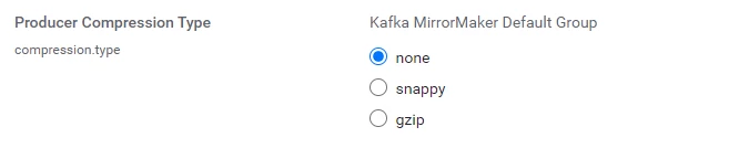

In CM, I see a global setting.
Does it apply to KafkaMirrorMaker only?
Are producer and consumer applications somehow affected, when the global parameter changes.

3) Does it apply to KafkaMirrorMaker only?
>> Yes, as per the screenshot it will apply for the MM only.
