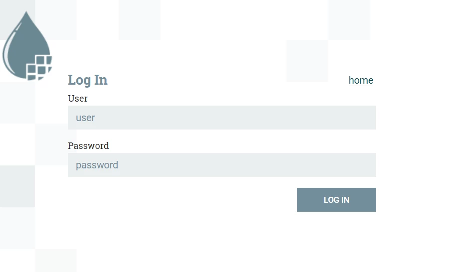

Hello All,
I am new to NiFi. I have set up NiFi with LDAP authentication and NiFi starts with no issues but I don't know how to log into NiFi as "Initial Admin Identity" user "user_admin" as shown in my setup below. What should I use as the login credentials as NiFi presently rejects user_admin/<password>?

Yes, user_admin exists in LDAP server but when I try to use it's password from the server to log on, NiFi rejects even though I know it's correct.
Should I change this: sAMAccountName to just {0}?
Also, how do I use the contents of the user.xml and authorizations.xml that were generated by NiFi? What do those mean? Sorry for my very basic questions. I really appreciate your help

I am not clear what you mean by "NiFi rejects" it.  What is the exact exception you are seeing. NiFi does not reject anything, the ldap endpoint would be what would be responding to the query.
The "{0}" is replaced with the username string you enter in the "user" field presented by NiFi.   So let's assume you login with "user_admin".  Your configured LDAP endpoint would be queried for user with "sAMAccountName=user_admin" as an attribute.
I would get the ldap listing for your user_admin user from ldap server and verify that "sAMAccountName=user_admin" exists.   sAMAccountName is an attribute more commonly associated with Active Directory (AD), but can be added to LDAP as a useable attribute with some custom ldifs.
Two authentication happen here:
First is the Manager DN along with Manager password is used to facilitate a connection to your ldap.  Then the supplied username via login UI is used to lookup the specific user record for password verification.
Additionally, since you are using LDAPS instead of LDAP, you are enabling a TLS encrypted connection to your LDAPS. So something else you'll want to verify is that the keystore and truststore you configured in your ldap-provider contains the necessary entries to facilitate that successful TLS connection.
