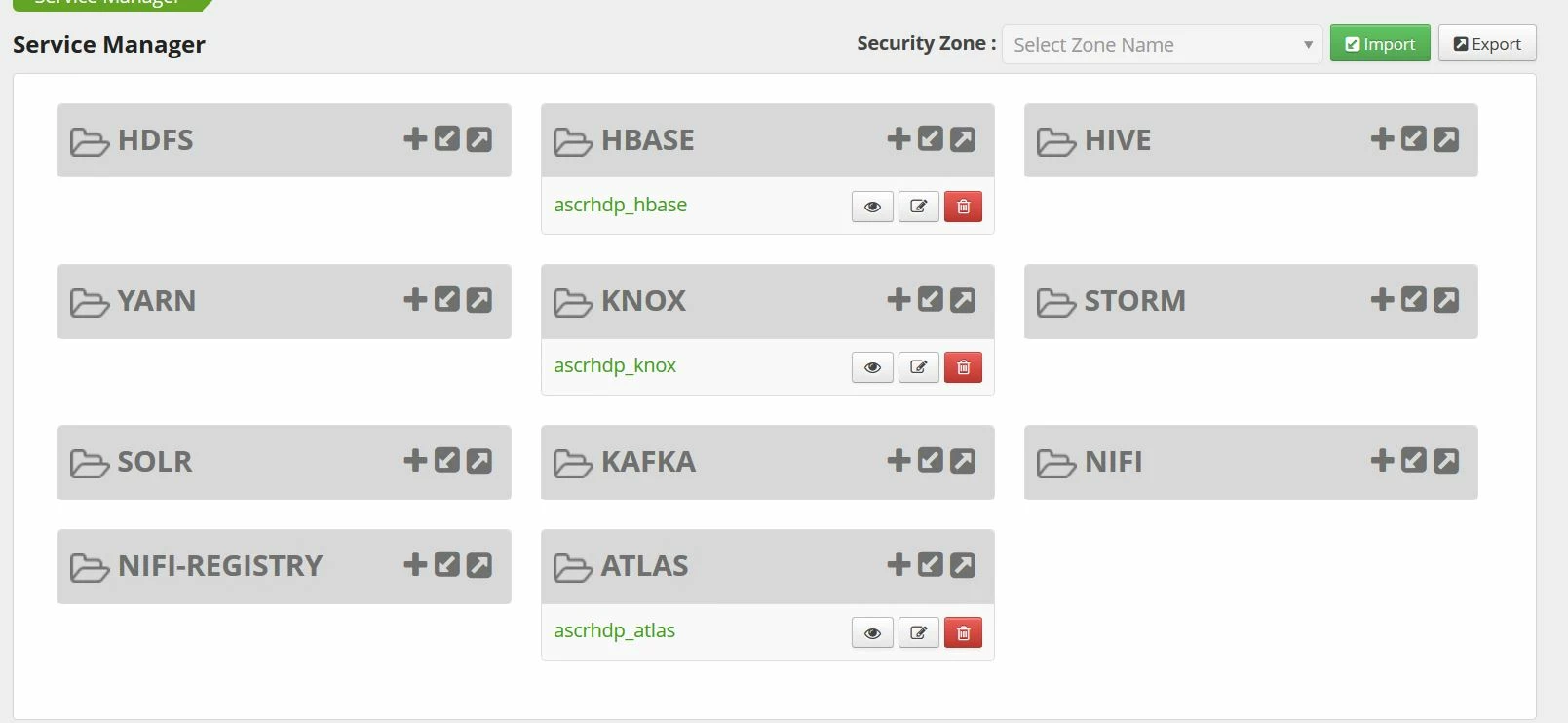

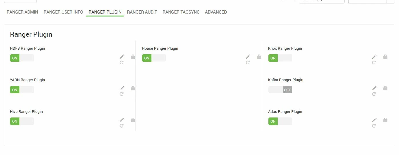

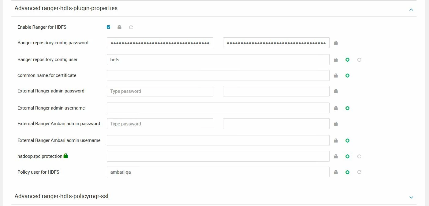

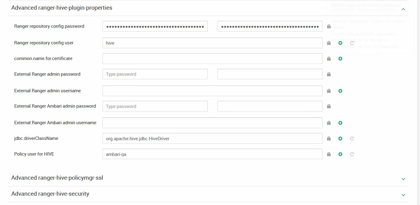

I am trying to use Ranger for Authorization with Hive and HDFS. But somehow Ranger doesn't recognize Hive or HDFS. I don't see the default policies in Ranger for Hive and HDFS. I activated the Ranger Plugins for Hive and HDFS and checked the Advanced ranger-hive-plugin-properties and Advanced ranger-hdfs-plugin-properties. For me everything seems fine, but the services don't appear in Ranger. I also activated Ranger as authorization method for Hive. But that also didn't help
This is how my configuration looks:
Ranger Services:
Ranger Plugins:
What am I missing here? I would be happy about hints!

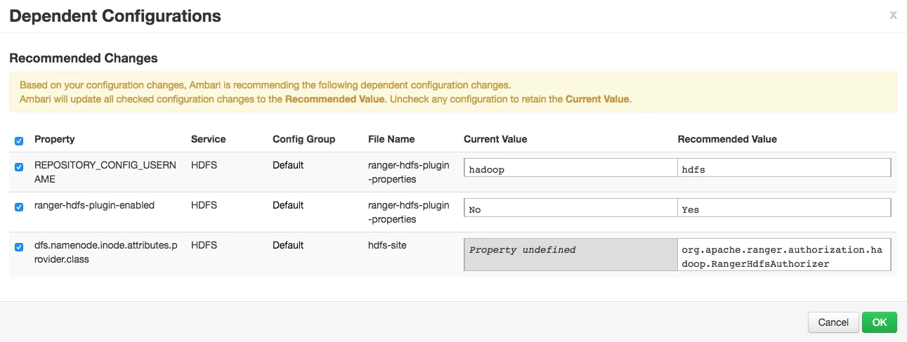

  1. Can you try disabling and enabling the plugin again ? While you enable the plugin it adds/modifies below properties -
    Can you check if those properties are set properly after you enable ranger plugin for hdfs again?

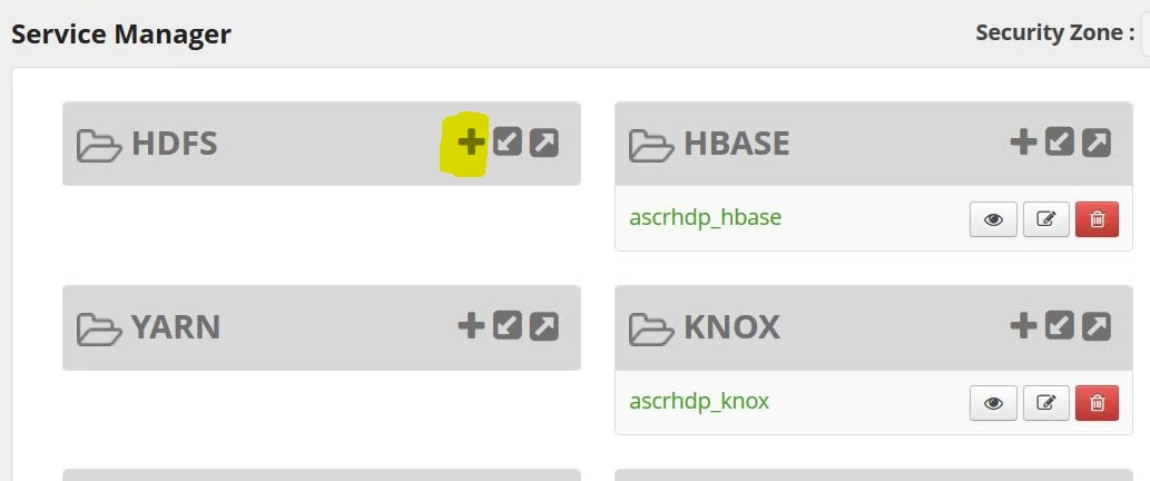

  3. If still you are not able to see the repository in Ranger UI then you can click on add symbol as shown below to add repository manually -
    You can specify details of namenode and other and "test connection"
  4. Monitor the logs of ranger and namenode while you test connection. If connection fails you can see errors in logs.

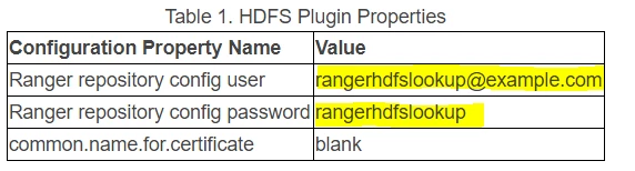

You will need to create a Kerberos principal and the below values are different with your screenshot
 Values to Change
  •  Ranger service config user
  • Ranger service config password

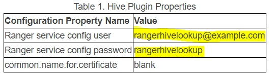

For hive
The above steps are for HDP 3.1.4
