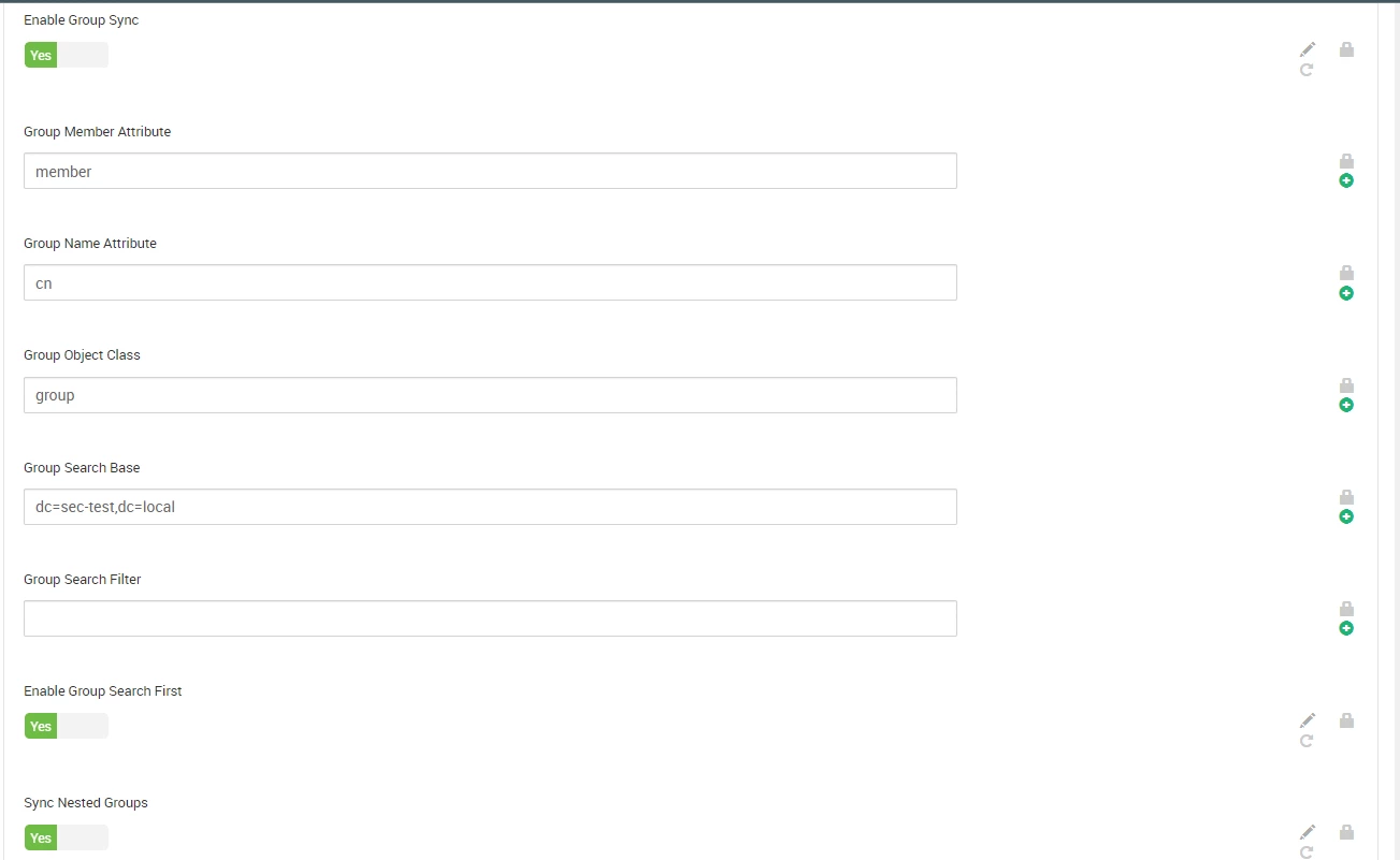

Configured new test instance of Ranger
Settings
Binded user has domain admin rights.

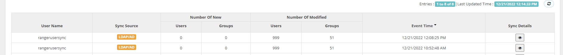

Now synced only 999 users of 1650 existed in AD
What problem can be?

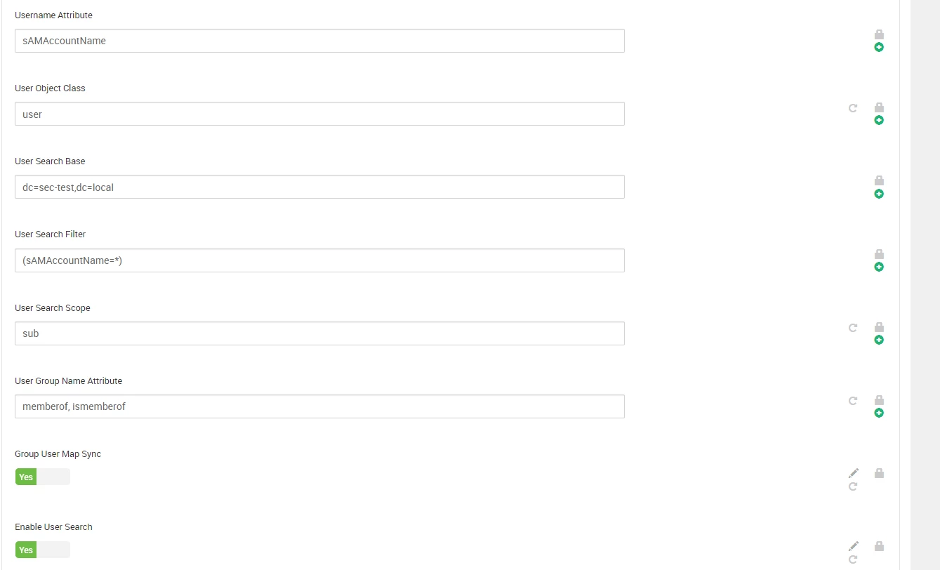

Hi @bananaman , Can you please refer the below docs and enable the user search first and see if it helps.
https://docs.cloudera.com/cdp-private-cloud-base/7.1.3/security-ranger-authentication-unix-ldap-ad/topics/security-ranger-authentication-ad-integration-usersync.html
Also please try to run ldapsearch to see if it is able to list all the users.

Hi!
As you can see, user search is already enabled, ldapsearch returns 999 results of 1650 in Active Directory....

@bananaman  This happens when the search filter is not correct. In your case its. Try to change search filter.
sAMAccountName=*
If this does not help try to add the usersync logs to check further.
