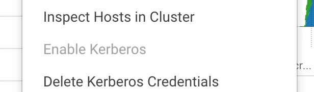

I am trying to totally remove Kerberos and re-enable it. I have followed all the rollback steps as described in several posts:
https://community.cloudera.com/t5/Cloudera-Manager-Installation/Disabling-Kerberos/td-p/19654
https://stackoverflow.com/questions/29744821/how-to-disable-hadoop-kerberos
http://bigdata-tips.blogspot.com/2017/03/how-to-disable-kerberos-in-cloudera-cdh.html
I seems that kerberos is indeed disabled BUT I cannot get the Enable Kerberos button back:
What should I do to re-enable it?

The problem was on StreamSets, where I had not disabled Kerberos. Now the Enable Kerberos option is active again.
