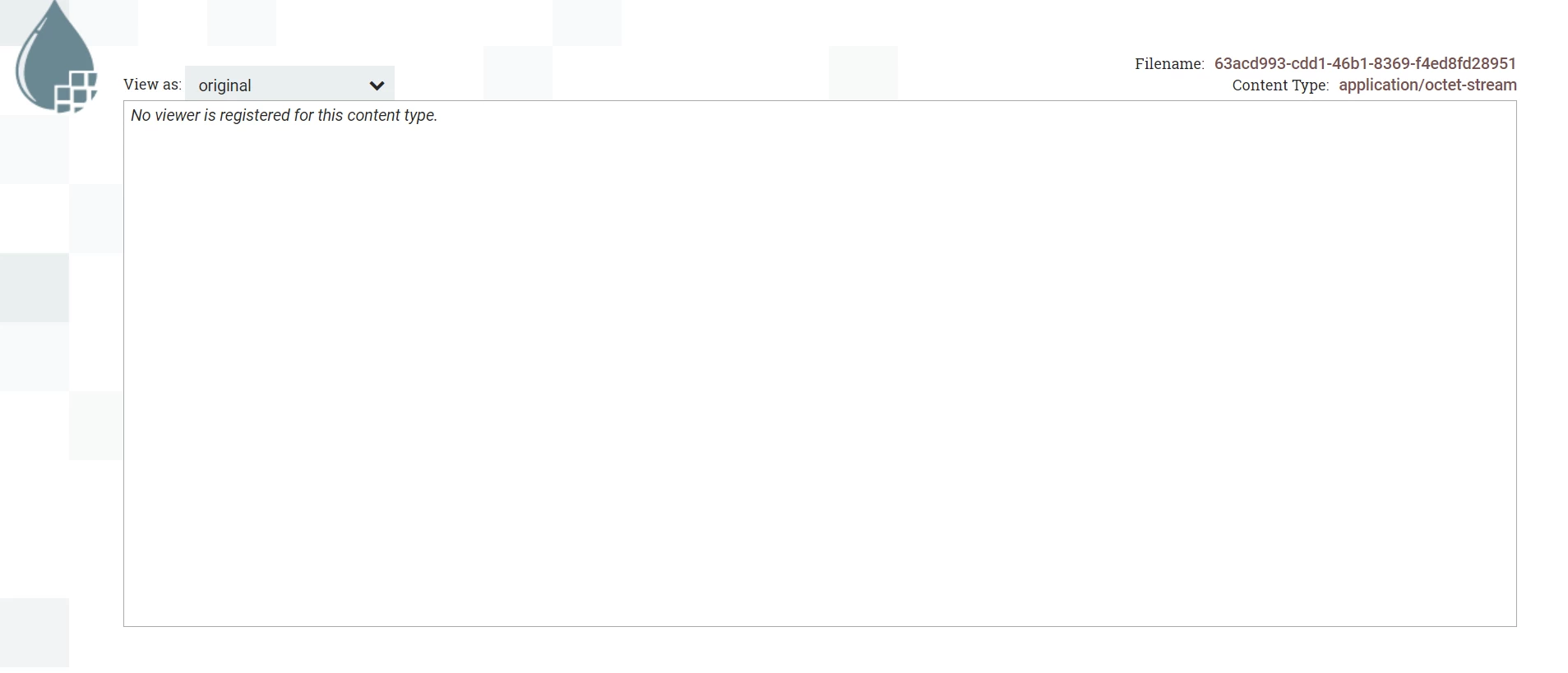

I want to be able to read binary Avro data from Kafka using ConsumeKafka Processor. And I am able to do that, but the content type of the file is in "application/octet-stream". Not able to view it as well, it says "No viewer is registered for this content type". I am not even able to convert this avro data to json, since the content type is octet-stream. But when i use "kafka-avro-console-consumer" on the console the data is in json. How to get this json data into Nifi?

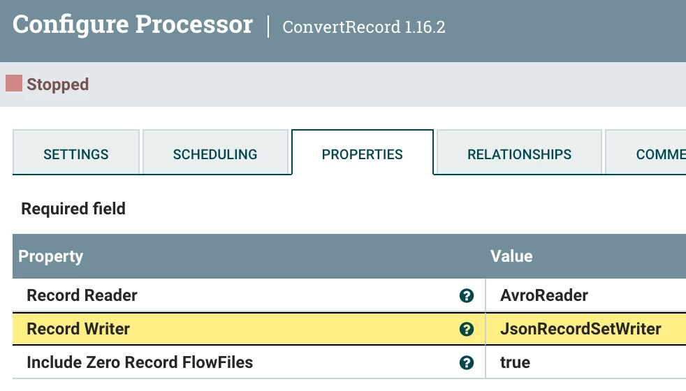

@syntax_ ,
I believe you have a schema that you can use to parse your Avro data, right?
Instead of using ConsumeKafka, use the ConsumeKafkaRecord processor. In that processor specify an Record Reader of type AvroReader and provide the correct schema so that the reader can properly deserialize your data.
If you want to convert the data for JSON, you can then specify a JsonRecordSetWriter as the Record Writer for that processor, so that the output flowfiles will be in that format and you'll be able to inspect the content of the queues.

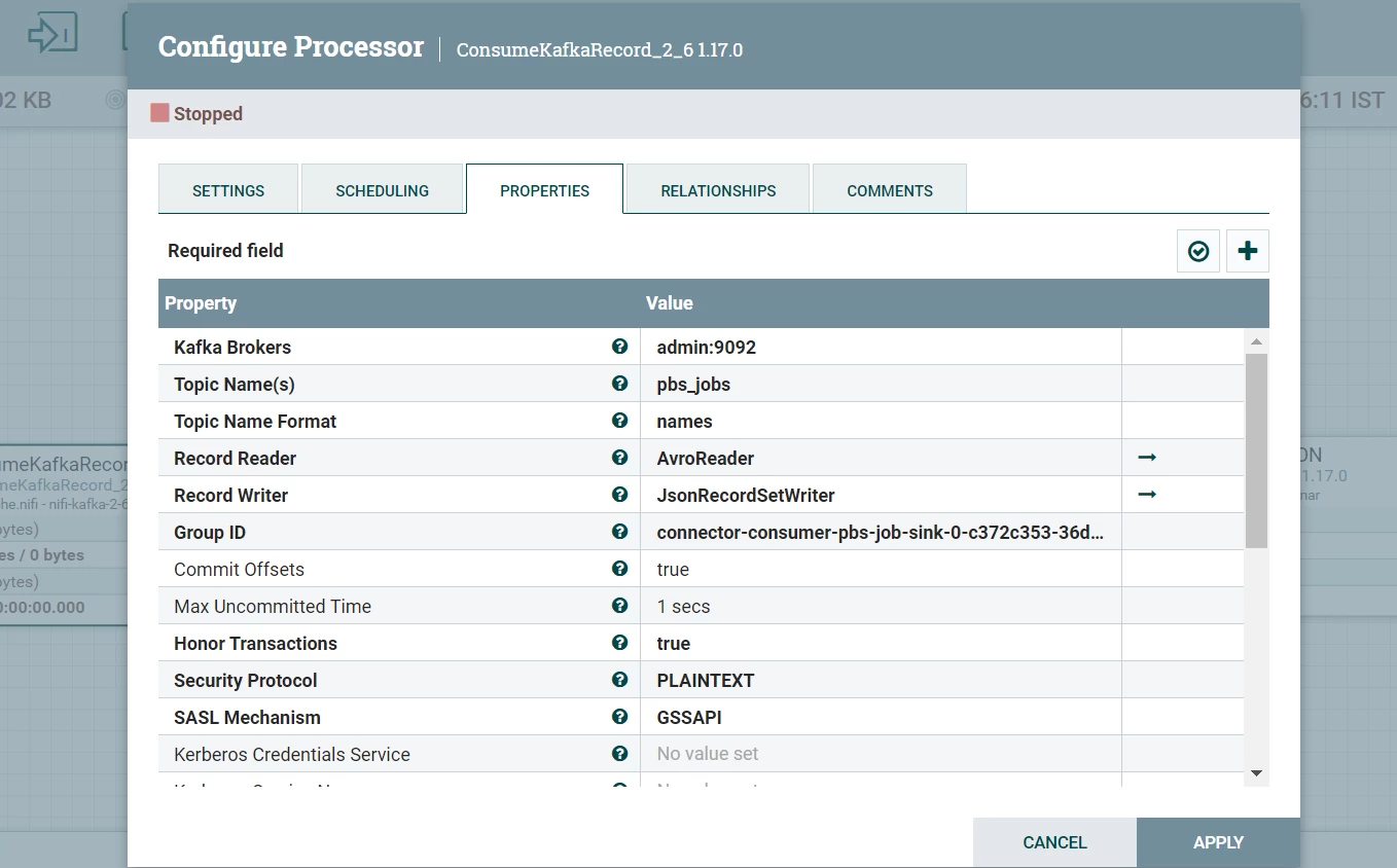

I used the ConsumeKafkaRecord processor as well. I gave RecordReader as Avro reader. But when I run it, it gives an error saying "invalidMagicException: Not an Avro data file". Is there something I am missing here?

But when I send this data to nifi using ConsumeKafkaRecord:
Getting this as output:

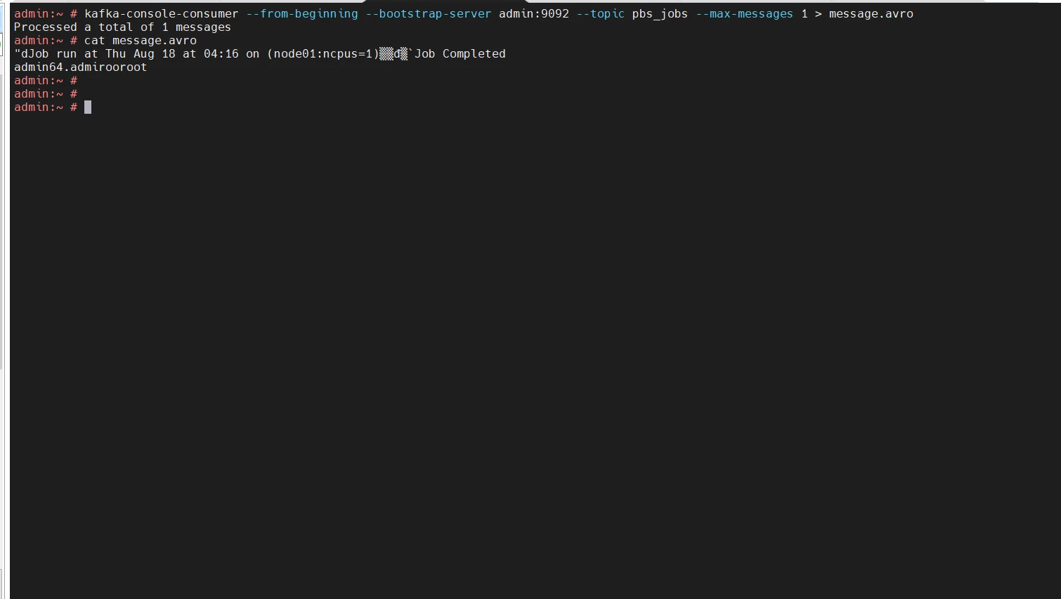

I actually wanted to have a look at the binary Avro data that is in Kafka, not the deserialized content.
Something like this:
kafka-console-consumer --from-beginning --bootstrap-server admin:9092 --topic pbs_jobs --max-messages 1 > message.avro
Cheers,
André
Translate
-- Was your question answered? Please take some time to click on "Accept as Solution" below this post. If you find a reply useful, say thanks by clicking on the thumbs up button.
syntax_
syntax_Author
Silver ⭐️⭐️⭐️
Sep 2, 2022 6:47 AM UTC
Okay, this is the output.
It is in this format
"dJob run at Thu Aug 18 at 04:16 on (node01:ncpus=1)▒▒đ▒`Job Completed
admin64.admirooroot

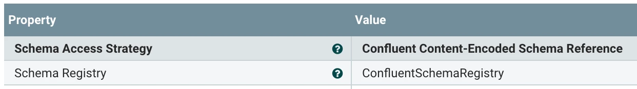

@syntax_ ,
It seems to me that your source Kafka is a Confluent Kafka cluster and the producer uses schema registry to source the schema from it. In this case, the KafkaAvroSerializer prepends 5 bytes to every message produced to indicate the id of the schema that was used (in you case, schema id 34). If you try to read this message as a pure Avro payload the deserialization will fail because those 5 bytes are not part of the Avro payload.
So, the best way to handle this in NiFi is to also use Schema Registry to deserialize Avro messages. With this, NiFi will get the schema ID from the message 5-byte prefix, use that ID to retrieve the correct schema from Schema Registry and then correctly deserialize the Avro payload.
Considering that my guess is correct and you're using a Confluent Schema Registry, you should create a new ConfluentSchemaRegistry controller service and configure it with the details of your Schema Registry. Once this is done, edit the configuration of the Avro Reader controller service and set the following:
After you do this, your flow should be able to correctly process the messages that you're reading from Kafka.

syntax_
syntax_Author
Silver ⭐️⭐️⭐️
Sep 5, 2022 6:09 AM UTC
Yes, it works. Thank you so much!!
