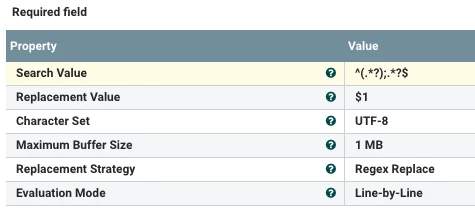

I would recommend using capture groups in your regex. Here is an example that will work for your example:
I then replace with just the value from capture group 1

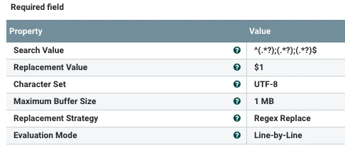

Here is another example that is more generic (can have many ";<somevalue>" after first one:
Here again I use capture group 1 as my replacement value.

@Bala S

Thanks @Matt Clarke. I went with the option 2 and it worked. Thanks again for the quick reply.
