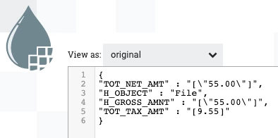

I have JSON input for Nifi flow with some special characters. Could someone help me with how to remove special characters following payload? we would need only value with array and double-quotes.
input json: -
"TOT_NET_AMT" : "[\"55.00\"]",
"H_OBJECT" : "File",
"H_GROSS_AMNT" : "[\"55.00\"]",
"TOT_TAX_AMT" : "[9.55]"

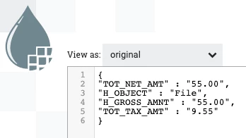

Expect Result :
"TOT_NET_AMT" : "55.00",
"H_GROSS_AMNT" : "55.00",
"TOT_TAX_AMT" : "9.55"

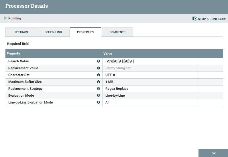

You can use a ReplaceText processor to remove these special characters from your json.
Using your example, I could produce yoru desired output using the following java regular expression:
(\\")|[\Q[\E]|[\Q]\E]
Source:
My ReplaceText processor was configured as follows:
result:
