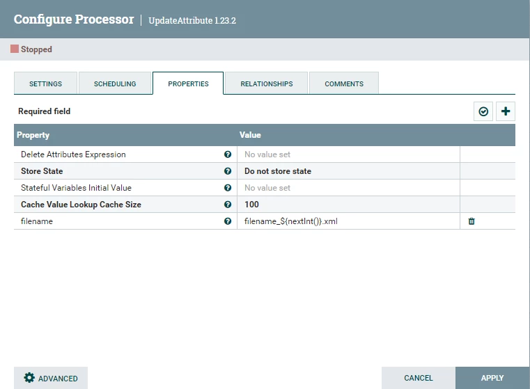

The first method i found is using nextInt():

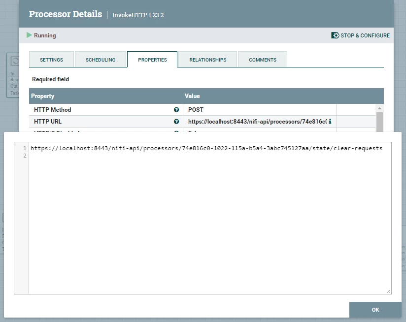

Maybe you could reset the state via NiFi-REST-API at beginning of your flow or separately on a schedule cron every morning
Could be:
POST "https://[ip:port]/nifi-api/processors/${processor-id}/state/clear-requests"
This is the request which NiFi itself uses when you go to the processor in the UI and choose the menu-option "view state" -> "clear state".

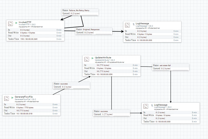

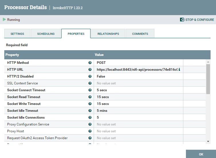

From your reply, I have added in NiFi InvokeHTTP processor which will automatically help to reset my seq no. counter every morning.  I am using the second method above which using seq no. which store state locally.
I have set the HTTP Method to POST and HTTP URL to https://[ip:port]/nifi-api/processors/${processor-id}/state/clear-requests

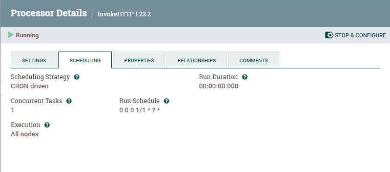

I have scheduled the NiFi InvokeHTTP Processor to run every morning 00:00 using CRON driven Scheduling Strategy

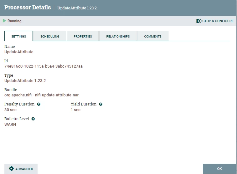

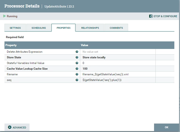

Below image are the NiFi UpdateAttribute Processor which show the processor ID that i used inside my HTTP URL
Just to check did i did it correctly as what you mention in your reply ?
I tried to change my computer time to 11:55 pm and let it run to 00:00 the next day, but it does not invokeHTTP POST request once it reach 00:00. I might have made some mistake somewhere.
appreciate if you could advise me with example and explanation. Thanks a lot.
