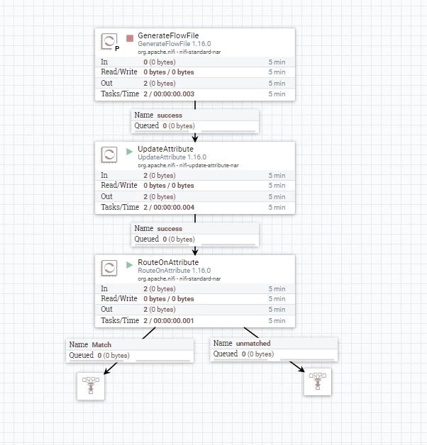

Here is how the flow looks like

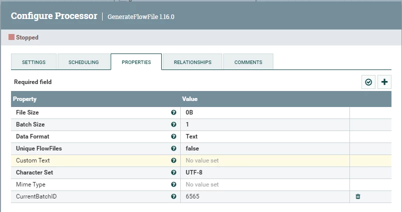

GenerateFlowFile:

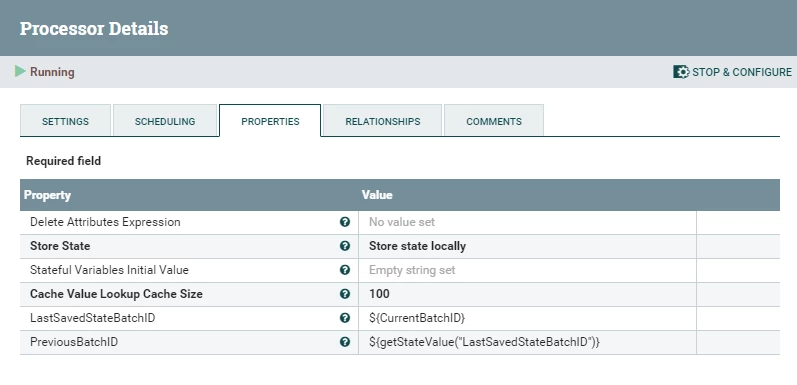

UpdateAttribute:

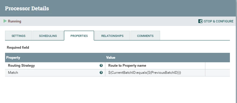

RouteOnAttribute:

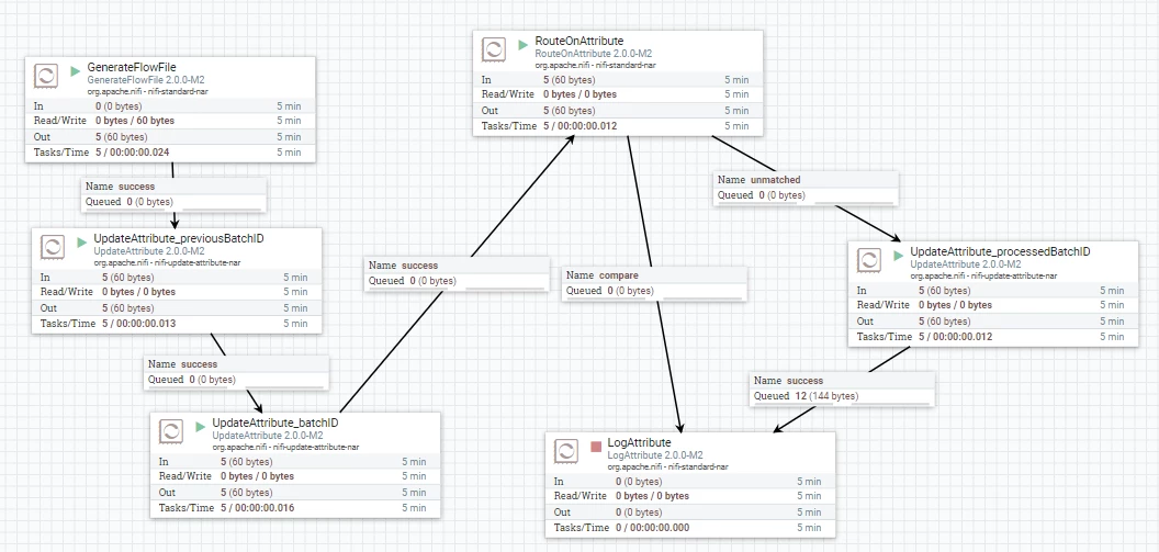

Below is the POC created for implementing this requirement on my Windows laptop.

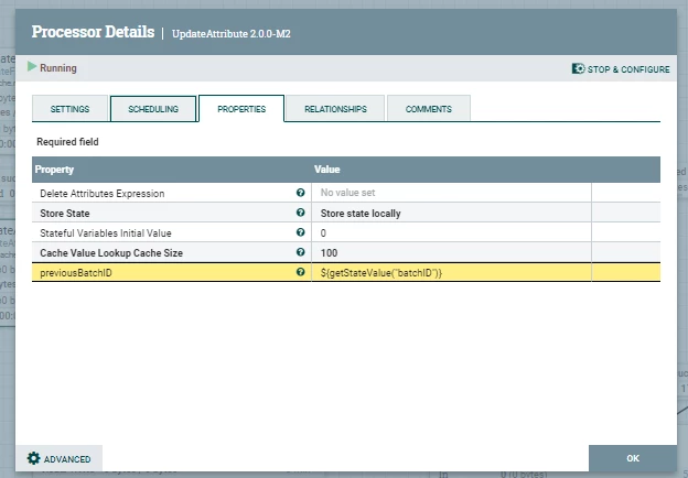

UpdateAttribute_previousBatchID - The first Update attribute is used to record the batchID from the previous run
previousBatchID - ${getStateValue("batchID")}

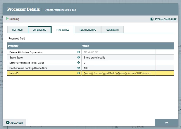

UpdateAttribute_batchID - The second update attribute is used to generate the new batchID .
batchID - ${now():format('yyyyMMdd')}${now():format("HH"):toNumber():multiply(60):plus(${now():format('mm'):toNumber()}):divide(15)}

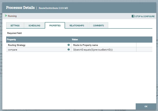

RouteOnAttribute - Compare the batchId with PreviousBatchID.

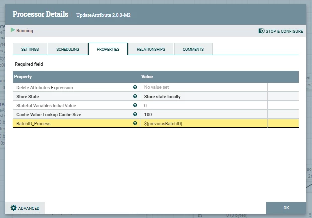

UpdateAttribute_processedBatchID - The last update attribute after the RouteOnAttribute is used to get the previous BatchID
BatchID_Process - ${previousBatchID}

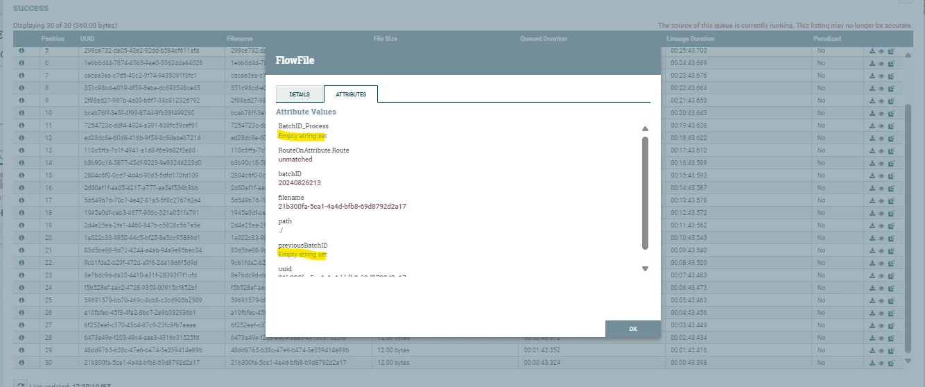

As u can see below, the variables have entry strings in the last step for both the variables highlighted in yellow.
Please help to guide me with the right way to use the update attribute to achieve my requirement. Thanks!

Hi @NagendraKumar ,
I think you misunderstood how the Stateful UpdateAtrribute works which is OK since a lot of people would think this way too if you have not used before which happened to me as well  :).
Basically when you make an UpdateAttribute Stateful by setting the Store State Property, as the value says it will "Store state locally" meaning you only can access the previous state of a given attribute within the processor itself. As I can see,  you are trying to store the Batch Id in the Second Update Attribute and then access it from the first UpdateAttribute and that is why you are getting empty string because it doesnt exist there.  You dont need two UpdateAttributes to manage that and one should do the job.
Lets assume we have the following flow which consist of the following processors:
1- GenerateFlowFile: This will simulate setting new BatchId attribute by adding dynamic property BatchID and set it to some value.
2- UpdateAttribute: This will be a stateful and it will have two attributes: One to get the last saved BatchId value and another to set the last saved batch ID to the Current.
3- RouteOnAttribute: This is basically where you compare previous to current and route accordingly.
Here is the config for each processor:

UpdateAttribute:
RouteOnAttribute:
Basically, if you run once for the first time you will get the flowfile routed to the unmatched relationship of the RouteOnAttribute (since no previous value was set), however if you run it again without changing anything the result will be routed to the Match relationship since the previous saved value will equal the new one. Change the value in the GenerateFlowFile and it will go to unmatched and so on.
I know you probably wondering how this works since in the UpdateAttribute Im referencing the LastSavedStateBatchID while at the same time its being set to the CurrentBatchID?! which comes first ? well the answer is simple: If you refer to the stateful documentation   where its talking about you will find the following line: " If stateful properties reference other stateful properties then the value for the other stateful properties will be an iteration behind" . Which means PreviousBatchID will be set to the lastSavedStateBatchID before resetting the later to the current . if that makes any sense 🙂
