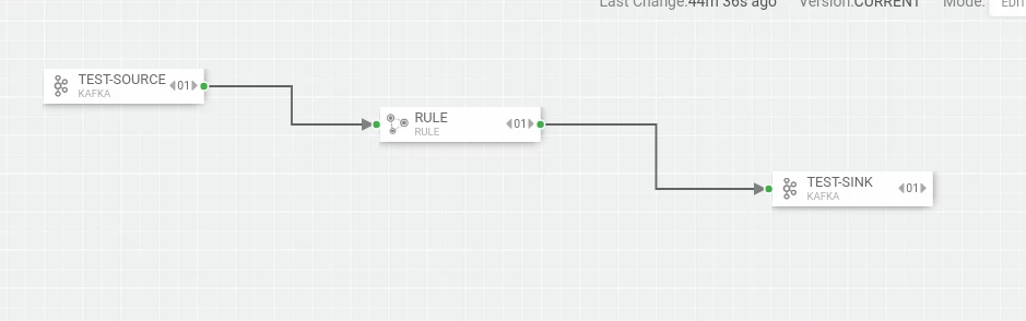

I am running a basic Kafka source and sink with one rule in between
both have different schemas and i am using a console consumer to read out the sink .
While I am adding the test data in the test case it throws the following exception :-
Caused by: com.hortonworks.registries.storage.exception.StorageException: java.lang.NoSuchMethodException: com.hortonworks.streamline.streams.catalog.TopologyTestRunCaseSource.setOccurrence(javalang.Long) at com.hortonworks.registries.storage.catalog.AbstractStorable.fromMap(AbstractStorable.java:93) atcom.hortonworks.registries.storage.impl.jdbc.provider.sql.factory.AbstractQueryExecutor$QueryExecution.getStorablesFromResultSet(AbstractQueryExecutor.java:480) at com.hortonworks.registries.storage.impl.jdbc.provider.sql.factory.AbstractQueryExecutor$QueryExecution.executeQuery(AbstractQueryExecutor.java:363) at com.hortonworks.registries.storage.impl.jdbc.provider.sql.factory.AbstractQueryExecutor.executeQuery(AbstractQueryExecutor.java:344) at com.hortonworks.registries.storage.impl.jdbc.provider.postgresql.factory.PostgresqlExecutor.select(PostgresqlExecutor.java:121) at com.hortonworks.registries.storage.impl.jdbc.JdbcStorageManager.find(JdbcStorageManager.java:128) ... 61 common frames omittedCaused by: java.lang.NoSuchMethodException: com.hortonworks.streamline.streams.catalog.TopologyTestRunCaseSource.setOccurrence(java.lang.Long)
Also why I am not being able to delete the test cases ???(it throws an exception in this case as well !!!!!)
ERROR [2019-01-22 14:21:58.894] [dw-288 - DELETE /api/v1/catalog/topologies/2/testcases/7] c.h.s.s.s.TopologyTestRunResource - Got exception: [StorageException] / message [com.hortonworks.registries.storage.exception.StorageException: java.lang.NoSuchMethodException: com.hortonworks.streamline.streams.catalog.TopologyTestRunCaseSource.setOccurrence(java.lang.Long)] / related resource location: [com.hortonworks.streamline.streams.service.TopologyTestRunResource.removeTestRunCase](TopologyTestRunResource.java:548)
com.hortonworks.registries.storage.exception.StorageException: com.hortonworks.registries.storage.exception.StorageException: java.lang.NoSuchMethodException: com.hortonworks.streamline.streams.catalog.TopologyTestRunCaseSource.setOccurrence(java.lang.Long)
Is there something wrong with my database configuration ???
I am using postgresql 9.5 which came with Ambari (I used the embedded DB option and created the registry and streamline DBs in the same)
Any help is much appreciated !!!!

I changed the column type from bigint to integer for the topology_test_run_case_source.occurence and it was resolved and the test cases also started to run !!!
