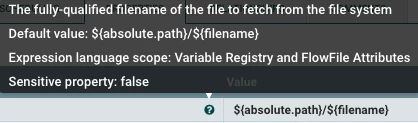

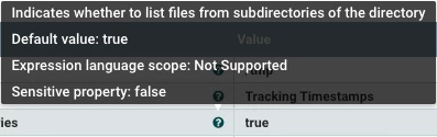

Unless a component property has an explicit tool tip that tells you it support NEL, then it does not.  For NiFi processor components, you will find that only some processor specific properties within the "PROPERTIES" tab support NEL.  This is not only available through property tooltips, but also in the processors documentation.
Examples:
Even when NEL is supported there is a scope.  It may support FlowFile attributes, Variable Registry (going away in NiFi 2.x releases), or both.
