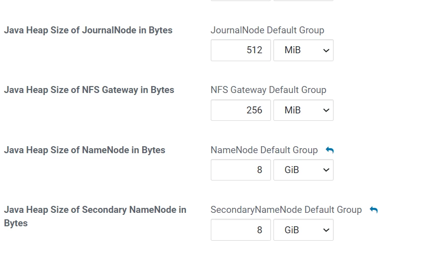

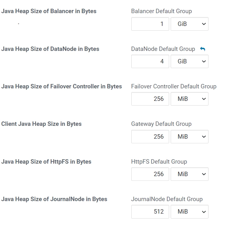

My cluster Java Heap memory values kindly please check this values.
 Raj@77  Your Service Monitor is running out of Java Heap hence the issue:
where can i found exact location of service monitor using java heap memory value. is there any specific requirement for service monitor Java Heap value.
Is there any issue.
 /etc/default/cloudera-scm-server
Java Options.
# Default value sets Java maximum heap size to 2GB, and Java maximum permanent
# generation size to 256MB.
export CMF_JAVA_OPTS="-Xmx2G -XX:MaxPermSize=256m -XX:+HeapDumpOnOutOfMemoryError -XX:HeapDumpPath=/tmp"
 Heap size: https://docs.cloudera.com/cloudera-manager/7.2.1/managing-clusters/topics/cm-configuring-memory-allo...    Link is not working
